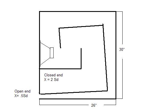

Hi, I'm new to this forum but a long time fan of diy speakers. I failed algebra in highschool so I find alot of the math daunting. I have recently purchased a Jensen TS1212 Sub which cost next to nothing and happened to have the right characteristics for an existing ported enclosure I have been using. It performs reasonably well considering the investment, however, I have been tinkering with the idea to build a 1/4 wave TL enclosure.
My reading so far has lead me to choose a Tapered Pipe. I downloaded the Free version of MathCad and plugged in my driver specs and pipe length and taper that I deduced from the available space I have. I have arrived at a 140" pipe with a closed end cross section of 2X driver area (ds) and an open end CS of .5 ds. This gives a fairly nice SPL curve in the BW I intend to use. (20-80hz). Impedence curves look good to and port output remains in phase with driver output down to <15hz.
My problem is I haven't yet figured out how to plug my folded horn sections into the program so I'm not certain how the 7 folds will effect performance. My space dictates how many folds I put in.
My question is, will excessive folding and small cross sections and taper ratio result in worse performance than a shorter pipe with larger cross section and higher taper ratio.
Any imput is welcome, however, keep the math simple if possible.
Well, with no specs I can't sim it, but FWIW, a steeper taper will allow a much shorter pipe, though net Vb won't change. Also, as the reverse taper increases, the driver moves toward the closed end.
Anyway, folding a pipe intended for sub duty relieves you of worrying about damping any pipe BW beyond the XO BW, so if using an 80Hz/4th order XO, then -24dB = 160Hz, though some folks consider -12dB as adequate, or 160*0.707 = ~113Hz. To keep standing wave reflections from coming back through the driver or setting up standing waves between bends, the distance from the driver to the first bend and between each succeeding bend needs to be < 1/3WL of 160Hz, or ~13560"/pi/160 = ~27" (113Hz = ~38") until the pathlength is 1WL long. After this point is reached, the bends can be much farther apart since 1WL of 160Hz = ~pi*WL of ~51Hz (~36Hz), where the process repeats itself.
Where most folks screw up is in designing the bends themselves. If the taper doesn't continue around the bend, or at least remain constant, out of BW standing waves can reflect back through the driver as if it is in a closed pipe, i.e. at 27" there would be standing waves beginning at ~6780"/27" = ~251Hz (~178Hz), then ~502Hz (357Hz), etc..

Design details
Hi guys,
Sorry Timn8ter, the driver is a Jensen KS212 (I had posted from work and memory usually doesn't serve me well ;) ). The FS is 26.13 Hz Vas = 4.231 Ft3, Qts = .379, Qms = 7.37, Qes = .399, Sd = 74.41"2, Lvc@1000hz = 1.009 mH, Re = 3.55 Ohm
Gm, the XO I'm using is, I believe 24db/octave, but I can't know for certain because I purchased it through a local surplus store without specs. Please forgive my ignorance GM, but I'm not certain I follow you on the standing wave problems. Are you suggesting that to suppress standing waves of 113Hz, the mimimum pipe length between driver and first bend has to be 38" ? How then to build any folded configuration with a cabinet size of less than 38"? :confused: Below is a diagram I just did in paint. It's by no means to scale. I tried to scan my sketch in but my scanner has a love/hate relationship with my computer and today they aren't talking! ;) :mad: Let me know if I'm way out in left field or not.

I've read the article and agree with the rationale. As noted in previous posts above, this may be more critical in full range TL design than in SW designs. Perhaps I'm wrong, but I haven't come accross any literature that indicates otherwise. A single fold SW would necessitate minimum cabinet lengths of approximatel 6 ft. Not an option for most real world applications! ;)

The way I interpret it is he's proving my point WRT the detrimental effect on performance a simple diagonal divider board has in a rectangular cab due to not maintaining the flare rate through the bend(s). ;)

But I would want a sub to reproduce big pipes. As stated, I haven't yet built my sub, so I have no empirical evidence yet. However, my thinking has always centred around the TL opening allowing the exit of phase corrected backwaves, such that a forward facing "port" would be need to be 180deg from the backwave of the driver. So whatever FR is coming from the front of the driver needs to be duplicated at the port. In an 2-way design, the LF driver may be handling BW up to 3kHz. That means the port should also. Ideally, the stuff should not attenuate the harmonics of a wave since the driver also puts those harmonics out the front. But the interior of the enclosure should prevent internal reflections as these will interact and create acoustic mush which will eventually show up at the port.
What I haven't been able to surmise yet is whether putting the driver right at or near a fold will cause problems with the air being "pumped" in two directions. Like Astro-Muse, every cabinet I've designed so far places the driver at a bend and it worries me. I've tried to move it but doing so forces the design away from MJK's alignment table parameters.

I'm sorry but you appear to have a fundamental misunderstanding
of transmission lines and the way the 1/4 wavelength works, and
the consequences of the 1/3 wavelength, 1/2 wavelength and 1/1
wavelength which are alternatively in and out of phase with the driver.
Replication of the front output of the driver is simply not possible.
