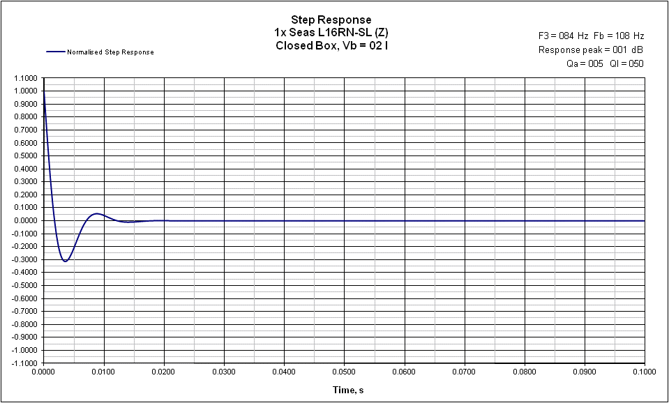

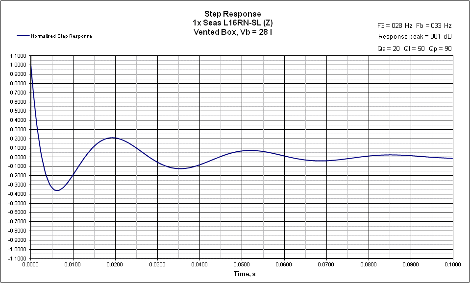

In terms of your woofer choice, I think you're going to have to choose between transient response and sensitivity unless someone who has heard both of them can chime in with a favorite.
Personally, I would have a preference for the better transient response of a sealed woofer to match with that Audax mid. Sealed and using Zaph's measured data ( Zaph|Audio), the Seas L16RN-SL will hit an f3 of 66Hz in 8L with Qtc of .711 and heavy fill. Sealed, the Audax HM170CO only hits 93Hz in 7.6L, Qtc of .707 and minimal fill. To go lower the Audax must be ported, f3 of 63Hz in 10L tuned to 60Hz but then the transient response isn't as good. The Seas also has very low 3rd and 5th harmonic distortion between 80 and 700Hz, (see below) altho if the Audax data is to be believed, the HM170 also shows outstanding cone control via it's CSD.
The big difference is that with the Seas' 84dB sensitivity, 2 of them in parallel gets you to 90dB and then minus say 4dB for BSC, leaves you with 86dB sensitivity. That means you have to pad down the mid (93dB) by about 7dB. That may or may not affect the overall sound depending on who you are talking to, but it'll certainly mean that your amp will have to do more work than with the Audax woofers who'll end up at about 92dB sensitivity after the same calculations. I'm assuming btw that your amp will be happy with the 4 ohm load of 2 woofers in parallel. If impedance is a factor, it looks like the Audax is the one with the slightly higher impedance minimums.
Notice however that your tweeter choice won't work with the Audax woofers since it's only 90dB in sensitivity. (You don't really want to be padding down your woofers) No great loss since I think you could do better for less money too. I would possibly think of a planar (B&G Neo3) or ribbon (maybe a Fountek) to match with your mid or look at Zaph|Audio again for more choices. Directivity starts to change at 2000Hz with that mid so I'd be looking for a tweeter that will be happy crossed at 3000Hz. But you'll need to decide on the woofers first.
Since you're looking at a bookshelf speaker I would think that box size might be a consideration but the enclosure sizes of the Seas and Audax are pretty close so that might not be a factor. Sealed in 8L with an f3 in the 60's is already pretty darn good. I guess if anything, you can push the Seas into a smaller sealed box than you can the Audax into a smaller vented box if you really had to.
Oh and in terms of max SPL and xmax, both are again about similar as long as they are both crossed to a sub around 80Hz.
Hope that helps.
Hope that helps.

L16RNX is designed more for a ported enclosure. L16RN-SL is designed more for sealed or ported. Personally, I like to kill the backwave as much as possible so it doesn't return back out thru the cone so I prefer to heavily stuff the cabinet. Density of stuffing will affect the f3 tho. Here are some numbers, but you should download a box sim program if you want to learn more (UniBox - Unified Box Model for Loudspeaker Design if have Excel, WinISD if you don't - LinearTeam ).
RNX sealed, light stuffing:
Qtc=.707
f3=78Hz
Vol=5.4L
RNX sealed, heavy stuffing:
Qtc=.707
f3=88Hz
Vol=3.3L
RN-SL sealed, heavy stuffing:
Qtc=.707
f3=67Hz
Vol=8.1L
RNX ported:
f3=41Hz
Vol=11L
RN-SL ported:
f3=28Hz
Vol=28L
In terms of sound quality from a layman's terms, what would the better transient response translate to, and is sealed that much better?
In layman's terms, first understand that a transient is the abrupt starting and stopping of a sound and it happens all over the place in music and movies etc. So a better transient response means cleaner, tighter and more detailed. It means less background noise. More controlled. It means the cone does a better job of starting and stopping when it's supposed to instead of continuing to move when the signal stops and of course, motion=sound.
Would everyone agree that it's noticeably better? Probably not, but it's my preference which is all I'm relating here.
Let me put it another way. The reason to go ported is for the added low frequency it provides. When you are using a sub, that can become a little redundant. Besides, the sealed box requires less volume and many people find the sealed LF roll off of 12dB/octave to blend better with the sub than the 24dB/octave roll off a ported enclosure, altho this is going to vary with the actual f3 and the xo point to the sub.
Here's the idea in graphic terms. We can roughly equate the driver's step response with it's transient response. First up is the Audax HM100 which you are trying to match the woofer to. Then follows the Seas L16RN-SL sealed with Qtc=.707 and then Qtc=1.25. Last is the RN-SL ported in 28L.
