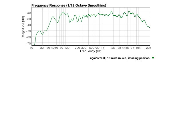

Here is my in-room frequency response for the W5-1611 double bass reflex, just posted to show the bass extension. Keep in mind that in this configuration, a 5" driver like this will only give you the impression of deep bass. I expect a TL or a horn, which their greater control over the driver, to perform somewhat better in this regard.
After playing my W5-1611s for years in a flat-five inspired DBR box, with which I did manage to achieve ~40hz extension]

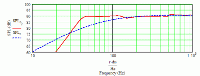

‘Best’ is a ‘moving target’ dependent on many variables, but a simple tower floor-standing vented alignment [aka MLTL] seems a good choice:
52” H
50”^2 WxD
driver down 15.25”
vent down 41.625”
vent diameter 2”
vent length 0.75”
All dims i.d. and approximate. Suggest lining one side, top and back with 1” acoustic fiberglass or similar or stuff with polyfil or similar just enough to keep it from sounding hollow. Mass loading relatively lightweight cabs is a good plan, so recommend adding weight to the top. Due to being top heavy [even if there’s no added top weight], best to provide a massive base or at least a large ‘footprint’ leg system to compensate.
If made from no-void 0.75” thick material, no bracing is required with such a small, low linear output driver.
It may need some baffle step compensation [BSC] EQ to sound tonally balanced in room: General Speaker Related Articles

You’re welcome!
50"^2 = 50^0.5 = ~7.07" W x ~7.07" D, but you can change either or both just so long as they sum to ~50"^2.
Using the Golden, or an acoustic ratio is normally a good plan to average out its internal eigenmodes [standing waves] to keep damping to a minimum, but again, this cab is small enough that damping will be sufficient regardless of its WxD dimensions.

GM, can you fold/taper that MLTL and get comparable results?
Sure, though tapered [TQWT] would require a redesign. If you just want tapered to make the internal baffle/brace be offset, then make the closed end ~34.66”^2 and the vent end ~75”^2 or some mean value between the two.
This theoretically yields a slightly more efficient vent gain, so you might want to try a 1” or longer vent.
