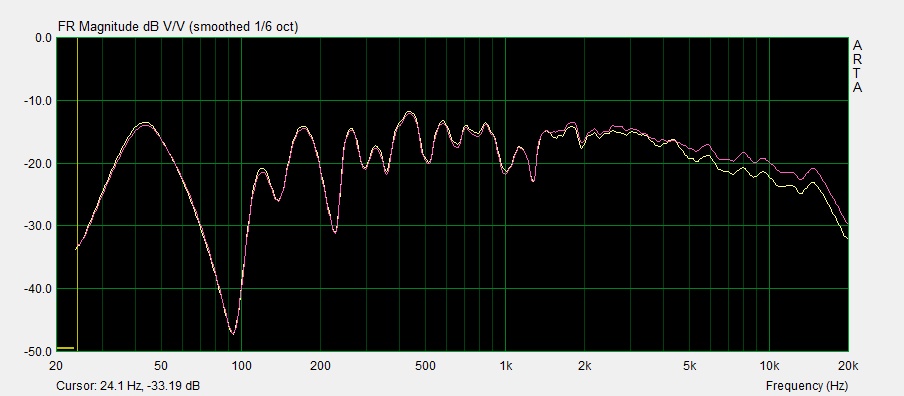

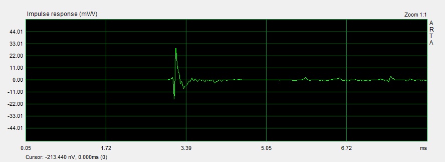

Lost in measurements
When measuring frontal output (same room mic placed ~60cm from middle of speaker centers, gating 10ms) several measured flaws became obvoious:
- There is a serious response fluctuation of +-5dB at 300-500 Hz with whole midbass range slightly elevated (somehow overall pleasant effect at least in given room dimensions);
- There is a 4dB dip at 1-1.5kHz;
- There is a 2dB wide elevation at 1.5-3kHz;
- There is a gradual rolloff (~3dB/oct) from 3kHz to 14kHz and steeper further on with smoothly narrowing dispersion (second measurement was taken about 30 degrees of-axis).
So measured frontal response unevenness was up to at least 6dB with most pronounced being dip at 1-1.5kHz. It surely was blended with reflected signal due to close distance to walls, so what I was measuring was rather power response (loudspeaker direct + room), and also room modes coming into play with all associated interference plague. I didn't use dual gating for analysis so bass curve is very aproximate.
Things I did to overcome 1kHz dip:
- tried to extend HF driver frequency response below 1.5kHz with mods. It made 1kHz dip less pronounced, but as a result speaker somehow sounded less pleasant;
- tried putting WG on separate 40cm baffle to reduce the dip that way and hence also to reduce 2kHz peak from WG dimensions. It actually made overall sound even worse. Sound became less spacious, more lifeless and boring;
- tried putting HF speaker in same baffle without WG. Most annoying sound, all airiness was lost, become very forward and unbalanced;
- tried disconnecting rear HF speaker and replacing it with resistive equivalent. Killed some of the spaciousness. Sound became too forward instead of hanging somewhere around the loudspeaker. I was confused of what to do next and placed serious doubt on trusting my ears and brain and even taste for even frequency balance.
I was really confused for a time.

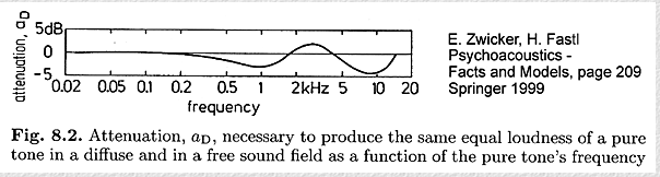

- First I mainly attributed initial setup pleasantness to correct phase or rather time alignment at crossover frequency which I tried to explain in different thread and received lots of good criticism and also food for thought but no remedy for my initial confusion. Adjusting frontal HF driver placement initially did gave me a great deal of satisfaction by easily finding best HF speaker time alignment in respect to LF within +-0.5cm spot. My ears were pleased, but as we saw measurements were far form ideal.
- I then came to thought that first-order passive filters could play some importance to better blending of sound between HF/LF drivers. First it seemed counter-intuitive as more 'blur' would be expected with wave source being smeared between two speakers that are at distance from each other. In my humble opinion if crossing of drivers is done as low as 1kHz brain suffers less from the "blur" as below 2kHz it quickly gets harder to locate the "dual" source and brain (probably!) just isn't looking for spatial cues it just "doesn't bother" and takes it "as is". Also close placement will help. A simple test to prove or deny this theory would be to blindly compare biamped 1-st and 4-th order active filters on the same speakers. Must be super easy with amps equipped with programmable DSP based filtering like Hypex.
- Some suggested that there is no difference for HF to be connected as dipole or bipole. My ear said the opposite. I measured that given waveguided HF speakers in bipole setup have brought weird acoustic artefacts like very pronounced side lobes showing up as high as at 4kHz. So yes, non-correletion is possible if crossing is done very high and very steep. But why do it? I found an answer at friends house - his listening room ir rather wide than long. Connecting his two pair of Mission bookshelf speakers as bipoles (one on top of the other, upper one turned facing rear wall). It increased pleasantness by giving more midrange reflections through some side lobing and from rear wall in otherwise very boring sounding room. So first conclusion towards optimal directivity here - the further the side walls are from speakers the more pleasant becomes wider dispersion towards sides. Bipole may be more preferable here compared to other types of speakers unless they have very hard toe-in angle (more than 45 degrees) which may not contribute to evenness of direct signal for obvious reasons. Still side lobes must follow particular pattern. More on this on final thoughts.

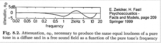

- While comparing HF dipole vs bipole dispersion I noticed that for the dipole there is a dispersion peak at 1kHz where it becomes almost omni-, while on other frequencies it gave very nice figure 8 dispersion pattern. It seemed that due to low-order passive filter tweeter phase at resonance bends at 45 degrees and back following its electric phase response to the sides. This happens as ridiculously low (but in my opinion necessary due aforementioned spatial cues ceasing below 1kHz) passive filter crossover frequency and series capacitor's impedance is preventing HF speaker resonance to be fully damped by low output impedance of the amplifier to be attenuated enough. SET amp having low damping factor probably made it even worse. Anyway I realized that I now have wide emphasis of 1kHz on side response while still having dip in frontal mix of measured direct and power response. And it still sounds quite right! I didn't know I cold love reflected 1kHz so much. If what I enjoy is more spatial cues from otherwise hard to locate frequency band, then perceptual brain feels probably not only unburdened but given delusional increased easiness of hearing. Like having a small hearing aid apparatus that increases resolution :) Field for more research here.
- Following suggestion by someone (was it SpeakerDave?) I bought and read book by Floyd Toole "Sound Reproduction: The Acoustics and Psycho-acoustics of Loudspeakers and Rooms" Being quite fresh (2008) it brought a lot of demystification and valuable info mostly based on reference scientific experiments, so I really recommend the book to anyone that likes to gain more knowledge. At first there was no clear answer for my "very small-room non-liner response pleasantness" case. After re-reading most enjoyable parts I found a couple of things that I missed initially:
-an experiment that shows that for majority of people most pleasant D/R ratio for in room listening is up to 1 which means that most people prefer blend of direct and reflected signal in 1:1 proportion provided that reflections are significantly delayed compared to direct signal. That may explain dipole/supercardioid associated phenomena and seemed to answer why dipole HF sound was so open and spacious;
- head-related transfer function (see HRTF) that was showing almost 20dB(!) perceived dip at 2kHz in anechoich chamber when listening is made at exactly same distance to stereo source speakers and similar 6-10dB dip when listening in moderately reflective environment so whole stereo listening is flawed, welcome multichannel or ambisonics (hey, but I have one speaker here, allright?);
- equal loudness diagrams that in critical and upper midrange almost resembled my measured response.. inverted! Here in section "Relevance to sound level measurement and noise measurement" we read "Although the*A-weighting*curve, in widespread use for*noise*measurement, is said to have been based on the 40-phon Fletcher–Munson curve, research in the 1960s demonstrated that determinations of equal-loudness made using pure tones are not directly relevant to our perception of noise.[3]*This is because the cochlea in our inner ear analyzes sounds in terms of spectral content, each "hair-cell" responding to a narrow band of frequencies known as a*critical band. The high-frequency bands are wider in absolute terms than the low frequency bands, and therefore "collect" proportionately more power from a noise source. However, when more than one critical band is stimulated, the outputs of the various bands are summed by the brain to produce an impression of loudness. For these reasons Equal-loudness curves derived using noise bands show an upwards tilt above 1*kHz and a downward tilt below 1*kHz [emphasis mine] when compared to the curves derived using pure tones." My cautious conclusion here is: when reflected signal meets direct signal in comparable proportions it should be considered as direct signal mixed with spatially added (though pleasant) noise. That means either correcting both direct and reflected or just reflected signal response (better as it doesn't ruin direct signal response). And it must be corrected differently at different reproduced lodness levels and different D/R ratios. To get exact correction pattern as afunction of room size more research on that topic coud be handy. Still I believe it can be put as simply as - attenuate high frequencies in tight rooms slightly above 1kHz and raise midbass under 1kHz. With midbass baffles wider than 40cm (baffle step frequency lowered) combined with controlled directivity horns or waveguides (smoothly narrowing dispersion as a function of frequency) it all may come out very natural. Which is very close to what I have measured in my tiny room at quiet to moderate listening levels.
- My other guess is that increasing playback volume in small room may require even more HF attenuation. My observation is that in very small room any speaker with increasing loudness becomes too harsh sooner, perhaps cone breakups and THD/IMD are only half of the problem other significant half being unpleasant tonal balance at midrange when given loudness and reflection power being close to equal to that of direct signal while recognition capability of resulting at such "noise" level declining. This thought actually came to me only now while writing. One way to test it would be to bring my speaker to a bigger room and listen to it there. If strong room size dependence to mid-high attenuation proves to be true, then room-size dependent loudness correction must be adopted as an industry standard, all contemporary multimedia file standards must be updated to include mandatory RMS (average loudness) tag to get correction applied in correct amount, and also some calibration towards the room size and speaker sensitivity must be done for each loudness corrector in room it is supposed to be operational. Not an easy task :)

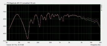

Are you measuring this in room described in #1
Yes. The gating applied to results is 10ms so room interaction with measurements must be significant.
But that's the whole point - if combined direct+reflected measurement follows desired power response according to suggested psycho-acoustical in-room correction, and my ear indeed finds it pleasant, then I see it as a good proof that that's how corrections should be done in general.

Without gating out the room reflections, you have no idea what the first-arrival (anechoic) response is, which makes crossover design impossible.
Set the left edge of the time window a bit to the left of the initial rise-time, and the right edge just before the first room reflection. That might only give you 3 mSec, which in turn only gives about 300~400 Hz frequency resolution, but that's good enough to see if the drivers are reasonably flat and if the crossover is flat.
The rule-of-thumb in crossover design is to use sharp enough slopes so that severe ripples are at least 15 to 20 dB below the average response level. Since this is a difficult requirement to meet without 24 dB/octave (or steeper) slopes, it's an incentive to use drivers that have smooth rolloff regions, at least for an octave above the intended crossover frequency.

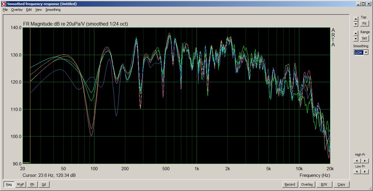

Right. Still I like to use 1-st order if possible for its excellent transient response and lack of ripple at crossover point. Unfortunately there aren't many midbass units around that doesn't exhibit sharp peaks on upper midrange. I was lucky to get these old paper units. Here is one of them measured alone with whizz cone still in place, then removed, and then improvised phase plug added. Green line is where I stopped tweakings.
That's another measurement you need to be gating properly, like Lynn is describing. Thinking about in-room sound and measuring it is all well and good, but you need to measure the direct output without reflected sound to do the sorts of things you're posting about, like finding flaws in the crossover and messing with phase plugs.
