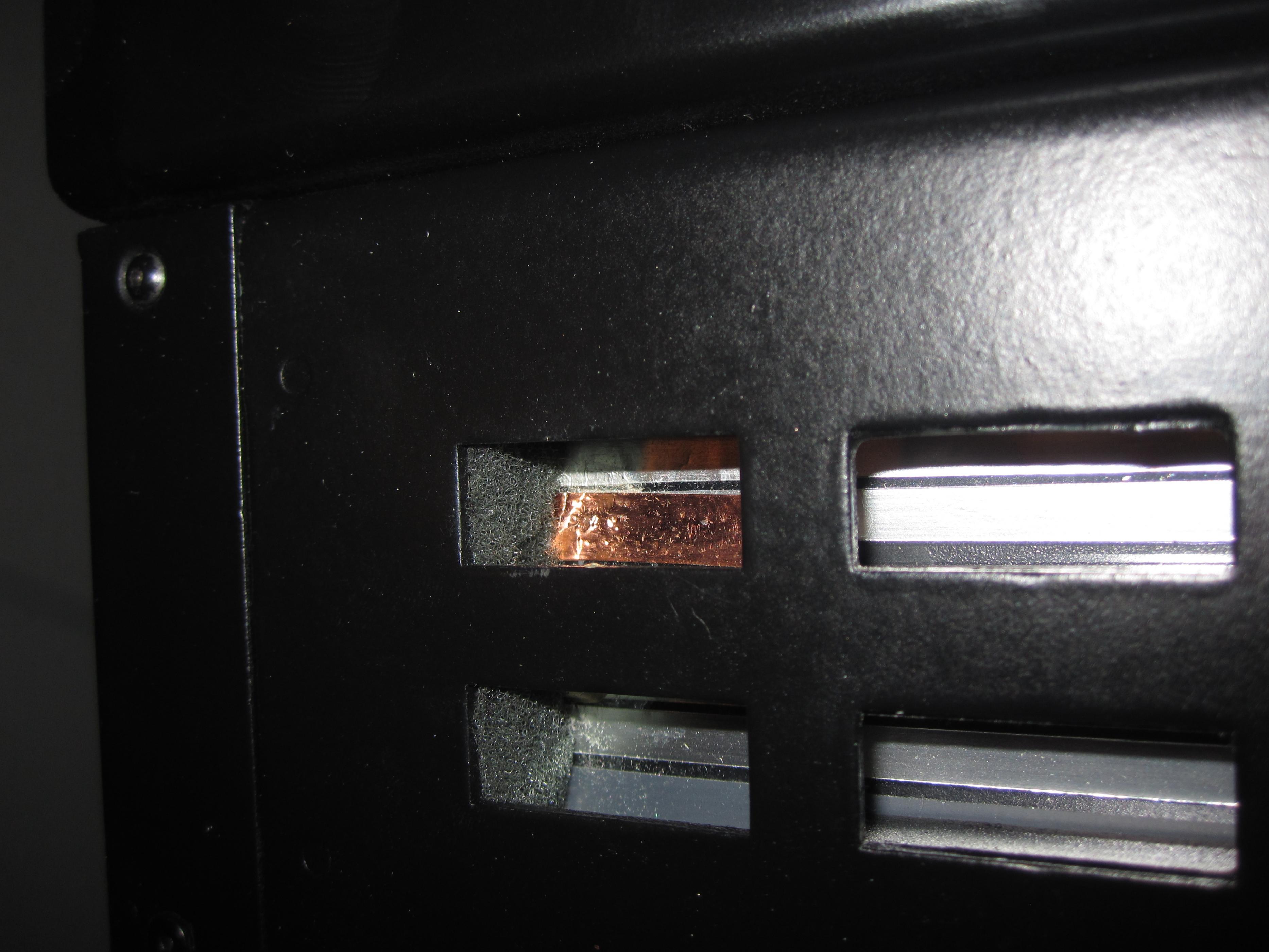

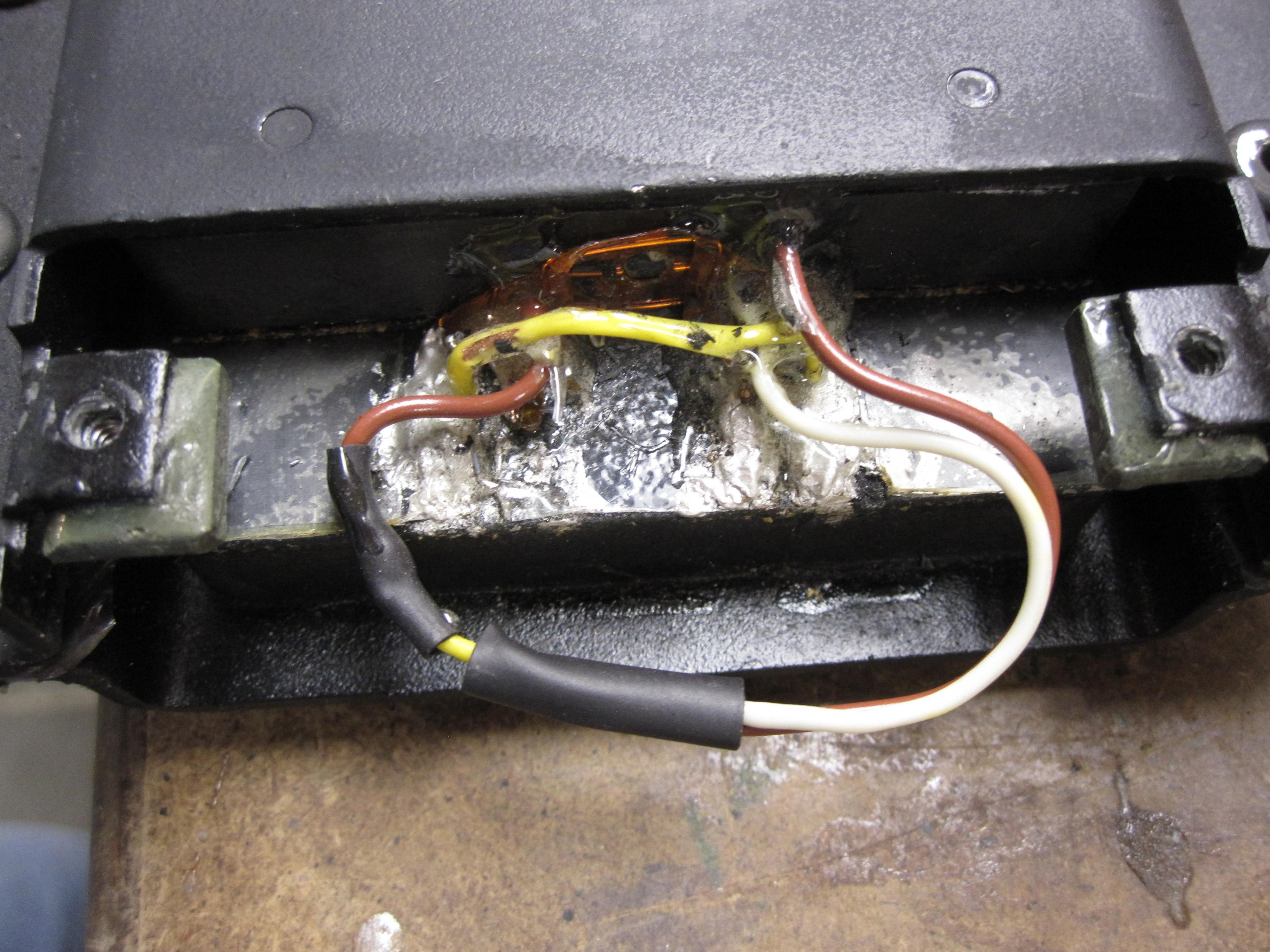

The attached pics show the non-terminal end of the driver after drilling out the rivet and what it looks like underneath. This is the end that was bad, though the other is the same, but had a PC board connection. The pic shows the aluminum foil conductor that is laminated to the diaphragm and the soldered connections to the copper wire that jumpers the ends of the aluminum together. The solder connections were loose - I could move them around. Don't try to re-solder them. It will melt the diaphragm and separate the aluminum foil. The first thing I tried was to clean up the corrosion inhibitor grease that was on the connections and coat with silver epoxy. This is not reliable, so after that failed, I was out of room on the connection side of the spacer that holds down the diaphragm. I then drilled a hole through the spacer, ran a fine insulated, braided copper wire and soldered it to some copper tape with conductive adhesive. I clamped the tape before removing the release paper next to where I soldered on the wire so the heat would not attack the adhesive. The tape was about 5/8" long that adhered to the aluminum diaphragm conductor. I smoothed it out with a pencil eraser. Also before putting the tape down, I made a little plastic tool, stuck 600 grit sand paper to the end of it and gently cleaned the aluminum and wiped with alcohol.
Before doing this I tested the tape's power handling by putting the tape on some aluminum foil and these two in series with my soldering gun. It handled the 140 watts of the gun pulling the trigger intermittently and continuously! This is the tape I used to build my electrostats. I have seen posts where people wonder if the adhesive side or the copper should go to the diaphragm. Based on what I found here - definitely use the adhesive side to conduct and adhere to the mylar.
Back at the end of the copper tape wire I soldered it to other connections that did work out with the silver. Had I known how good the copper tape worked, I would have definitely started with it, like putting it directly over the soldered connections that were bad. I have quite a mess there, but I had nothing to lose. Now they sound great!
Since the covers were riveted, I tapped some small pieces of steel, epoxied in placed and used 4-40 flat head screws to hold the covers on.

Mine was definitely on the soldered end connections. I proved that by probing outside the connections and measured 1 ohm on each of the four legs.
I think if you were to make rounded, larger pads for your meter probes (to avoid poking through the membrane), you could isolate the break. Then clean the spot and put the copper tape over it.
