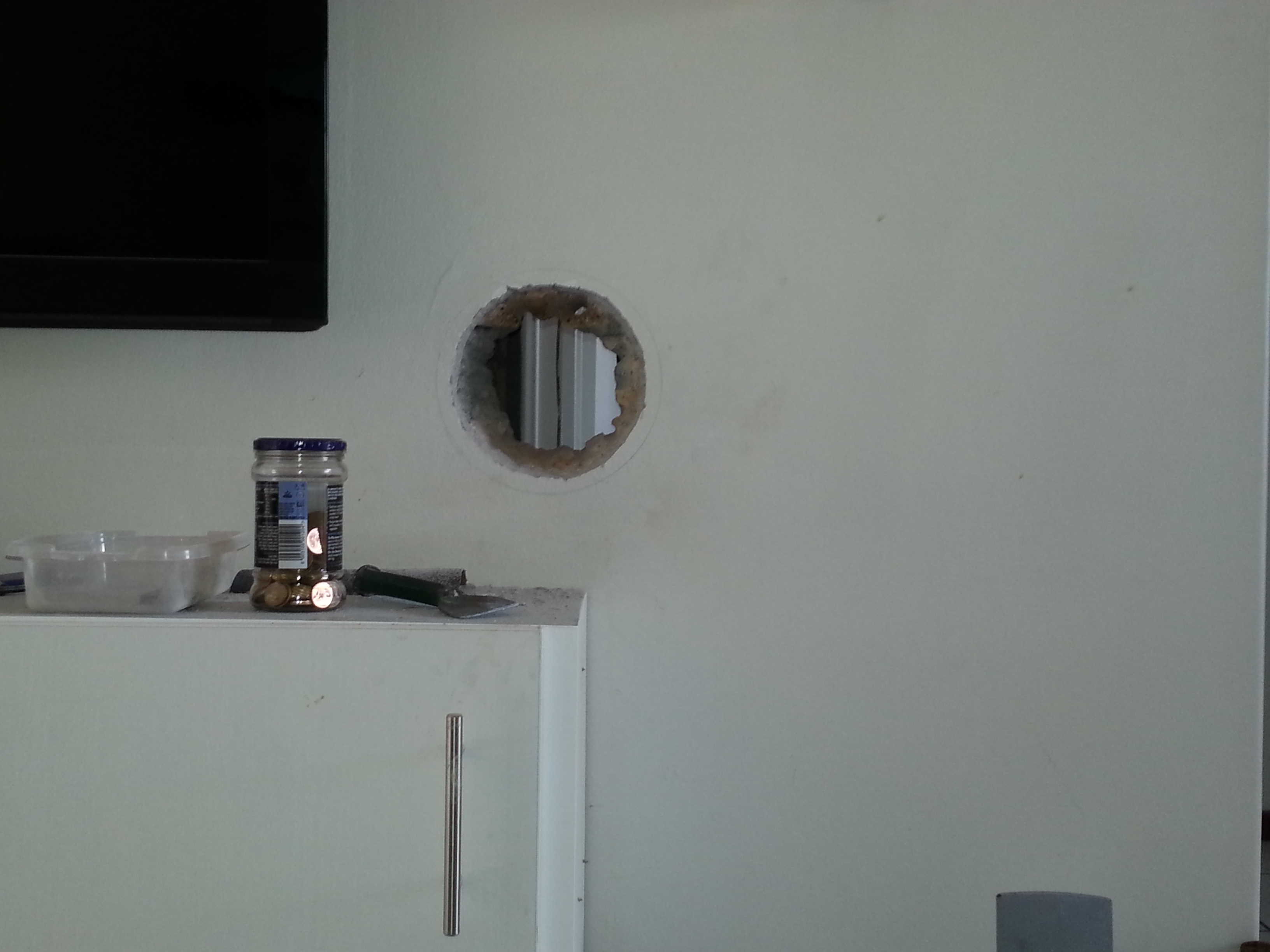

Let me know if there is any other info I can tell you! I've already started the hole in the wall. About a meter off the ground, near the tv. Good? Bad?

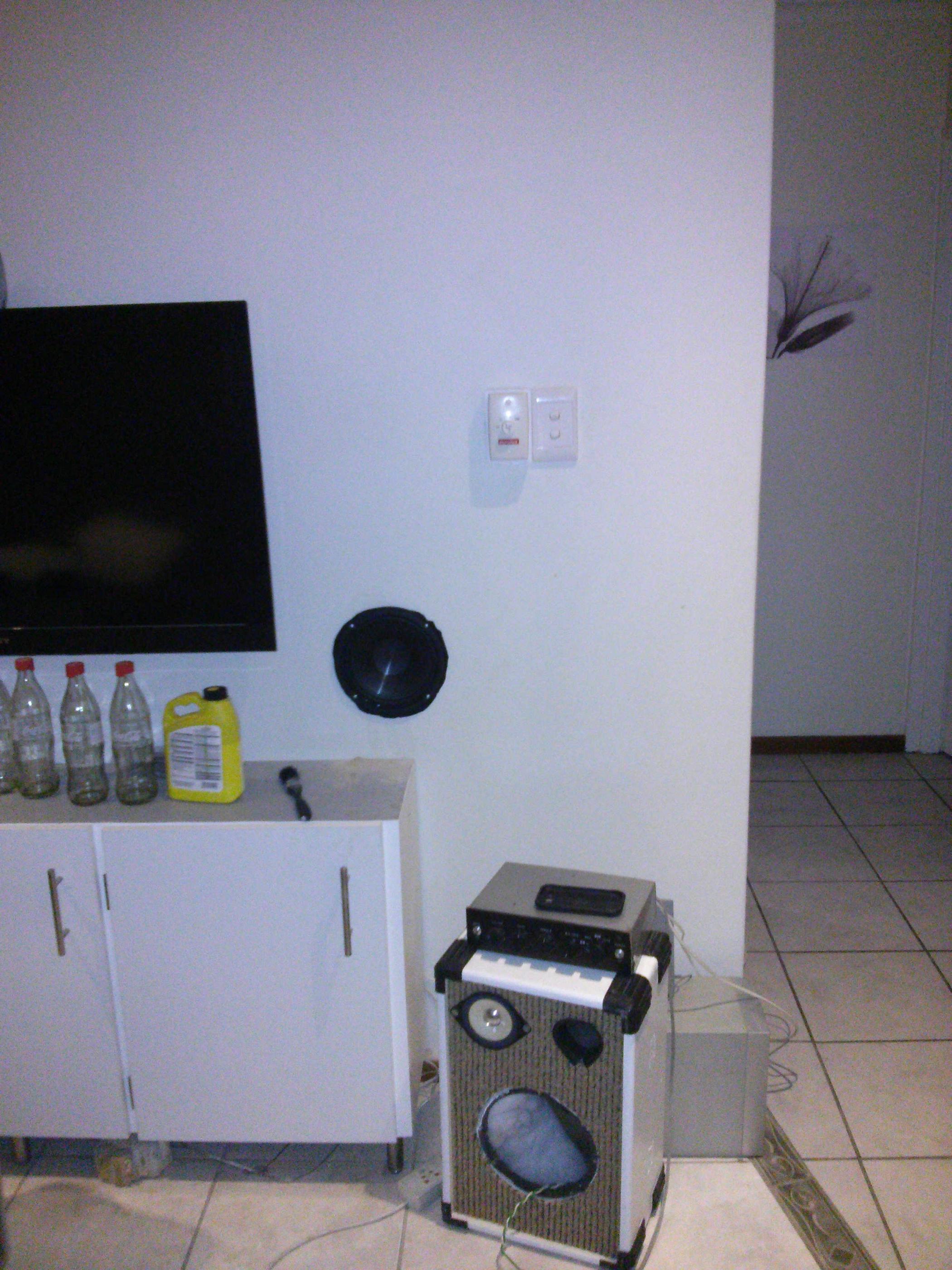

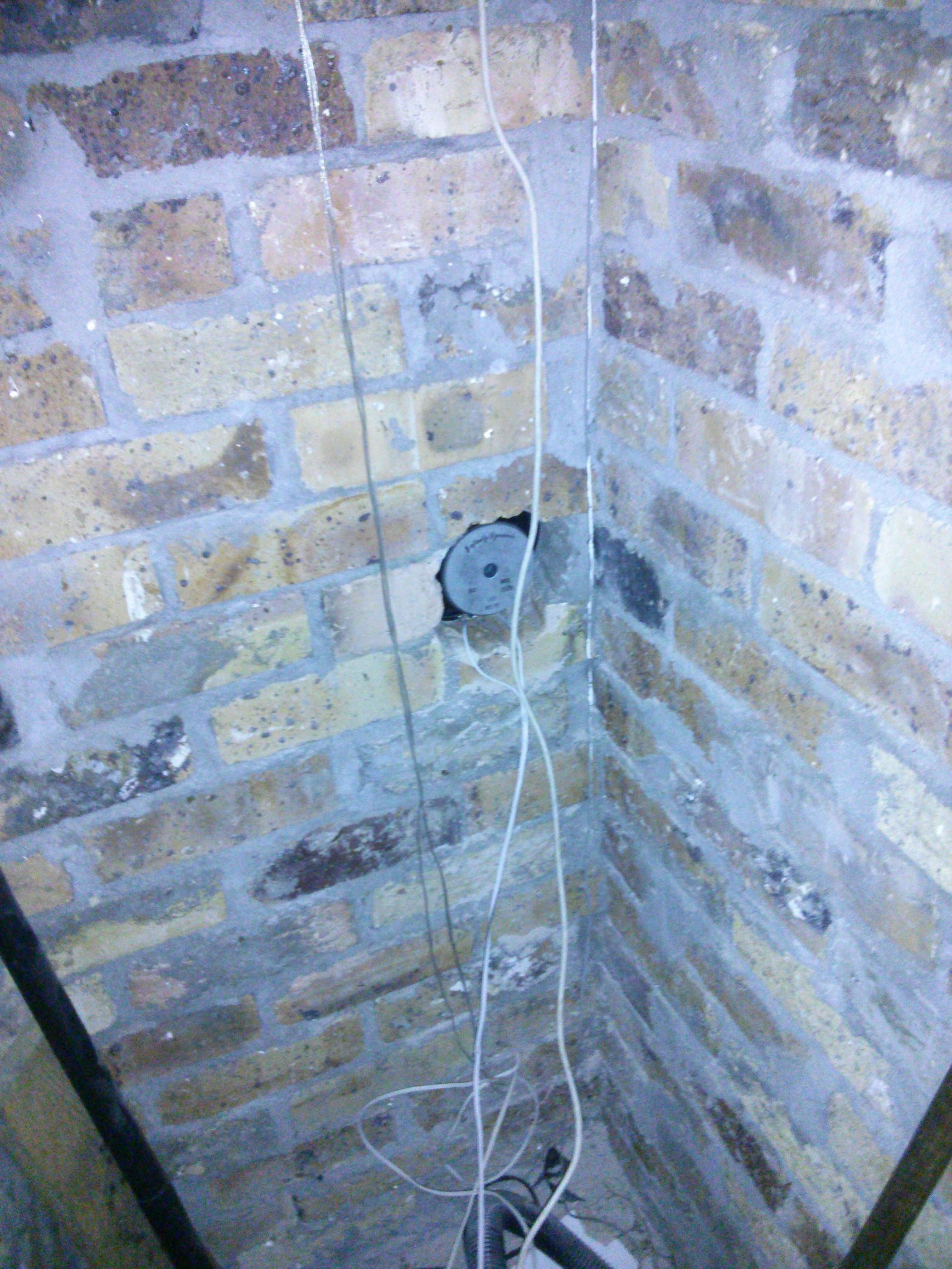

The Finished product
Hey guys, so I went ahead with it, decided to see what would happen. Here's a few pictures, and a few questions at the end.
The driver sounds better, but that's not saying much, since the driver was in the box in the picture, which I put together myself with no calculations, just guess work. The volume is less, which makes sense since there's no port, but tit sounds more "accurate", and just generally a little better. Also, no vibrating at certain frequencies. Which is nice.
Question, what should I use between the wall and the speaker? The part that is screwed down, I have a bit of t shirt in there at the moment. Should I use something like silicone to glue it down? or what?
Once I have completed the cupboard on the other side of the wall, (I need to plaster the wall and build in the cupboard, no backing or siding will be used) I'll see what the speaker sounds like, and decide if I want to do the other, or seal up the hole.
Any other thoughts? advice?

More importantly, the wall is internal, and not load bearing. I checked this in the ceiling. Moreover, its a single brick divider wall, the load bearing walls are two bricks thick on the outer sides. Lol

Please do give what advice you guys have:) that horrible cupboard looking thing with bare walls is now plastered and being painted for a new cupboard to go in.
You need a 100% seal.
I think you may have that... not sure from ur description. the back should be open to the air.
It looks like a smallish driver, and not a sub... so it ought to be pretty ok, but unless you know
the Qt and VAS plus the Xmax its hard to know what it will do in this IB set up...
