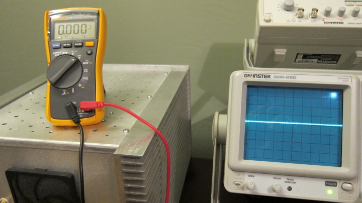

I built the standard F5 a couple years ago and it sounds incredible and works well with one exception involving a Dennon AVR-4603 receiver and a Pioneer flat screen HDTV. Schematic attached. (Of note, I can’t find a schematic of the AVR-4603. If anyone has a link, I’d appreciate it.)
Specifically:
1. A CD player or ipod directly into the F5 sounds fine, powering 8 ohm speakers. The F5 has 24 volt rails, is biased at 1.3 amps with offsets < 5 mV, and this has been confirmed again today.
2. Picking up the preamp output from the Dennon receiver into the F5 also works just fine when using various inputs into the Dennon, such as CD player or auxiliary input (ipod).
3. BUT, if a television (Pioneer Elite PRO-111FD flat panel HDTV) is connected to the Dennon receiver (HDMI) AND the television is powered (even on standby), then when the preamp outputs of the Dennon are connected to the F5, the speakers powered by the F5 will click/pop loudly, with cones alternating at various frequencies between fully out or fully in, and the F5 begins to quickly overheat. The frequency of the loud clicking/popping with alternating and sustained maximal movement of speaker cones begins immediately with F5 power-up, first alternating every second or so and then slowly increasing in frequency. I quickly turn off the F5 to prevent burning up the speakers or the F5, and haven’t let it go more than several seconds. It does not matter what input is selected on the receiver. The F5 does get hot.
4. In fact, even if the Dennon receiver is without power (unplugged from the wall), if the TV is connected to the receiver and the F5’s input is connected to the output from the Dennon’s preamp, and the TV is on standby, the popping/clicking will occur as soon as the F5 is powered up. (I’ve never attempted to turn the TV “on” while the F5 is connected.)
5. If the TV is actually unplugged from the wall (not on standby), then everything is fine. Or if the HDMI cable between the TV and receiver is unplugged at either end, then everything is fine.
So, to investigate this, I spent some time with a scope and DVM today.
Preamp Output Across Dummy Load
First, I took the outputs of the preamp of the Dennon receiver and connected them to 100K ohm resistors to somewhat mimic the input impedance of the F5, and them monitored waveforms and AC and DC voltages across the preamp output in different situations:
1. With no input to the receiver and the receiver powered up, I got a flat waveform and 0.000 VDC by the DVM. This seemed very good.
2. And this remained so even when the TV was connected to the receiver, whether the TV was on standby or not, and whether the receiver was off or on. This threw me a bit. I thought that I would see some DC offset or wild waveforms on the preamp output as soon as the TV was connected and on standby, but the preamp output was a perfectly flat waveform, 0.000 VDC. (Photo attached)
3. When a CD was played and used as input into the receiver, there was no DC offset and the AC signal stayed perfectly centered about 0 V, with appropriate AC voltage out (for example, 0.05 to 2 VAC), changing with volume, of course. And things looked fine on the scope, even with the TV connected and on standby. Again, this was with a 100K ohm load across the preamp outputs and no connection to the F5.
Preamp Connected to F5
So, then I disconnected the TV from the receiver, hooked up the preamp outputs of the receiver into the inputs of the F5 and put 10 ohm power resistors across the F5 outputs (not risking speakers). I monitored waveforms with the scope and voltages by DVM across the power resistors in different situations.
1. With the TV disconnected, the F5 behaved fine with typical waveforms and voltages at speaker terminals across the power resistors. Again, speaker offset with no signal into the receiver was < 5 mV.
2. Then, I powered down the F5, put the receiver on standby, and connected the TV to the receiver by HDMI. On powering up the F5, and without an input signal into the receiver, complex and changing waveforms appeared across the power resistors, with large voltage swings of at least several volts by DVM. I kept adjusting sweep frequencies and gain on the scope, but could never get a constant waveform to photograph.
I also have an F5t with double MOSFET outputs (4 per channel) and double gain (decreased feedback) but no diodes. Exactly same issue.
Conclusions
1. No abnormal signal is seen on the output of the receiver’s preamp, even with the TV connected, when a dummy 100K ohm load is used across the preamp output.
2. No abnormal signal is seen on the output of the F5 when taking input from the receiver’s preamp output as long as the TV is not connected to the receiver AND/OR as long as the TV is unplugged from the wall, without any power.
3. As soon as both the F5 and the TV on standby are connected to the receiver, fluctuating waveforms of various patterns appears on the output of the F5, even with no input into the receiver, and even if the receiver is without any power at all.
Anyone have some insight as to what is occurring here? I wondered if the TV doesn’t sense some sort of capacitance through the receiver when the F5 is powered up, triggering chaos, but I really have no idea. Attempts by the TV to talk to the receiver, I wouldn’t think, would produce large voltage outputs out of the preamp.
Thanks.

Hello Toxic
I also suspect some floating ground issue, particularly when reading your point 3 above: Problem remains with the Denon is switched off.
Is your F5 power supply centerpoint connected to chassis and your mains earthlug at one, and just one point ?
The Denon probably is.
The TV too.
This leaves the mains conditioner. The two mains lugs are probably 60 VAC each (on your side of the pond), like a safety transformer.
But is the earth lug fed thru ?

Everyone, things appear bit more complicated than a ground loop, it seems.
Tonight I tightened all grounds in the electrical panel. I confirmed good external grounding of the panel through two large copper multi-element cables to earth ground.
I then removed anything plugged in the circuit I was using that I could find.
I confirmed the outlet’s earth ground. I then set up the following situation:
1. Pioneer TV on standby.
2. HDMI cable from TV to Dennon receiver.
3. Dennon receiver UNPLUGGED (receiving no power).
4. RCA cable from preamp outputs on Dennon receiver to inputs of F5.
5. F5 output to 10 ohm power resistors.
6. Monitored output across one power resistor with scope and voltmeter.
7. Turned F5 on.
I kept my fingers crossed and let things run on longer than ever before, hoping I didn’t cook the F5, and took video and tried various settings on the scope to best capture the signal. The signal followed a pattern, and appeared as periodic runs of square waves, at least in part. They must be originating in the TV. Again, they disappear if I unplug the HDMI cable or if I unplug the TV from the wall so the TV receives no power.
I posted the video of the voltmeter and scope on YouTube while I changed between various gains and sweep frequencies on the scope:
F5 Dennon AVR 4603 - Pioneer Elite PRO-111FD - YouTube
What might we be looking at and why are these signals ending up being transferred through the Dennon receiver (not plugged into power) to the F5.
I suspect some additional tests will be to connect the TV to the receiver using component video (without HDMI) and see what things look like. Also might consider trying a different TV or brand of TV.
Just as a reminder from my original post, above, when I do this same setup, but monitor the preamp output of the Dennon receiver across 100K ohm resistors (without the F5) I get 0.000 volts and a flat waveform.
I deeply appreciate any insight that might be offered. Thanks, everyone.

A couple of people have emailed me.
One wondered in I might have a bad HDMI cable allowing cross-talking, perhaps even a short between elements.
Another pointed out that HDMI runs 5V 50 mA and wonders if a signal of that magnitude might not be able to provide enough power to the unplugged amp to energize circuits to some extent, allowing the signal to bleed over to the preamp outputs.
I may try a different cable. But I think it may be more revealing to try a different receiver.
The HDMI in your particular TV also has control capability, so it could be sending out commands or polling external devices even in suspend mode (just speculating here). Do you have a cheap speaker to test/listen to your current minimized configuration with the Denon powered on? Bad HDMI port on either device? Bad HDMI cable?
