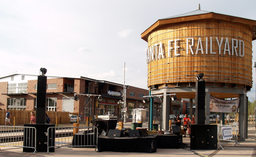

I would strongly encourage you to use the sub vertically to get (most) of the mid and high frequencies above head level, or use the sub as a base and put a pole under the mids.This is the way I plan to run the cabinets tapped horn turned down on its side for the base, then the midbass standing up

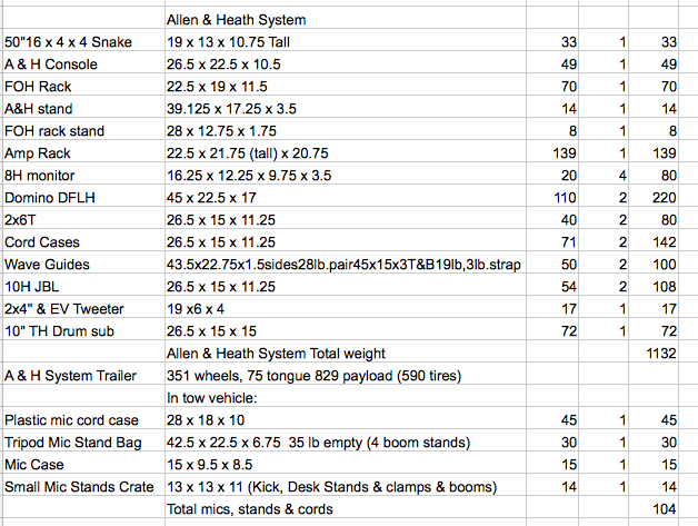

The system below, (also using Lab 12s for LF in a similar size cabinet as the Pal plus waveguides), uses a speaker cord box as a stand to elevate the top cabinets (containing one 10", two 6.5", and two HF drivers) to 67.5 inches high. The cabinets use interlocking dowel pins and ratchet straps to secure the tall system against the crowd and wind.
People can stand only a few feet in front of the system and not hurt their ears, and without the HF being absorbed by them, it carries much further.

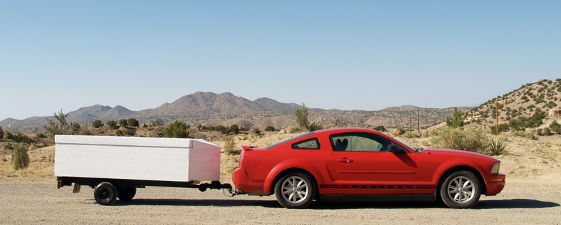

The whole system fits in a small trailer, avoiding abusing the interior of my Mustang.
Building the trailer was a lot easier than building any of the cabinets...
Art
The upper lid is removable, otherwise loading would only be comfortable for people under 28 inches tall .Does the trailer expand vertically?
After the lid is removed, the rear gate slides out and becomes a 4 foot long ramp attached with ball-lock pins.

I would agree with Art. IMHO everything above 200hz or so should be above head height. So, bottom of your mains cab at least 6ft off the ground. Tough to say about your kick/mid bins, typically a kick bin would be around chest/head level but would only be used 80-200hz or less. 400hz coming out of those double 15's at torso to head level is going to be absorbed by the the crowd, not to mention deafening to be in front of.
I'm still thinking this is going to be sub bass shy. The kind of top/kick setup you have would typically be paired with 2x 18" horn subs each side or 2x 2x18 reflex on each side.
My 15" reflex have similar estimated max output to the PAL12 (~125db 1m) and match up well with normal 10" PA tops on 200w.
You may want to seriously consider putting the subs together and corner loading them in most venues.

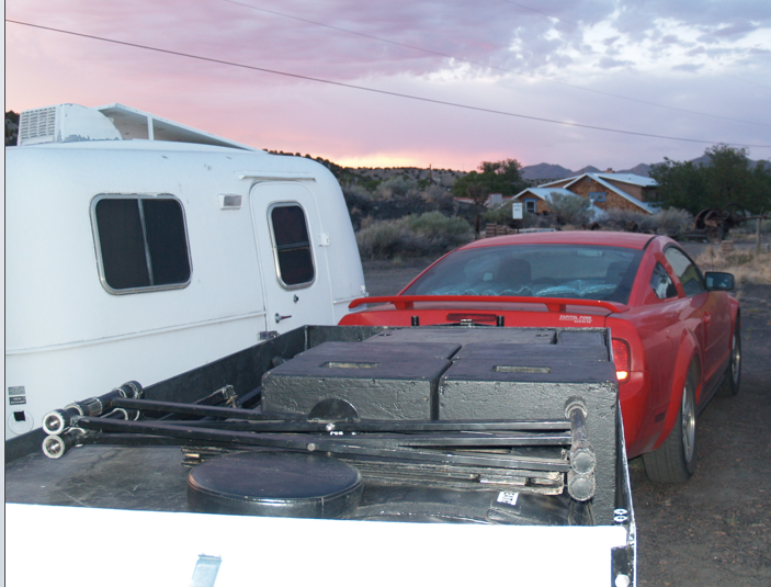

The entire sound system other than a few items which go in the trunk of the tow vehicle fits in the trailer, list below.Nice system break down weltersys! It all fits in that trailer? What about the amps and processors? Curious how the system looks up close be very interesting what you other guy's are building. Any plans for the trailer OR should I look at Popular Mechanics mags? Thanks! I love this site!
No plans for the trailer, it's basically a box on top of a kit trailer bought at a Menard's, a store like Home Depot or Lowe's .
I have seen some trailer kits for cheap at Harbor Freight.
It is overweight, but I had the kit, which had been a land/ice yacht in it's first incarnation about 25 years ago .
