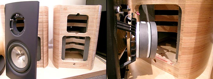

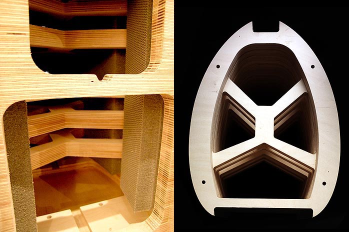

Also, there is no reason that a translam (stacked layers of high quality plywood) can't be built with a front baffle. The speaker that popularized this style used both a front and rear baffle attached with threaded rods. See below. Btw, I would strongly recommend a router table for this type of construction. Makes things a lot easier.

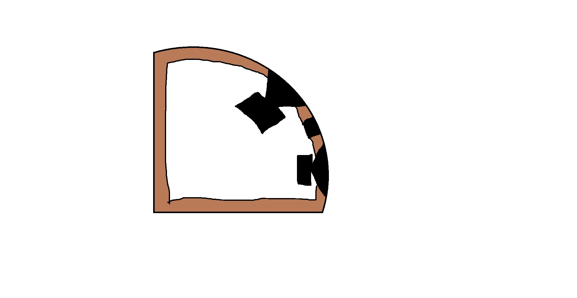

What total seemed to kill my MTM with my Dayton's or Aura is that I have to chamfer (spelling?) the back and I can't get to it. Here is my box design cross-section:
You know now that I "drew" it. I kind of don't like it
There will be a metal grill covering the top and front.
Why exactly do you want to curve the baffle like that for a pair of near field computer speakers? Seems like nothing but trouble to me with no real advantages other than perhaps a cool aesthetic?? And whether or not you front or rear mount the drivers, the inside of the baffle should be chamfered in either case.
Actually, even front mounting a driver on that curved surface is going to be a real challenge, more so as the driver gets larger. Curve the sides if you must, angle the front baffle so that it's on axis to your listening height if you want, but whatever you do, keep it flat.
