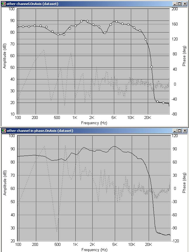

I hadn't taken any measurements using a mic and Speaker Workshop before because I didn't think there was any point until I got a decent mic. Man was I wrong!!!
I've only got a cheap and nasty computer mic, specs something like 80Hz - 10Khz +- 3db, but curiousity got the better of me yesterday and I decided to do some crude measurements.
To my surprise I discovered that my Mids were wired up out of phase!!! I'd been unhappy with the sound since I put them back in (they'ed been replaced with cheap polycones for a while since I thought I'd cooked them). I put it down to the fact that they were partially cooked, but they still sounded better than the polycones so I decided to live with it.
I reversed the wiring and they sound heaps better, pretty much managed to remove that somewhat nasal sound from peoples voices. Now I want to get a decent mic, and a mic preamp so I can do some proper testing, esp once I start work on my new set of speakers!
I've attached the plots. Don't pay too much attention to the relative level below 500 Hz, this is partially due to the position of the mic when doing the test (about 30 cm from mid and tweet), although the dip from 200Hz to 500Hz does indicate a problem with my box tuning (probably due to leaks). I'm unsure whether teh 5Khz peak is in the mic response or the tweeter, but for now I'm happy that I identified a major problem and my speakers now sound better for it.
The plots are 1/3 octave smoothed.

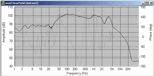

Here is a nearfield plot of the woofer no XO (well its a bit dodgy actually as only one of the leads to the XO was disconnected and I was running another lead from the amp in through one of the vents) Hey I was just trying to get an idea whether the 500Hz dip was XO related or maybe the box. Published specs of the Vifa M26WR-09-08 do show a slight dip from 200 to 500 Hz but nowhere near this dramatic. Looked a bit like some of the response curves I modeled when the tuning was off.
Once again, I'm not sure of the mic, the modeled -3db point for this speaker was around 36Hz, this plot is nowhere near it (more like 57Hz). I'm not going to read too much into it until I can get myself a panasonic electret and fully calibrate speaker workshop with my new Audigy 2 ZS. :)
I just thought it was cool that it was so obvious that the mids were out of phase, from looking at the first plot....... I never would have picked it by ear! (well maybe I would now, but.....)
My mic placement for the plot below (about 2 cm from the dust cap) was probably dodgy as well, All part of the fun though :)
edit: Oh and it doesn't help that the mid shouldn't be crossed as low as 500Hz either :)

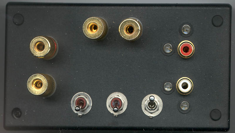

I made the first walin jig, but I didn't put in the mike switch or rca jack (I'm pretty sure it had that), as at the time I didn't think I'd need it...... (I was under the impression I'd need to spend $200 or more for a reasonable mike, and I couldn't see the point, little did I know!) I'll have to rework the jig, mines in a plastic jiffy box, but it looks ok (see attached) I don't have a digicam, so scanned it on the flatbed :). I'll also check out the mic preamp, I'd been meaning to start searching for one!
