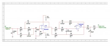

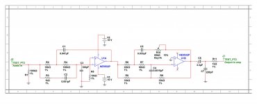

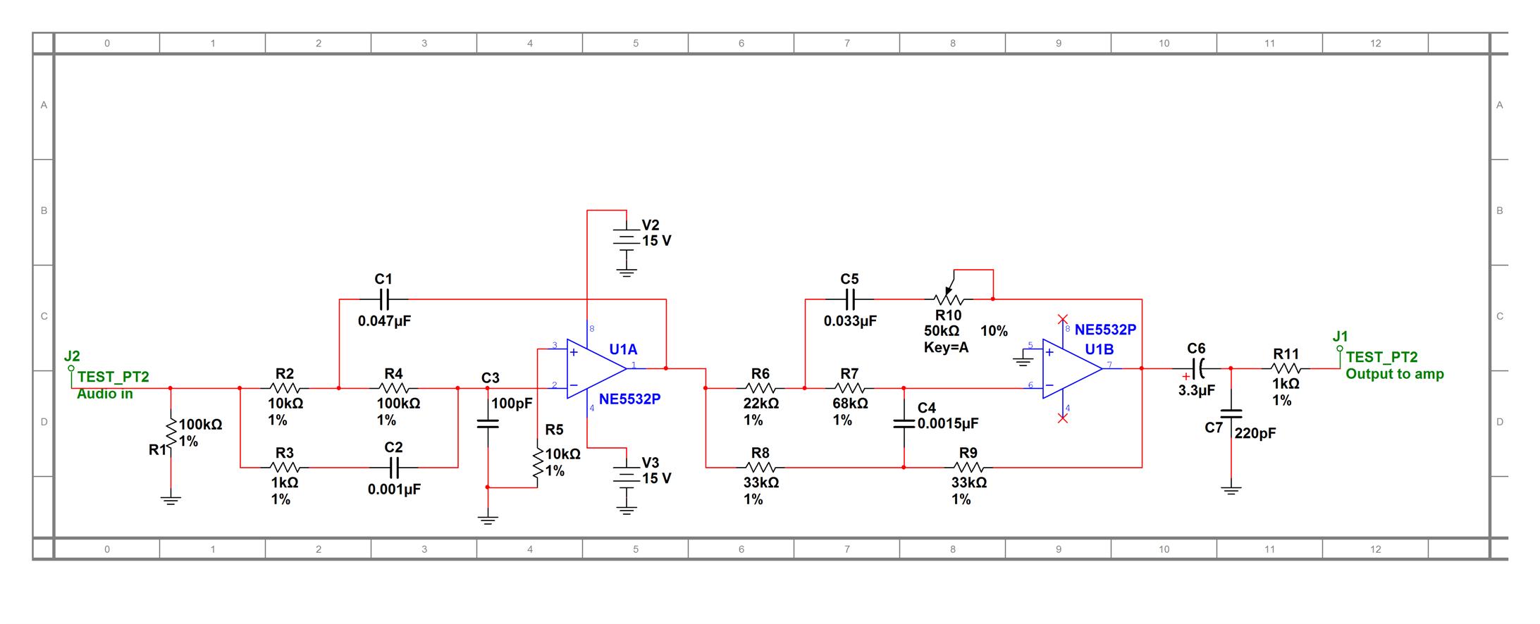

What your wanting is probably best done at the speaker end of things, but that would be more expensive with the need for inductors. My best recommendation is a simple buffered notch filter. This gives around -6db at 1kHz and -3db at 500Hz and 1.5kHz. I can't make any promises on sound quality and the like so it's up to you.
