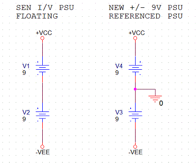

Problem solved !!:drink:
At the beginning, the I/V stage was a Sen I/V of xen Audio that I implemented for testing. This circuit uses a floating PSU with batteries because is very sensible to noise and has a very low PSSR if any.
As a good diyer :cool: i'm very lazy to build a new psu for an opamp i/v stage, and take the same psu used for Sen I/V, forgeting that it was FLOATING psu.
With the time, GND is wandering, and makes to signal cllips very nasty.
As I could see Sen I/V also clips with this system of floating PSU.

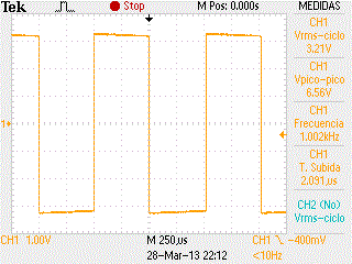

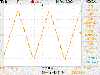

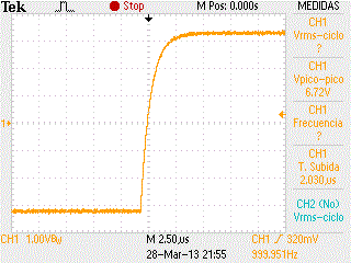

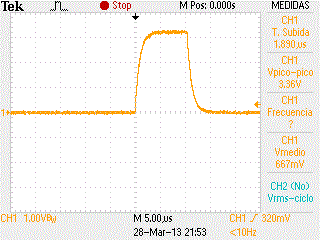

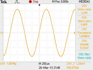

Attach some captures on my scope, including a dirac impulse (img.2) at a resolution of 24/96.
The fix to clipping was simple: add a reference GND to PSU
