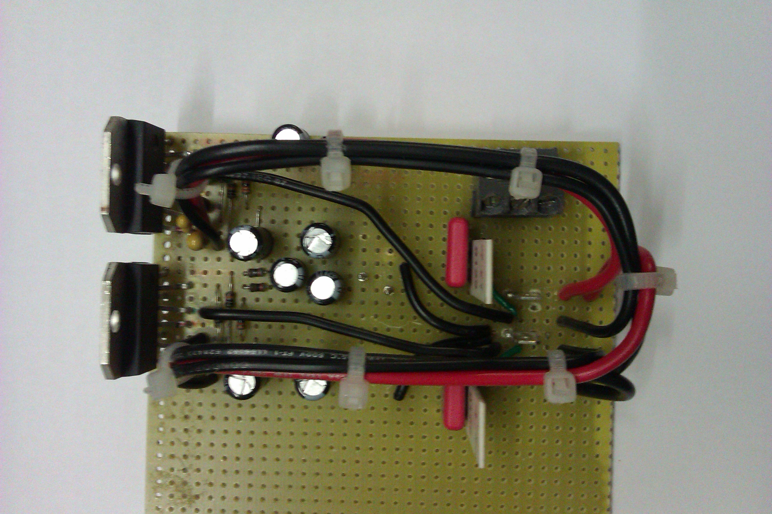

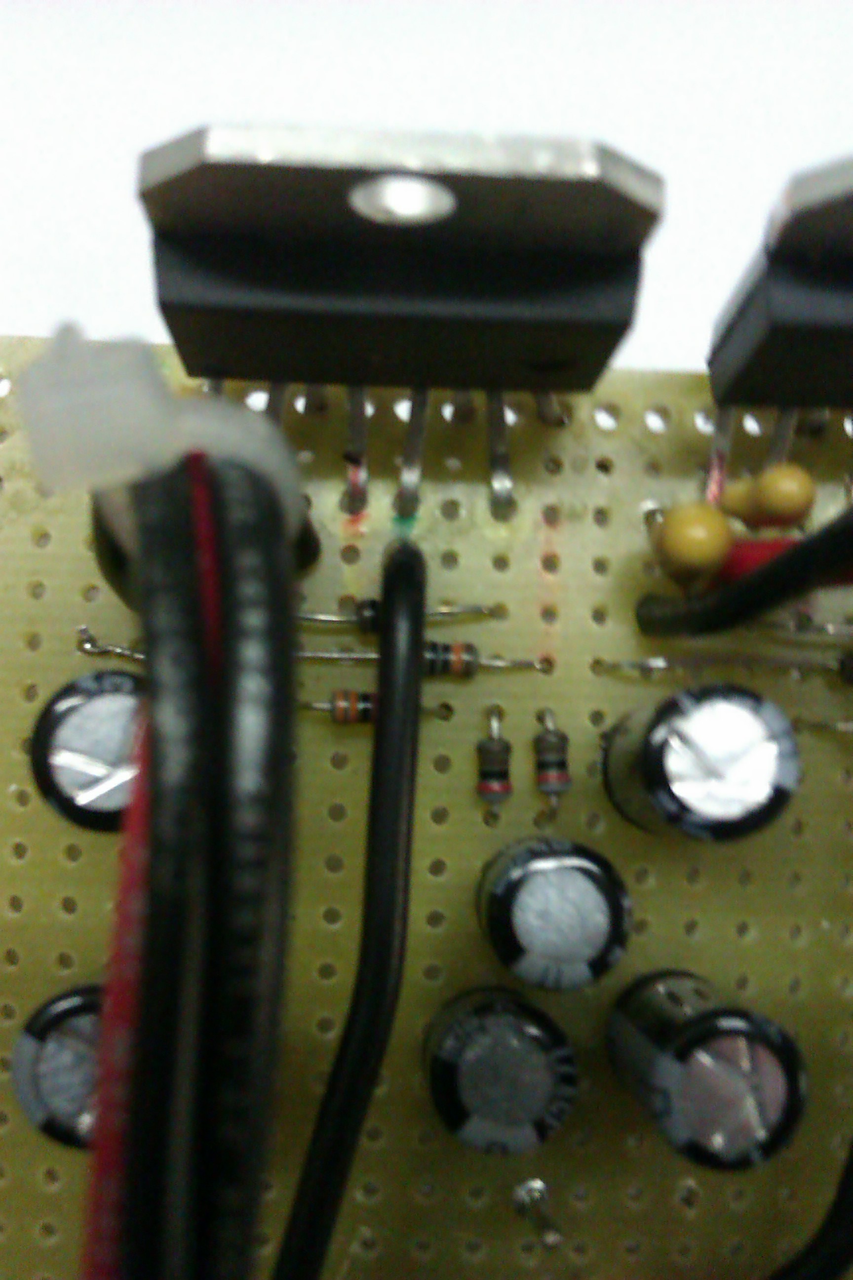

I came across these pics of my layout of the stereo/paralleled amps using the 3886 off 42V. They drove 2.7ohms quite happily and stayed perfectly cool. The topology is a bit different from the standard since they are driven differentially, so you'll need one fewer R and C on each side. You can count the holes to tell how big they are, but it's about the size of a credit card.
These looks quite neat. I will definately read up more about the lm3886, it does wonders.
