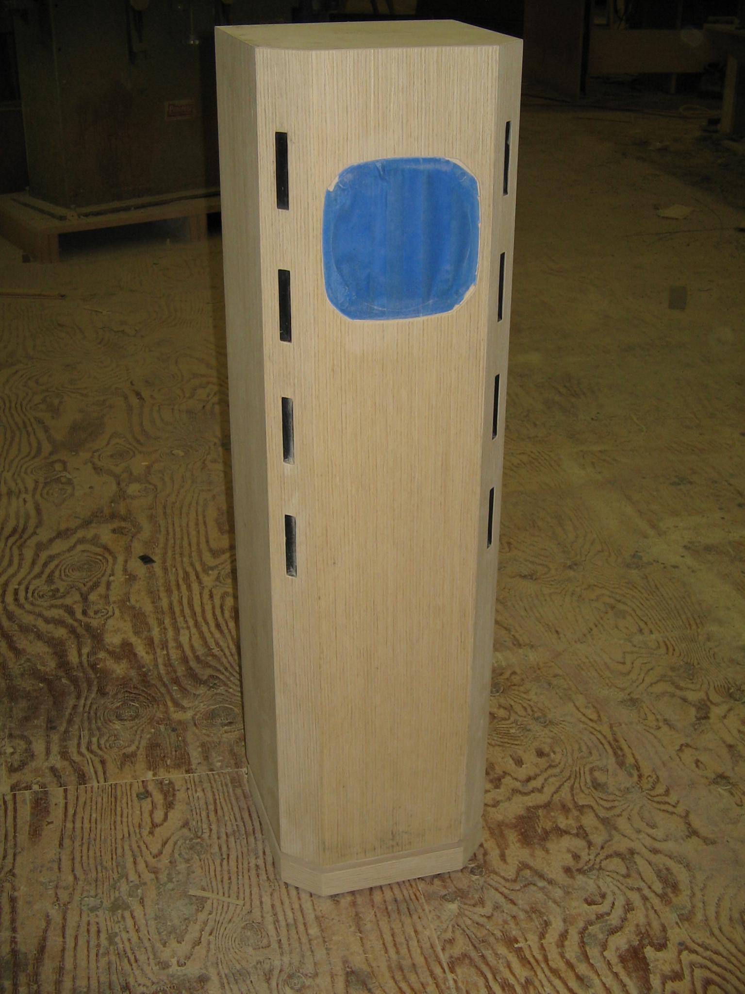

The referenced enclosure is part of a paid plan-set for the Alpair 10.2 - two drivers mounted on face of approx 30L (?) typical MarKen style ( side mounted narrow slots, etc). Overall height of working enclosure is 730mm, which clearly need some type of short base, or void cavity (as seen on photo of FE167 version of several years back) . Second photo is veneered cabinet awaiting finish booth.
While these enclosures don't rely on 1/4 w/l action as do MLTLs, the length of port slots on the whole "Ken" series is a critical part of the tuning, and massaging CSA to maintain volume and increase height wouldn't be benign. It would require a complete recalculation, which doesn't follow conventional methods / modeling software.
Mount front facing driver centered approx 130mm from top, you should be able to squeeze the second one on the top.

How deep are those, Chris?
Please note the photos are for an approx 4 year old design for the now discontinued FE167E - there is document with detailed plans and build photos available from Dave. While the overall topology will be the same for Alpair10.2, the dimensions will be different.
That said, the rough dimensions on the enclosures shown above are 299mm W x 286 mm D - my builds were 960mm H less the plinth seen below the reveal strip in photo below. After the first build, they all had input terminal cups mounted on bottom resulting in a clean back panel, and the lower voids were filled with glass blasting media; heavy MFs they turned out to be - my chiropractor loves it when I move them .

You can start with single Alpair 10.2 MLTL designs. When doubled together you can attain a bipolar or a castle as you please. I've done several bipolar MLTLs with both drivers in the same volume and one design (offset arrangement) with a common shared panel between the two MLTLs.
MLTL designs are somewhat more forgiving/easier in tuning than other approaches.
