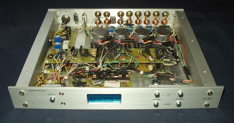

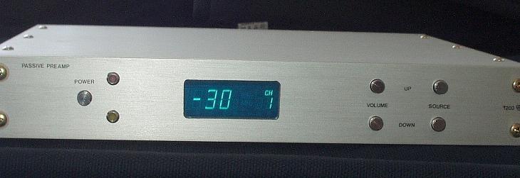

analog_sa said:What a nightmare! Can't possibly sound half as good as a simple ELMA/Seiden switch. But it glows and may even have remote...
Although appealing to some, I could never get used to two buttons for changing volume. There is only one way to implement that control and it's the knob.
The metal work and layout is done very nicely though. And I kind of understand the design choices here. Using knobs would change the visual character of the unit and remote is probably easier to implement this way than with knobs. I've seen similar unit on the Bent Audio board selling for $10K, although it's using knobs

tiroth said:Very nice looking! It looks as though it was a ton of work. How is the sound?
Thanks. I hope to compare the sound of this TVC with some other 'classic' preamps (S&B TX102-based and Sowter) in the next couple of days so I can evaluate its sound more adequately. Technical specifications are quite satisfactory.

Yeah, yeah... I didn't expect to hear a word of praise from you. Nor would I want to. And I bet the only proper way to do it is missionary, right ?
Peter Daniel said:Although appealing to some, I could never get used to two buttons for changing volume. There is only one way to implement that control and it's the knob.
Thanks. A rotary encoder was implemented in the beta version

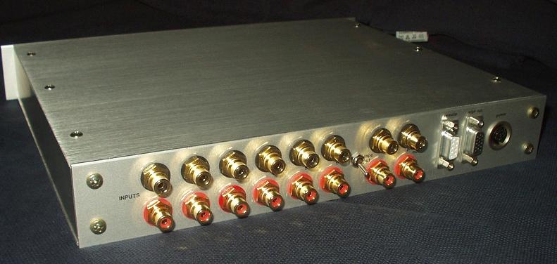

tg3 said:What are the DB9 plugs for? Programming the chips? Serial interface for remote control?
BTW, nicely done.
one DB9 I will use for remote control from central remote receiver. (simple TTL logic for volume up/dn, input up/dn, on/off and mute) Second connector is DB15 for level-volume control of additional HT preamps/amps control (simplified version with CMOS-like chips - not done yet). All control logic uses basic CMOS IC's(up/dn counters, converters, logic), diodes and signal transistors.
