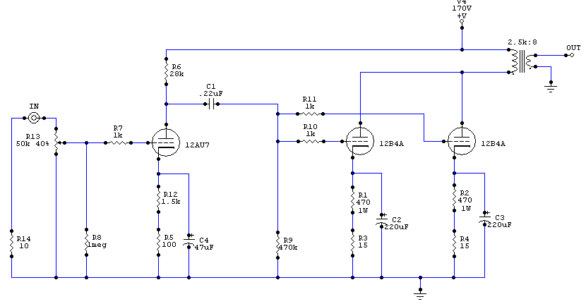

I'm putting together this PSE amp using the 12B4 doubled up running into an OPT at 2500 ohms. With only 170VDC for my B+, I get a really 'steep' loadline for the 12B4......my question is 'How does one do the DC loadline for "twin" ouput tubes.??? I,m trying to get a handle on how much current each channel will be drawing.

Double your load impedance at half the total quiescent current.
Each tube will see half the total current and will only have to drive half the load: 2500 * 2 = 5000 ohms
The transformer will still operate at the same quiescent current.
Makes sense?
