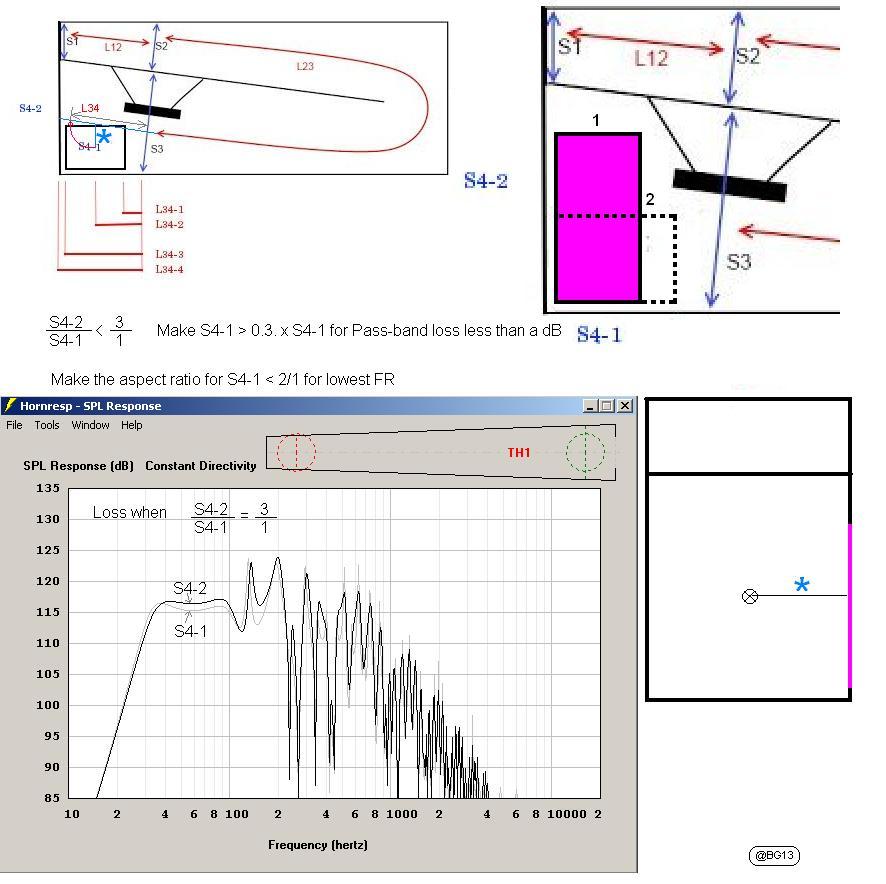

I have a question about the horn building: I want to have a side opened mouth like DTS-10, but I don't understand in this case how to measure L34 and S4:
- Is S4 always the end of the section (S4-2) or is it the area of the aperture (S4-1) ?
- How to measure L34:
* Begining of the aperture L34-1 ?
* Axis of the aperture L34-2 ?
* End of the aperture L34-3 ?
* Always the end of the section L34-4 ?
Thanks !
