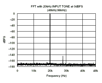

we have been deceived by datasheet
The datasheet of sample rate converter deceived us!See SRC4192 datasheet.The FFT of 1KHz tone is good, but 20KHz is much worse(44.1 to 96KHz), so you can't see the figure of FFT of 20KHz tone (44.1 to 192KHz) in datasheet.If it's 30KHz,the FFT will worse than 20KHz,if......
The high frequence distortion will modulate and bring big
distortion in audio frequence which we may heard.So the SRC
is only garbage to us.
AD1865, at 20kHz the worst distortion shown is -144dB! In other modes the distortion is below -160dB. This is so much better than even the best DACs that I find it hard to believe that you will get intermodulation products that aren't swamped by other distortions.
