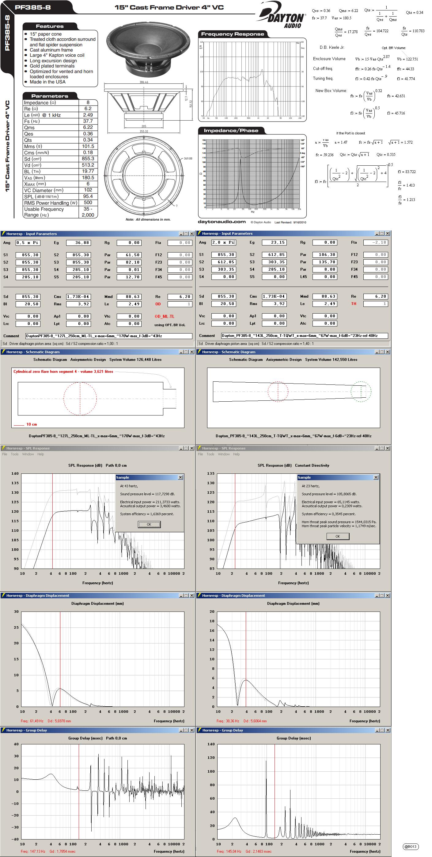

I have a pair of discontinued Dayton 15" PA woofers I would like to use in a pair of home subwoofers: Dayton Audio PF385-8 15" Cast Frame Driver 4" VC 295-080
38 Hz seems a little high for a subwoofer, and the sensitivity is high so I though adding mass to the woofers might be the way to go. I know some of the classic British manufacturers used to use something that looked like epoxy and sand to add mass to their woofers, and JBL adds lead mass rings to the top of the voice coil assembly.
Opinions, ideas, comments?
In theory you can add about 100g to the 100g cone to drop
Fs to 27Hz and bump up the Qts to 0.5. AS Vas remains
the same due to higher Qts the ideal box size increases.
How the suspension and surround would cope with
the extra mass I'm not sure, probably would be OK.
rgds, sreten.

Hi audiomagnate,
Why chase fs..IMO,you should consider other options:
b:)
