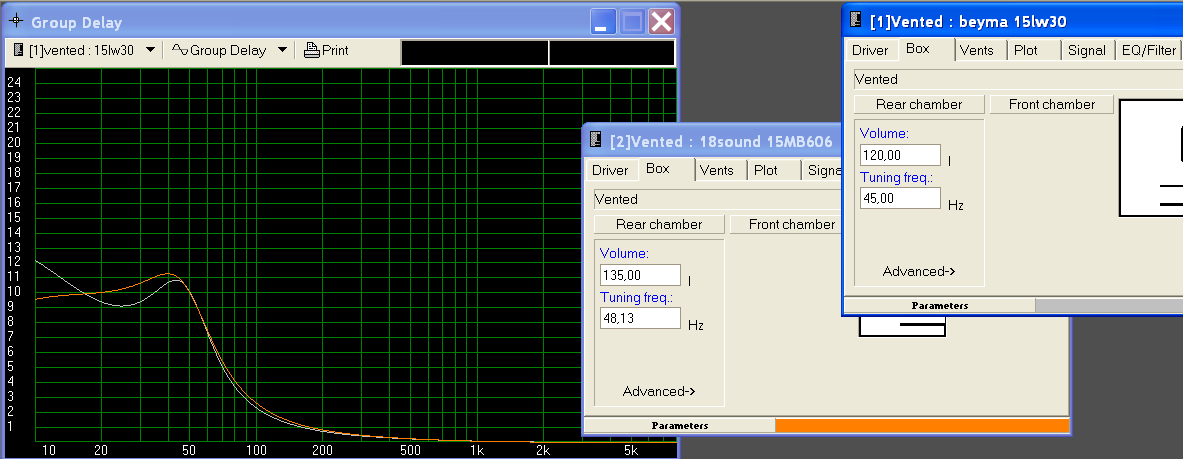

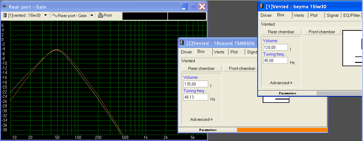

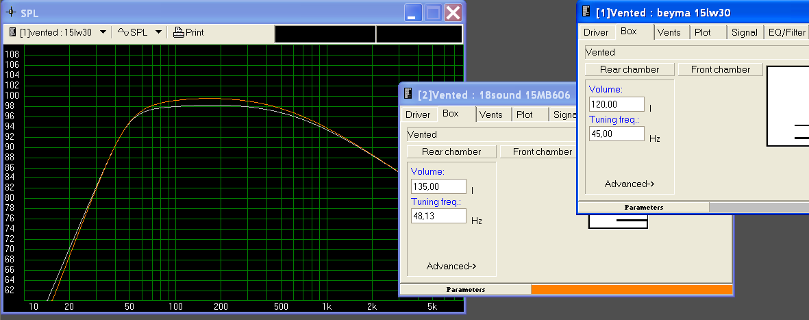

strange I thought I posted these in this topic.
For higher efficiency. 99dB wmtr -6dB 35HZ
Beyma 15lw30
And
18 sound 15MB606
attachment.php
attachment.php
attachment.php
15mb606
15lw30
