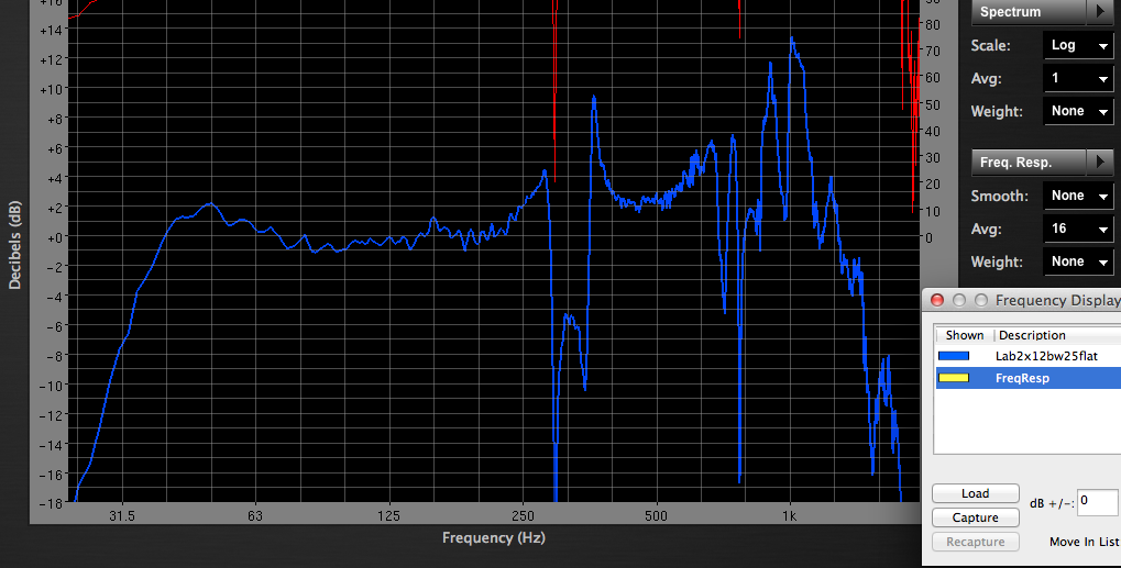

FREE SUB PLAN: Dual Lab12 (Front Loaded) by Welter Systems
It is about the size of a JBL SRX 718, but has more LF output, it goes deeper than a SRX 728.
Using a pair of TC EPIC 12" instead of the Lab 12s, it would be very close to the same output as the 728 in less than half the size.
I have a pair of the WS 2x12" cabinets for sale unloaded if you are interested.

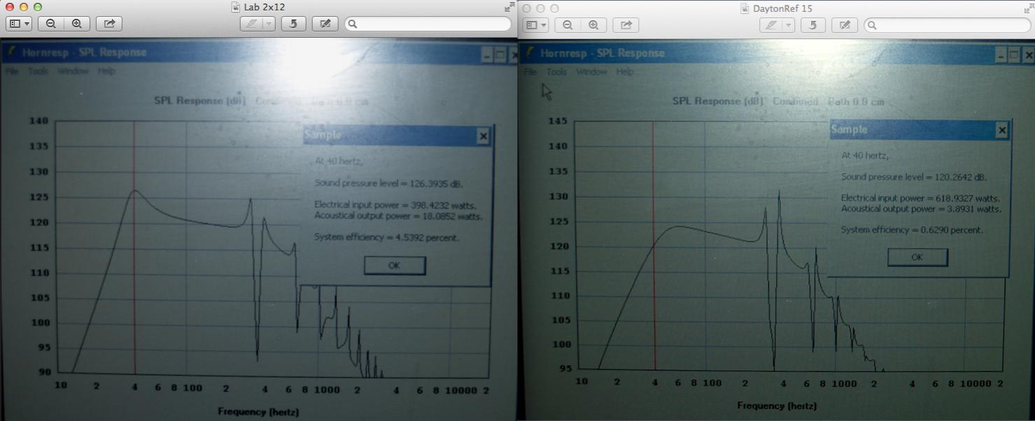

Turbodawg,In a 20x22x16" 50lb build, having low extension (usable in room to 30 hz w/o eq) and no need for digital time delay to time align the mains was a big bonus, while still getting nearly the sensitivity (95 db/w/m/2pi) and max output of a compareably sized horn.
You are using the Dayton Reference 15 four ohm driver in a very small low tuned ported box.
It is only 87 dB one watt one meter at 100 Hz, and drops considerably in sensitivity from there, probably in the 80 dB one watt one meter range at Fb.
Have you any measurements?

Hornresp sim's to a 40-50hz peak over 95 db/m/2pi at 2.0V input, aka nominally 1w, and -3 db around 34 hz. It has a mildly peaking response with lots of gain from the port, like a house curve, and I'm using a bit of overlap at the crossover to fill in the midbass. Dayton's spec sheet calls their shown response below 200hz as "not actual". These simmed higher sensitivity than other smaller drivers, the only thing comparable was some of the eminence LF models.
I could use my analog rat shack SPL meter with correction data to pull some numbers, if I get around to it.
Running full range music, bass heavy, I've hit over ~115db peaks in the middle of the room, the RS meter is accurate "enough" for that, without the system breaking a sweat or the subs near xmax.
I'll trust it's loud to you .Hornresp sim's to a 40-50hz peak over 95 db/m/2pi at 2.0V input, aka nominally 1w, and -3 db around 34 hz.
I guess I could use my analog rat shack SPL meter with a correction file to pull some numbers, if I get around to it. Trust me, it's loud.
You claim a response 8 dB above a manufacturer's specification, and have not bothered to put a dB meter in front of the cabinet?
Please show us the Hornresp input screen and FR that result in an 8 dB sensitivity increase over the manufacturer's specifications and a measured response at a few frequencies.

I'll see what I can do, but I've got many projects in process right now. Taking an inaccurate measurement of these is not a high priority. I'm confident of my ablity to use simulation software and casual observation seems to indicate they are performing as expected.

Using the Dayton Reference 15 in a simulation of about 90L net (20x22x16 using 3/4") 2 volt with a 35 Hz Fb does show 95 dB at 60Hz, 91.96 at 40Hz, but only 89.34 at 35 Hz. At 30 Hz it shows 85 dB.
Hornresp is very useful, but it often shows peaks larger than reality, and drooping upper response (or more LF response) than real measurements.
Comparing the real measurement of my Lab 2x12" to the sim, the sim shows the response at 40 Hz to be some 10 dB higher than 500 Hz, while it is actually 2 dB less.
I built the Lab 2x12" before using Hornresp, that peaky port "boom" Hornresp predicts would have scared me off.
If the same holds true for your Dayton Reference 15 in a 20x22x16 35Fb box, it may be closer to 87 dB than 95 dB sensitivity.
HornResp doesn't take losses into effect, if I remember correctly. Gotta be a bit careful when using it to sim vented boxes.
