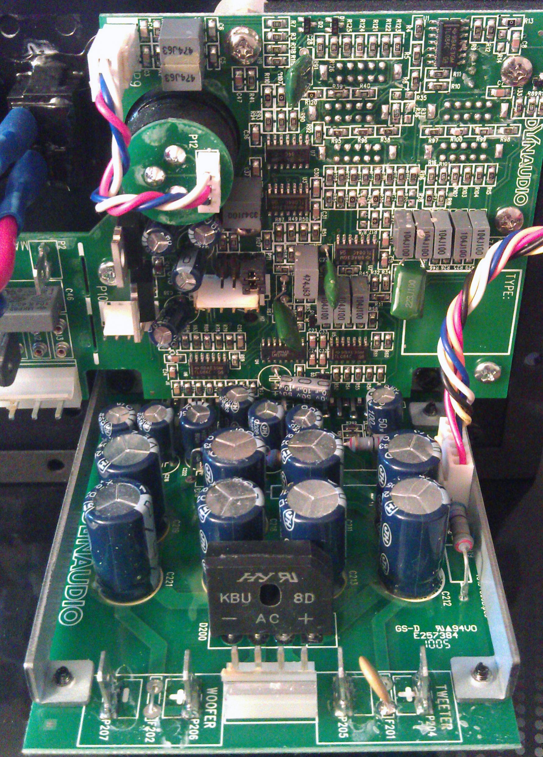

Thanks for confirming, this is my first diagnosis, and I am surprised that I even got this far! I will look at and around the bridge to ID the parts. It sounds like I will have to unbolt the assembly after all to get to the chip amps. Identifying what chip amps are being used will hopefully help. Thanks.
After the bridge, the seconderies go to a bank of caps rated at 35 V, then to a pair of LM3886. I suppose I need to go with whatever works best for these amps, and hope its compatible with the built in active crossover and filters. Any suggestions would be greatly appreciated!

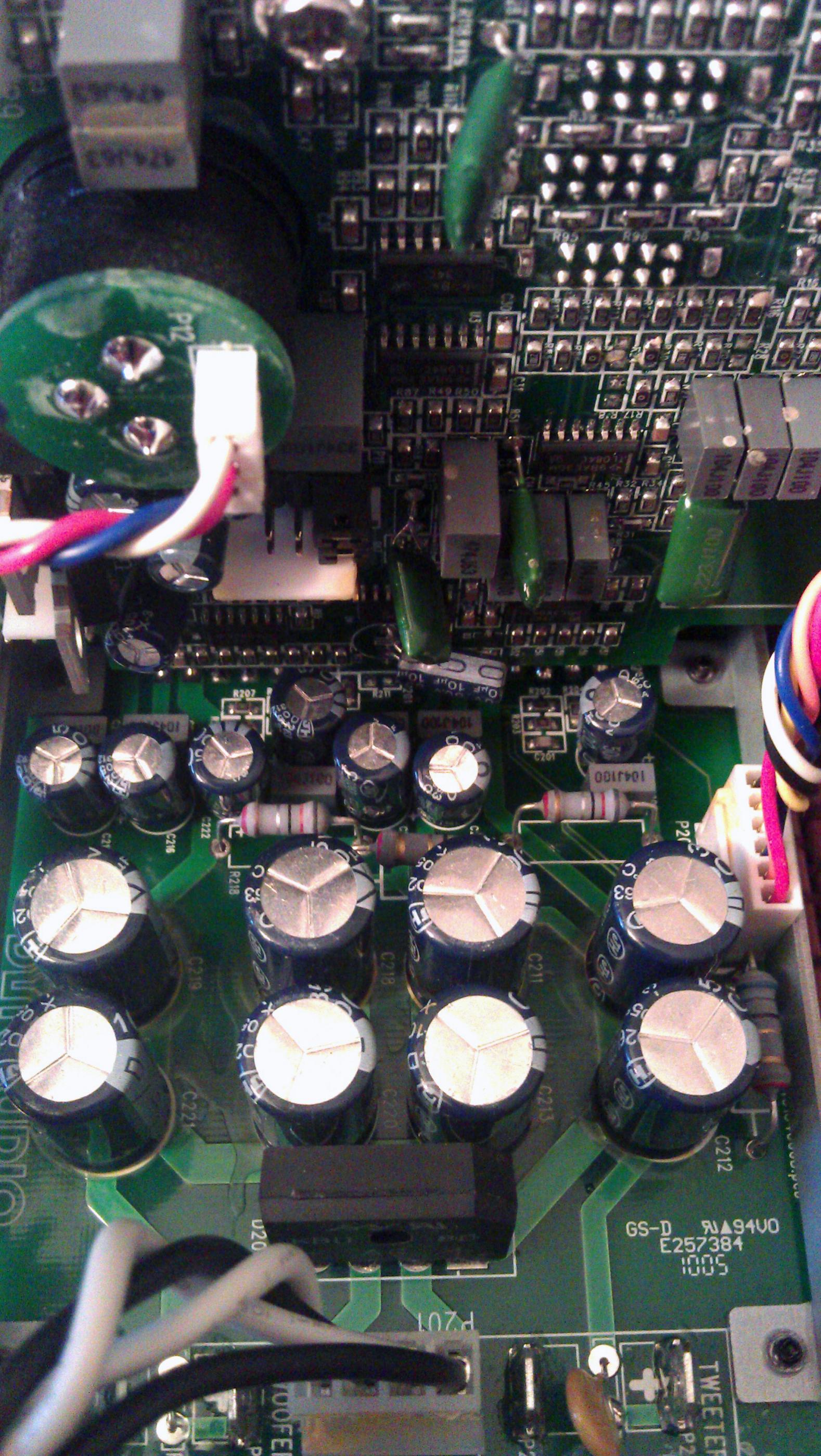

It might help to see pictures of the tranny and the PCB. For example, is it running on a single "up to 35 volt rail"or a dual rail of "up to -/+35 volts). Also are there any other rails derived from other windings ?

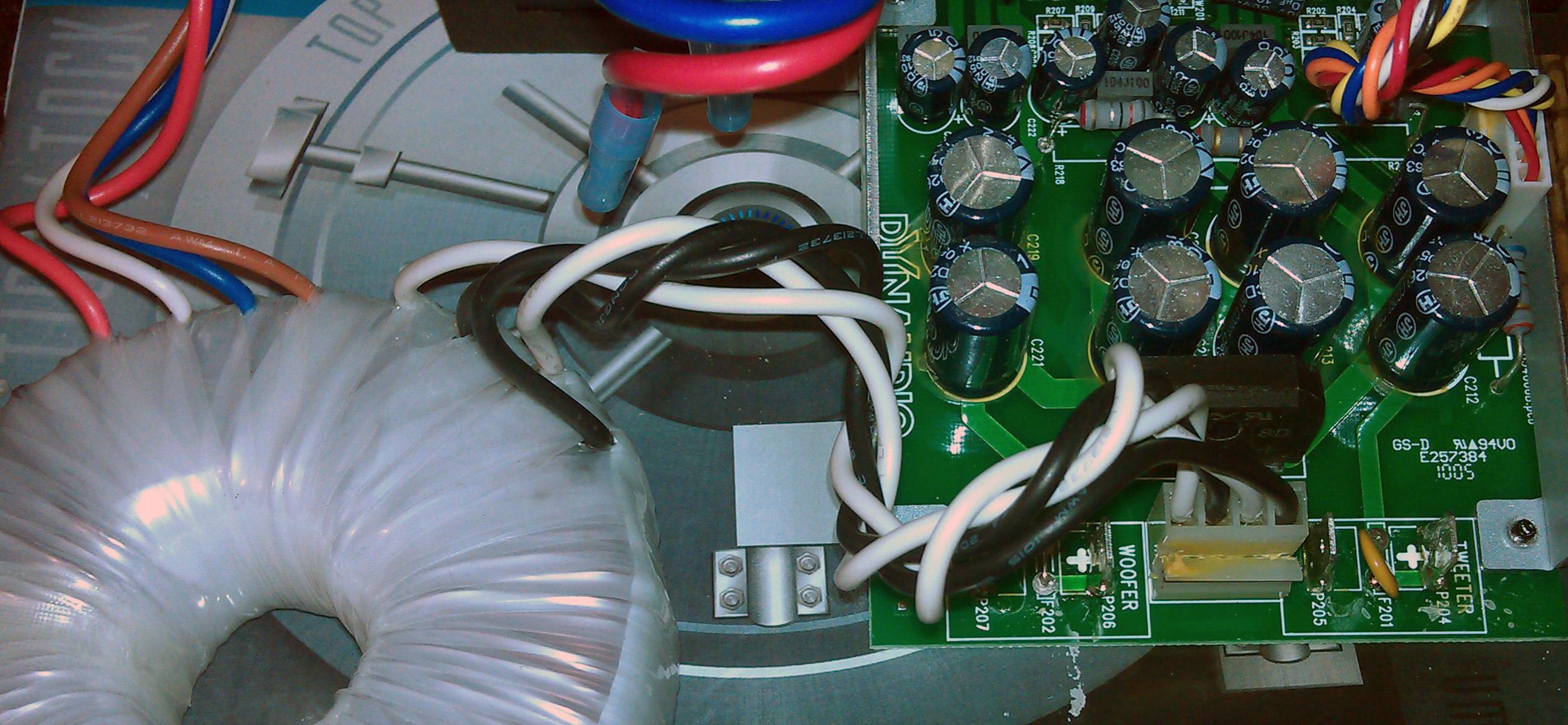

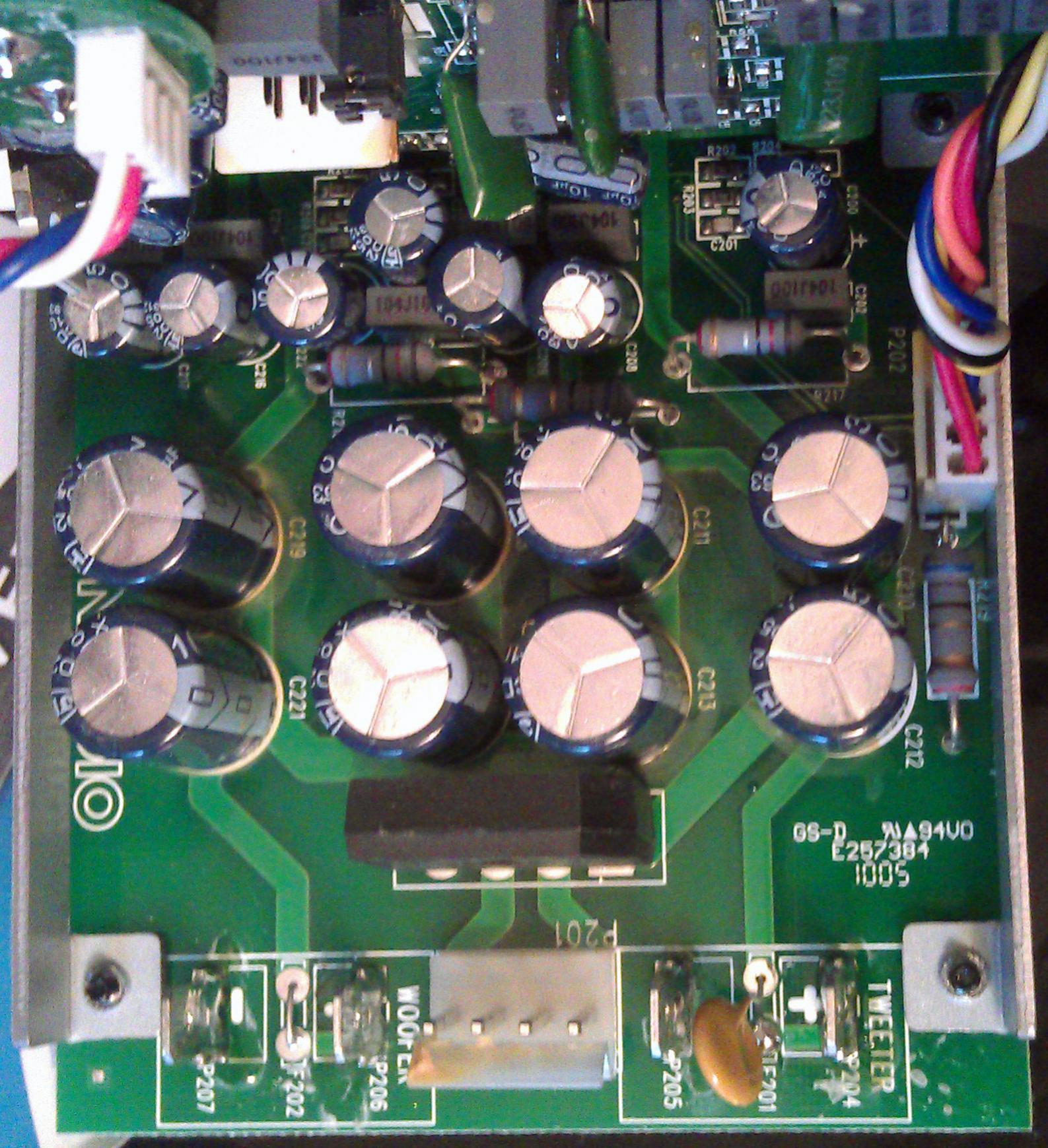

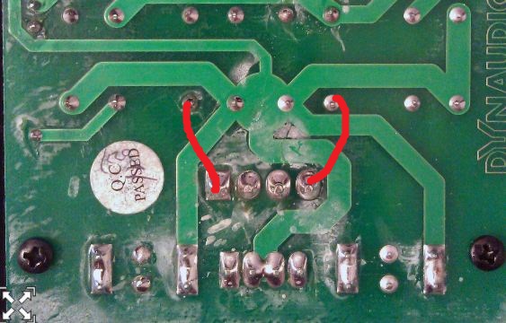

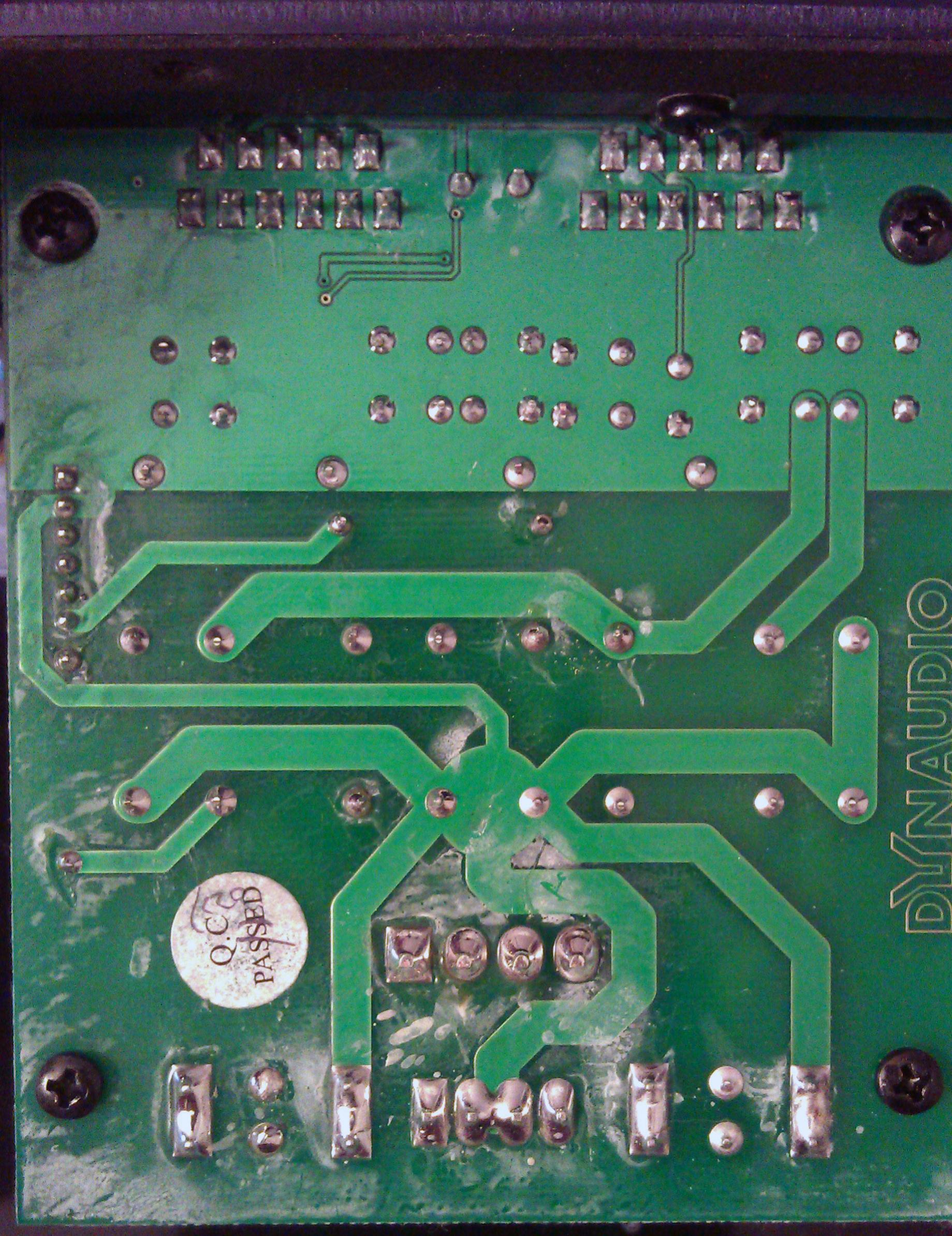

Here are some pics of the situation. My best guess is that there are 2 identical rails total.
My only concern about the primaries configuration is that it indeed invalidates my test with a meter, since all leads are actually connected, and a reading of continuity is to be expected..

It certainly looks that way. Can you confirm there is continuity here. Bit hard to be 100% sure looking at the pics. I think those eight caps are just paralled up in pairs. They must be :) I can see the outer caps link to the bridge and ground via top and bottom traces.
So each of those caps is 35 volts... yes ?
That means that 35/1.414 gives the theoretical max AC voltage per winding which would be 24 volts AC. That's to close for comfort with no safety margin. 18 volt is a common off the shelf value and would give -/+25 volts DC under load, higher than that off load, higher by the regulation factor of the tranny which could be 4 to 7% or so. Perhaps 27 to 28 volts DC.
So thats a real possibility, an 18-0-18
22 vac trannys are available but less common. That works out at -/+33 volts DC (ish) off load for a typical tranny. That's a bit near the limits of the caps.
Lets look at power output. 25-0-25 vdc would allow around a (guess) -/+21 or 22 volt swing into 8 ohms. Thats 21/1.414 which is around 15 volts RMS. Into 8 ohms thats 28 watts RMS. Does that fit in with any published specs ?
Next step is to determine the VA rating. If you measure the tranny dimensions you can compare with others,

Yes the caps are 35 V, and from the transformer part number I know it is 50 VA, and 13% regulation factor, just don't know the secondaries voltage. I have been able to acquire a second, working monitor, so I am thinking to just open it up and poke around with a volt meter..

The 50 va rating sounds small tbh but of course that depends on the units intended output. And your 13% regulation fits in with a small tranny. Small trannys have poor regulation compared to large.
I think the 18-0-18 is a real possibility here. The link I gave you shows a 50va one at 76 by 30 mm. How does that compare in size to the original ?

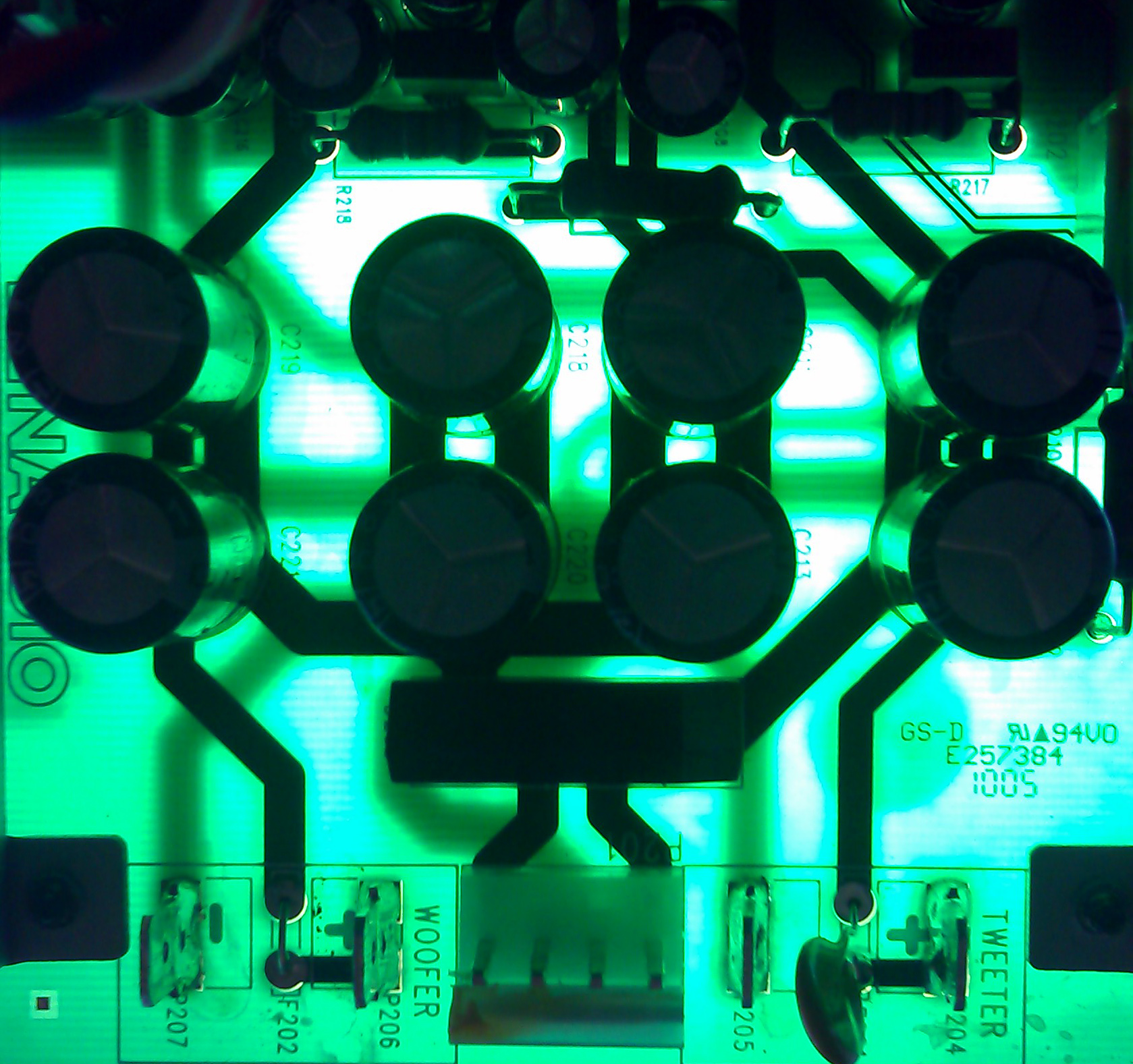

Here is an "X-Ray" of the circuit board. The output of the unit is 2 x 50W RMS, that is 50W from each of the LM3886. Of course, that's according to Dynaudio marketing literature, so who knows..

Hmmm... you can't get that output from a 50 va tranny.
OK, here's an 85 by 41mm that is 100va. The figures 50va and two times 50 watts RMS just don't add up. Voltage wise it could reach the required swing for 50 watts RMS into 4 ohms on an 18 volt tranny.

As you have have access to a working unit then you really should measure the AC voltage from the tranny as 100% confirmation.
We've made a best guesstimate... and there's no problems with the figures we've used, but it would be nice to know for sure, particularly as you actually have a working one. For example, did they really push to the absolute limits and use a less common 22-0-22 tranny.
Yes, open op the other unit and do a measurement of the AC voltage.
Best is actually to disconnect the transformer on the secondary side, to get the non loaded voltage rating.
If you end up with needing a voltage which is not available, you can use one with a little less voltage rating, and make a few turns yourself, connecting these ins series with the secondaries to get the desired voltage (that is of course if it's a toroid :))

That sounds like an 18 volt tranny. Offload and the voltage rises by the "regulation factor" of the particular transformer. The one in my link was 8% so that would give around 20 volts off load. And that was a 100va tranny. Smaller one have worse (higher percentage) regulation.
Its an 18-0-18 :)
