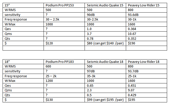

The drivers I have been looking at are: (For 15”) Podium Pro PP153, Seismic Audio Quake 15, (For 18”) Podium Pro PP183, Seismic Audio Quake 18, or Peavey Low Rider 18 (only $5 more than the Peavey Low Rider 15 so I would buy the 18). Obviously I would jump all over the Peavey’s If I could swing the cash for 2 of them, but I’m sure I can’t .
I would like to build 2 subs, so The Seismic audio Quakes are looking good because at $140/pair for the 15’s and $190/pair for the 18’s they cost less than a single equivalent (in size) Peavey. However would a single 18” Peavey Outperform 2 Seismic Audio Quake 15/18’s? . How about the Podium Pro speakers? Has anyone used the low frequency ones? I have a set of PP121’s and they are good (for $25/ea) but have no experience with the bigger PP1X3’s, they cost quite a bit more, and I can’t find a lot of specs on them. I should be able to swing 2xPP153’s maybe 2xPP183’s, but hate to risk if no one can vouch for them being better than the quakes.

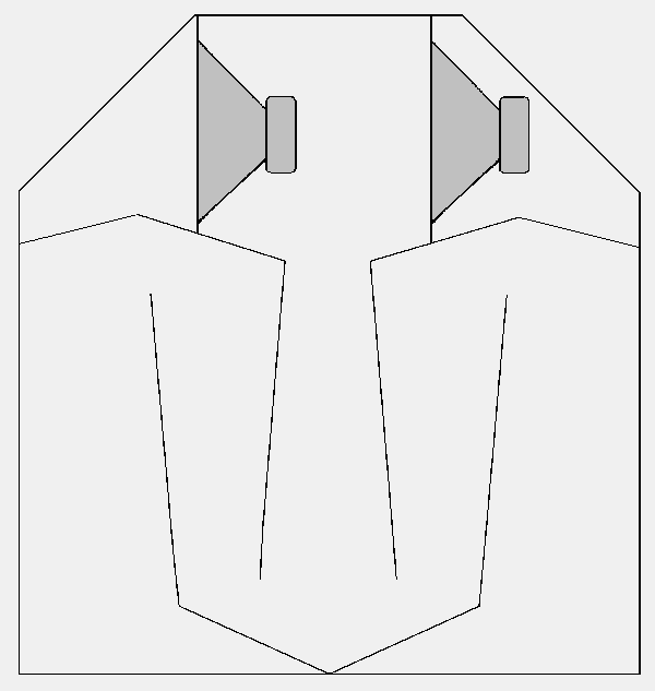

This is the cab design I was looking at: (Speakerplans.com) it looks like a simple/easy enough to build design with good frequency response. How would it scale down to a 15”? I have plenty of wood (combo of MDF and plywood) lying around to build 2 of these.

Thanks, I will attach the Specs I have for each speaker.

Something to keep in mind is that money spent on woofers which burn out is money that's gone forever. Better to spend too much than not enough.
There's not much down at 30 Hz, let alone 20 Hz; 40 Hz is enough for ground shuddering bass. But, reproducing those low frequencies requires moving a lot of air, and bulky enclosures. There's something to be said for ignoring the low bass and just concentrating on getting a really loud punchy kick drum. Try a bandpass box tuned around 80 Hz.
None of the Seismic Audio woofers are worth buying, the Podium Pro stuff doesn't look any better.
"How would it scale down to a 15”?
You don't. This design requires a specific driver. The one specified has a special cone to stand up to the BP6A design, substitutes will quickly die, and not work as designed anyway.
PP153
(Sd)889.6
(Fs)43.7Hz
(Re)5.3Ω
(Qms)22.97
(Qes).70
(Qts)0.68
(Le)0.62mH
(Vas)143.5 Liters
(X-Max) 8 mm
PP183
(Sd)1257.0
(Fs)36.8Hz
(Re)5.2Ω
(Qms)14.44
(Qes)0.73
(Qts)0.69
(Vas)253.7 Liters
(X-Max) 8.5 mm
Even if your gave me some drivers from Seismic or Podium Pro I wouldn't waste my material or time on them.
OK, so I take it you've had a bad experiences with Seismic Audio, It just seemed like all the reviews I read about them were pretty good. Anyway, Moving on.

Without a DSP I would stick to bass reflex designs, the lowrider has good specs for the price and will destroy the pyle subs, you could build one now and use it with the pair of junk subs and add another lowrider box later.
It is worth building a decent plywood box for them "but" after you add up all the hardware bits/finish DIY will have a hard time competing with used mass manufactured boxes. Used Peavey qw118 boxes which are loaded with the lowriders go for around $400 BTW and you can probably sell them for that if you ever need to.
The Seismic subs are probably a step up from the Pyle but without accurate TS parameters (x-max specifically) I can't recommend them.
You can get a complete 18" sub from SA for $250 shipped! (That is less than I could build one with mediocre drivers!) It is probably comparable to anything else out there "in that price range" but not anything spectacular...
