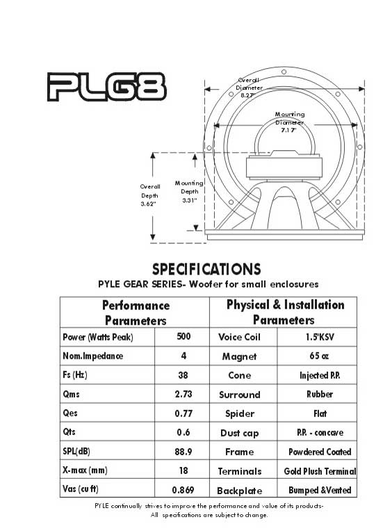

Can i use this driver for home subwoofer?
Can i use this driver in the attached image for my home subwoofer?
Another woofer
Im planing to use it for movies and music in my bedroom.

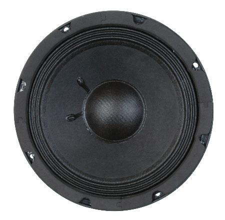

I have these 2 drivers in my closet. I want to do something with them. What are thy good for?
Will this one work better?
The first driver, if it's specs are correct, is a much better candidate for a sub woofer.
The second driver, with an Fs of 68 Hz, more than an octave higher than the low note on a 5 string bass, would be considered more of a mid-bass candidate by most sub folks.
I have another driver with this specs:
This driver is a pro driver with a high Fs (68Hz) not good for a subwoofer.
It's a "Full range speaker" "Ideal for sound reinforcement, monitor and musical instrument use" and "Optimized for vented enclosures". You can have it in a BR 22L/45Hz and F3=46Hz (38Hz in room) or crossed to a subwoofer @90/100Hz in a sealed box ~20 L.
