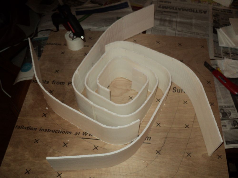

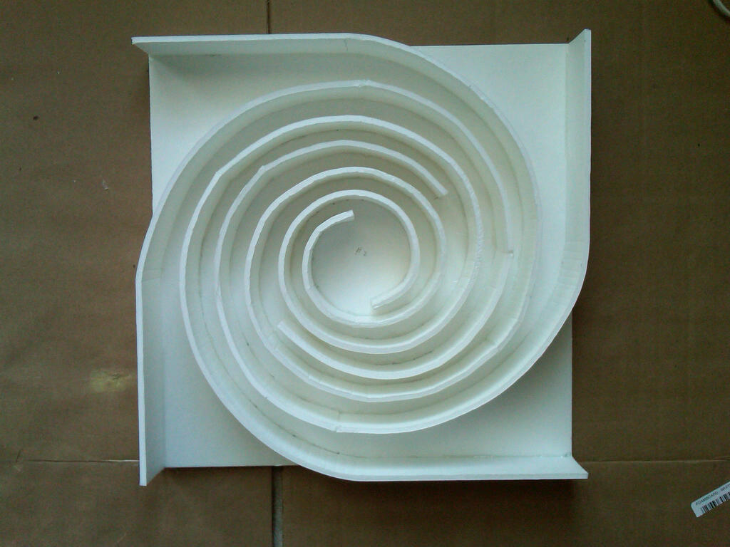

It's been a long time since a speaker project has been this fun, rewarding and quick. I admit my hopes were not that high to start, but my mind has changed completely regarding the materials used and the overall effectiveness of the project.

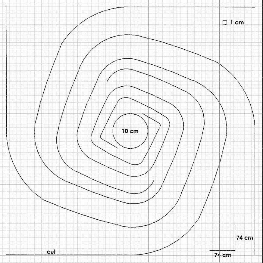

They have been coined the 'Cornucopya' Here is a site with the drawing. It is also in the next post.
seb:diy:audio: Cornu Spiral Copy Horn
Enjoy.

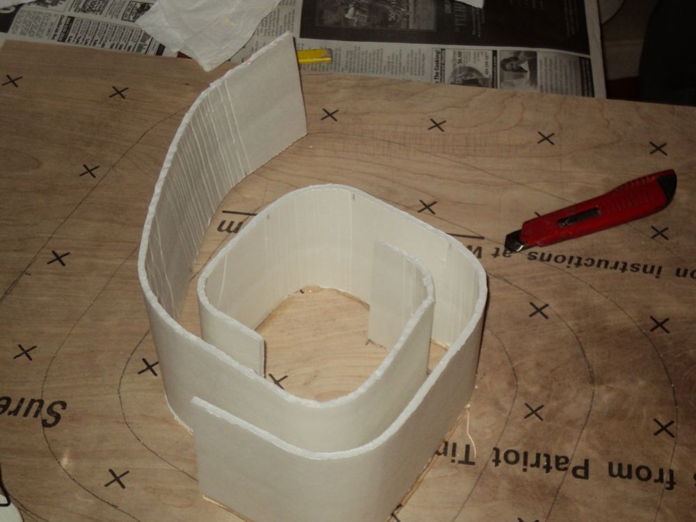

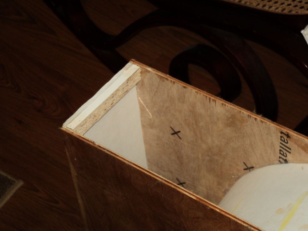

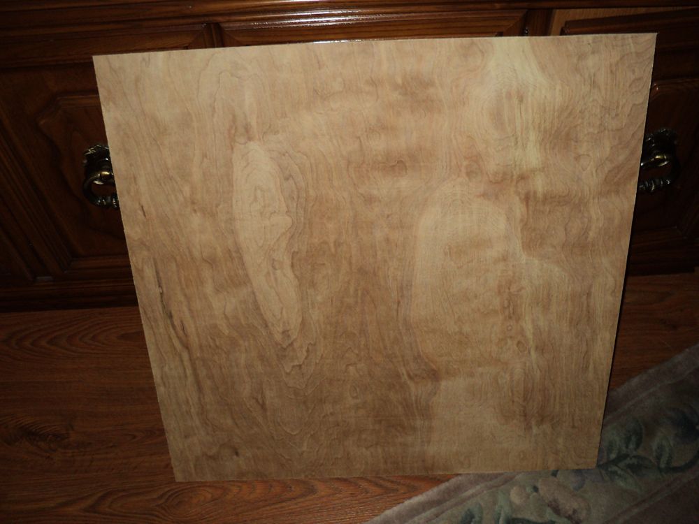

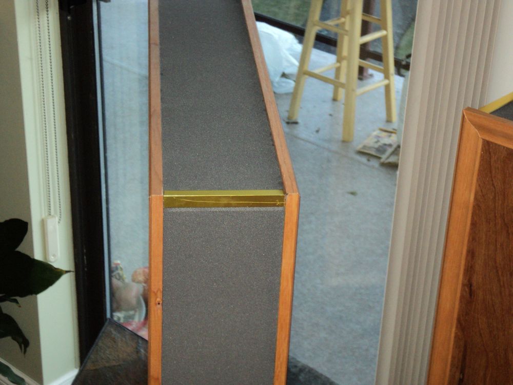

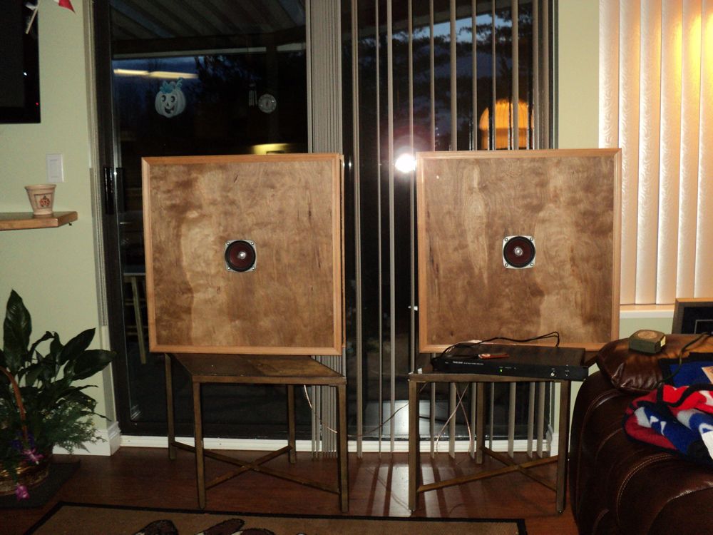

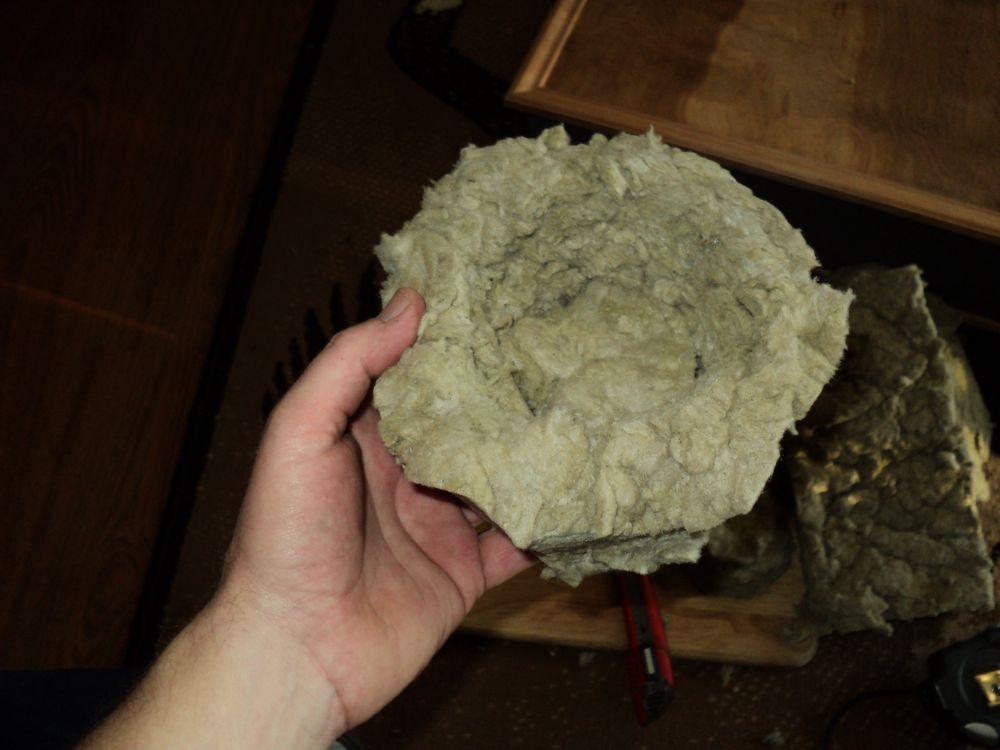

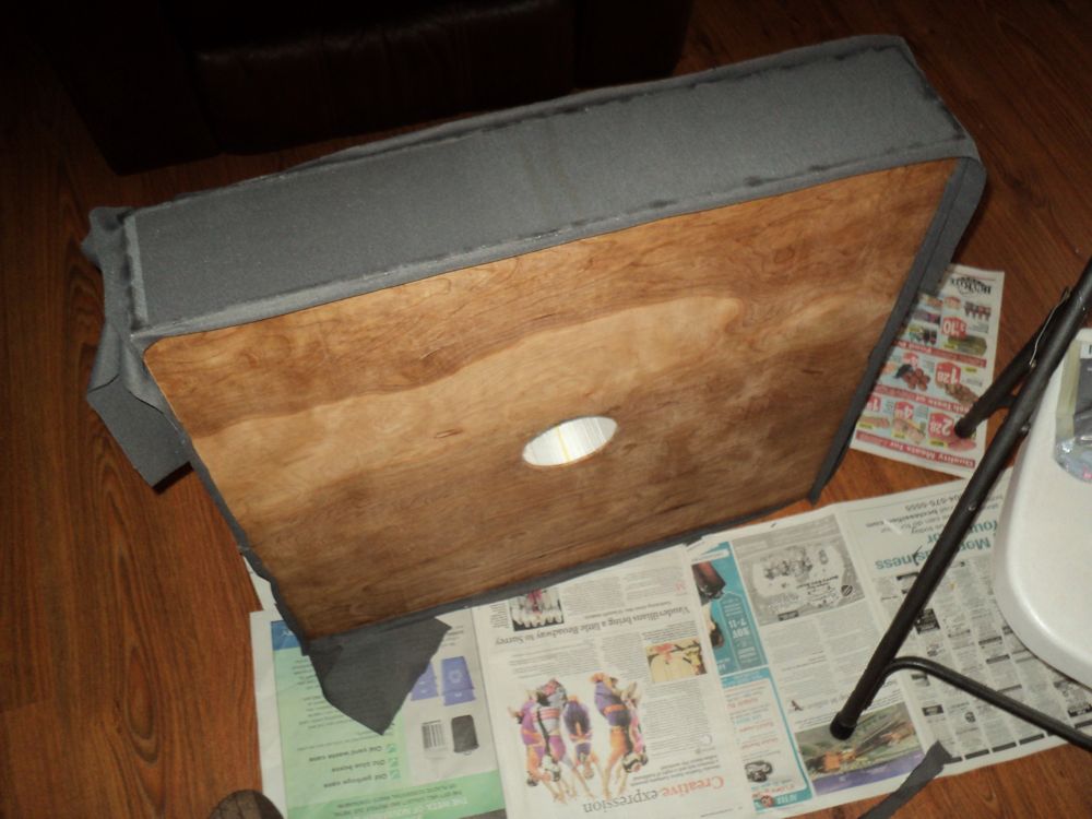

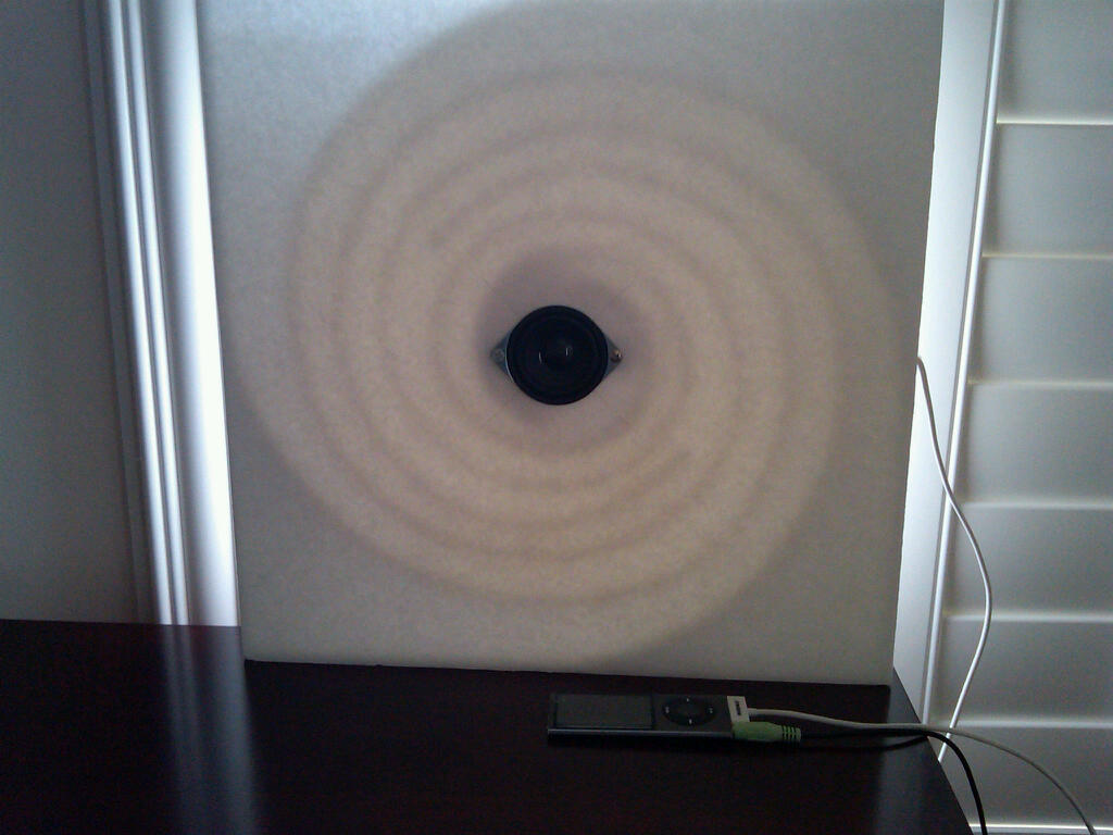

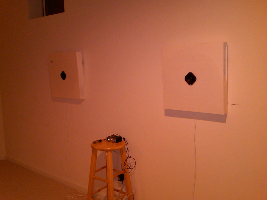

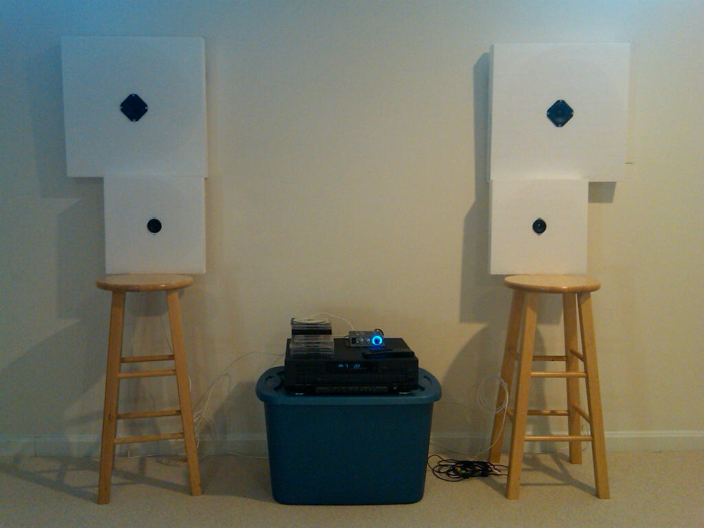

The sound these produce is beyond my descriptive abilities. They have no business sounding this good.
[Never mind the string of glue on the brass edging in the second pic, it's not a scratch.]

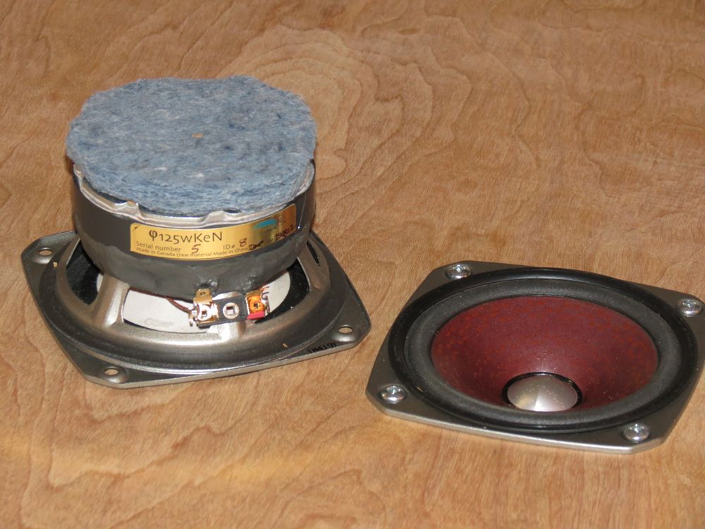

The driver for this is the Fostex FF125WK with all the treatments by planet10.
Mr. Daniel Ciesinger, I am in admiration of your design.

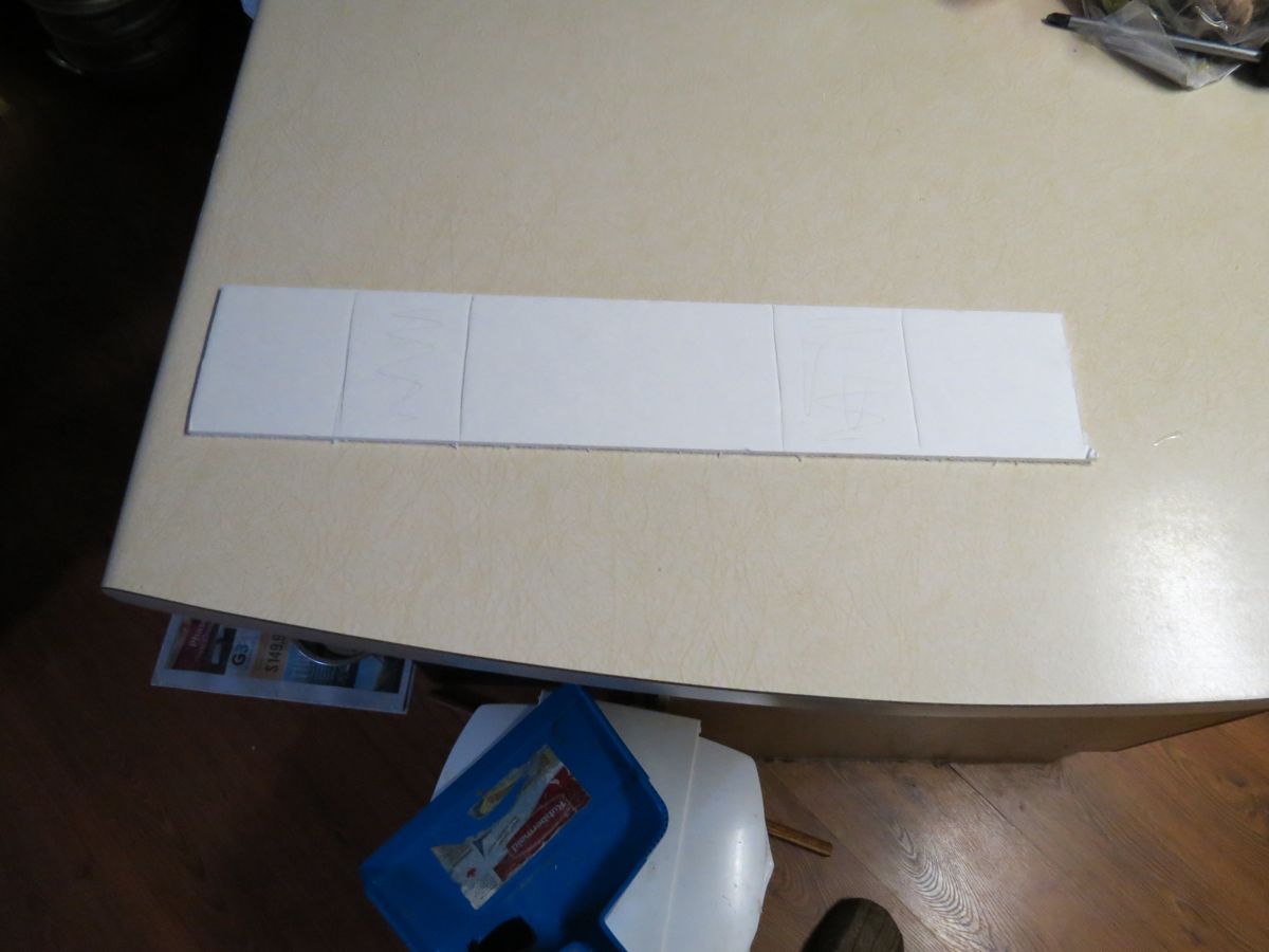

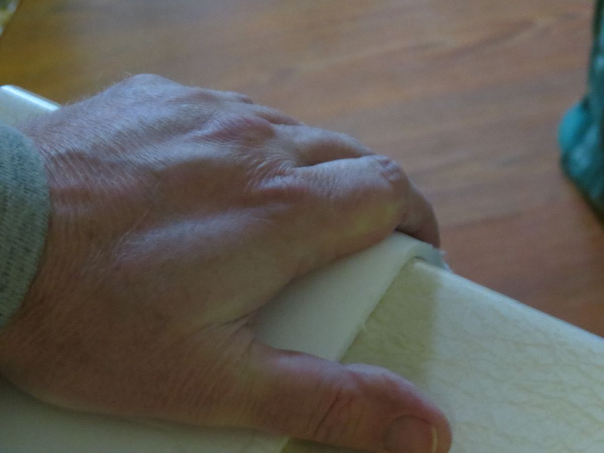

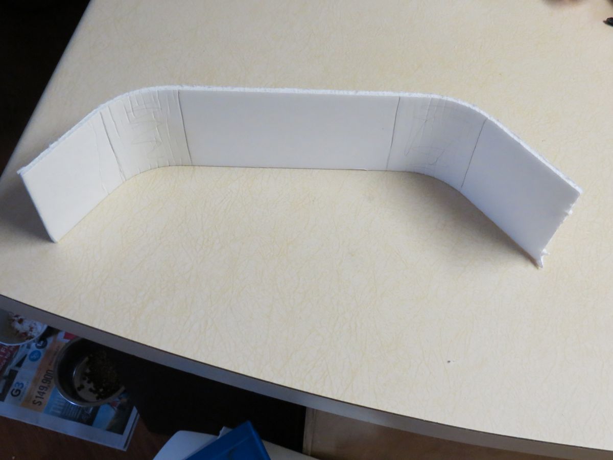

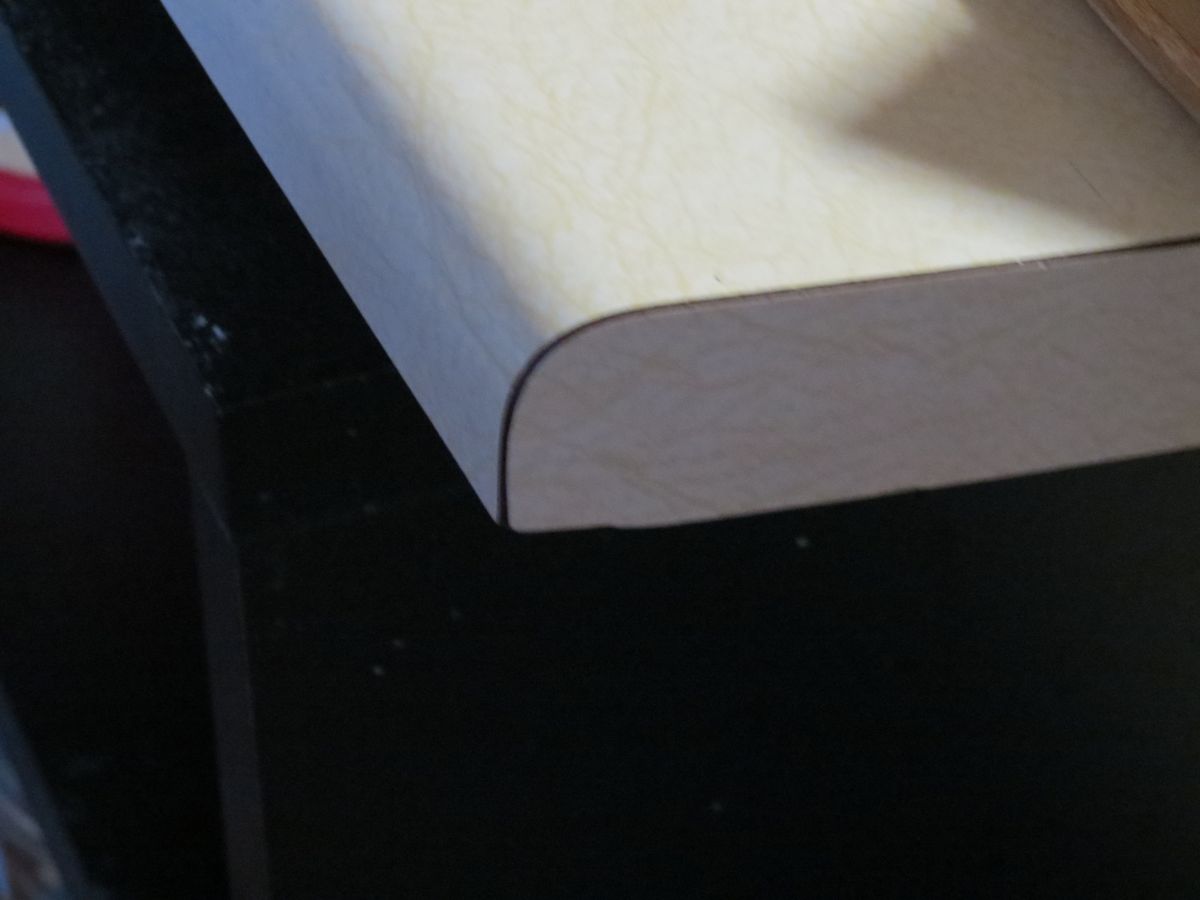

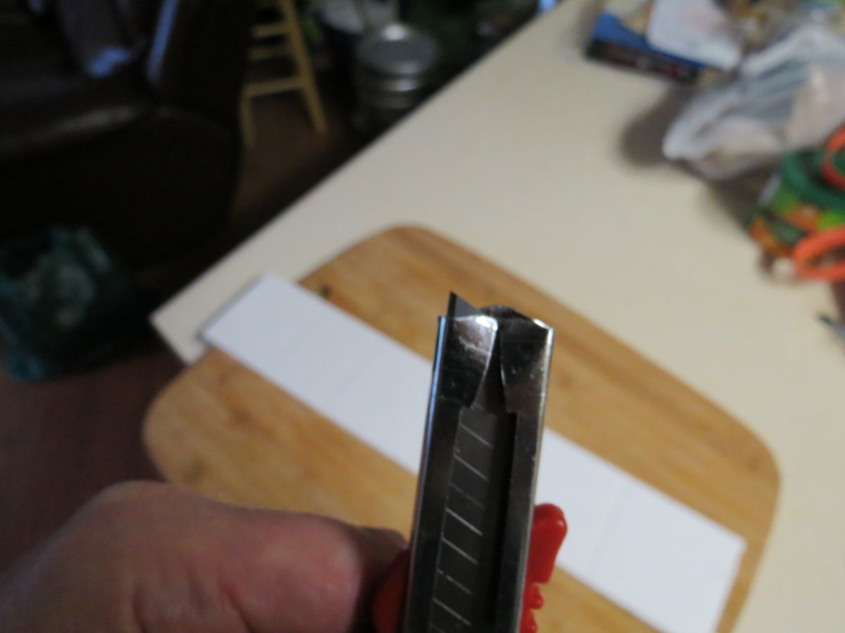

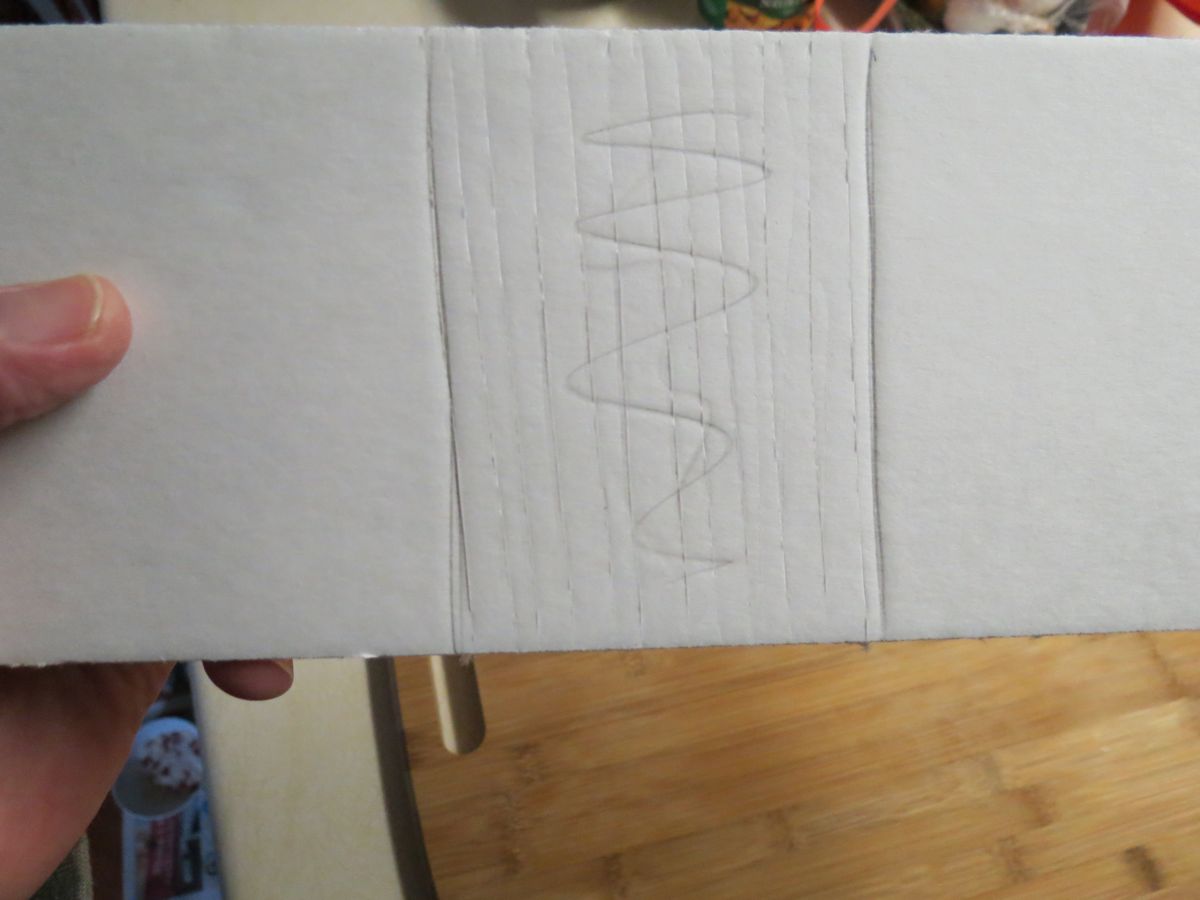

EDIT: There are those who wanted to know more about the foam shaping so I am adding those pics as of December 12, 2013. Starting with the strip of foam pic.
1. Mark where you are going to make your curves
2. Set you knife to about half the depth of the foam
3. Score it freehand about 1/4" or 5 cm plus or minus depending on the radius of the curve
4. Find your rounded surface. Mine happens to be the kitchen counter
5. Form it over by rubbing back and forth and adding a medium amount of pressure
6. The forming will help when it comes time to glue

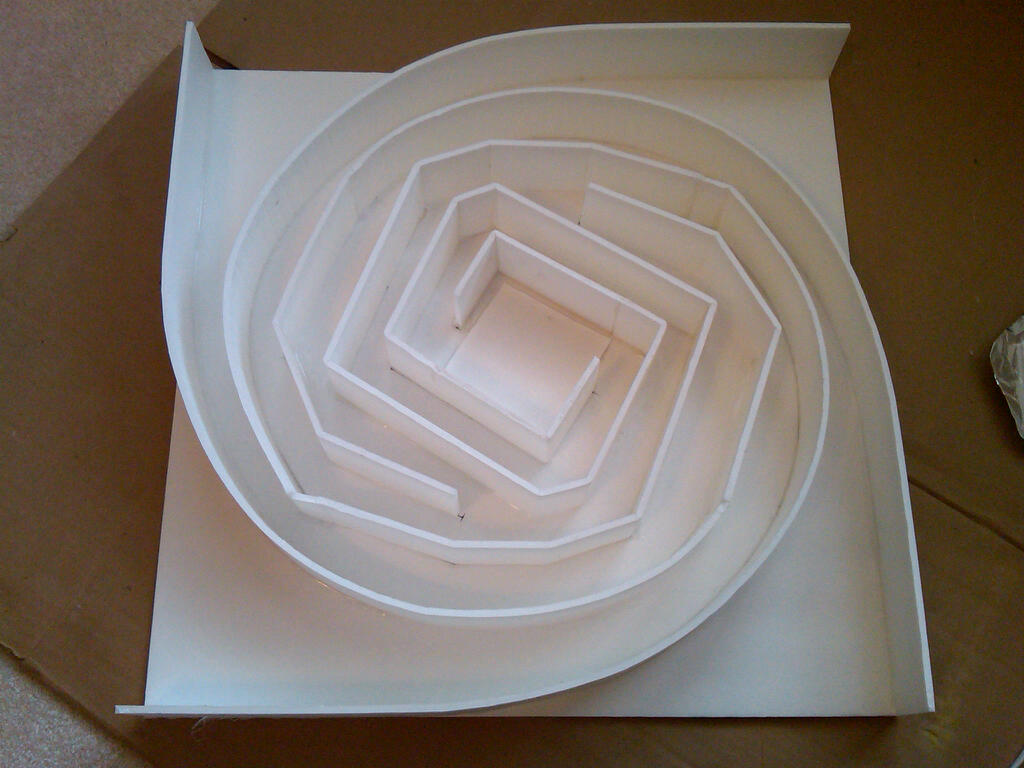

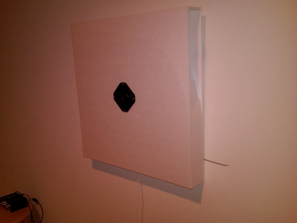

I have Cal to thank for being an enthusiastic seconder to my build which all started out with an all foam core board (paper faced) design that I wanted to allow me to quickly build new horn designs without cutting any wood. I used the boards that I got from the dollar store, a razor, a ruler, a pencil, and a hot melt glue gun to get started. You can do this project on a kitchen table in a matter of several 2 hour stretches of time. The cabinet I built felt so light and open, my expectations were not high as to the sound. But upon first listen: it wad literally like an epiphany, the trumpets of the heavens sounded ok, maybe that is too much but it was close to that. Anyhow, the sound is almost magical, so ethereal, open, fantastic imaging, full, good bass, great mids and highs, wide sweet spot, and just makes you not ever want to stop listening.
This project has several options: you can pick a size full (75 cm), mini (50 cm), and micro (36 cm). They use circa 5 in, 4 in, and 2 in drivers, respectively. The bigger one takes more time and uses more materials, the mini is a good compromise if you don't want to spend much but still want knock your socks off sound. The micro makes a fantastic bedroom or office speaker. The mini can be built for less than $40 in materials. The sound quality is unbelievable. Finally, the WAF is off the charts. Enjoy!
