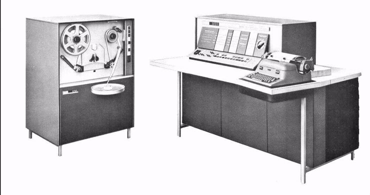

As a side note: what I read about it brings warm memories.
When I started studying Engineering (1969), I also programmed in Fortran, punched the program on paper tape (much cheaper than cards) , and run the program in an IBM 1620 such as this one:
