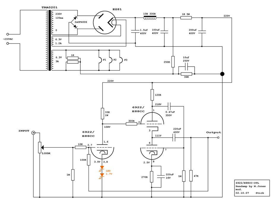

The Morgan Jones mini tube headphone Amplifier

Thanks Stixx, I'm currently using the Valve Wizard mu-follower, I'm satisfied but I received advice that my Senhs HD600 plays better with an output impedance of 120 ohms, the mu-follower I'm using have an output impedance of 257 ohms so to big also I know HD600 have an output impedance of 300 ohms so the question is: wich value of SE output line transformer have I to install?, mu-follower schematic:
Joined 2009
I once built a version of this amplifier - using a triode-connected EF86 on the front end, but with the same 6922 back-end - I did use electrolytics on the output, bypassed with Dayton polypropolenes. Really, it sounded quite good and certainly changed my mind about the "sound of electrolytics". If I remember correctly, I just used some Panasonics from Digikey.
I eard people used EF86 for MM phono preamp with great success.
After the pot would be better, between the slider and R1. The value would depend on how big you are prepared to go with the other electrolytics. The basic idea is that the input LF rolloff, set by the cap and R1, is higher in frequency (by a factor of 2-5?) than the output rolloff, set by C4 and your headphone resistance. Also the cathode decouplers.
You also want the White follower to work properly, so the input cap should be less than C2.
