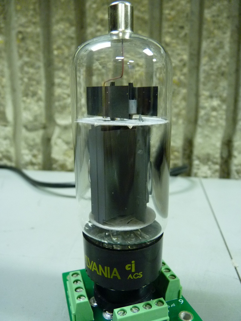

I looked at my stash of 6BG6-GA. It appears as though the ones I have are the large plates. The only thing is they have the side getters. But other than that, they have the large gray plates as shown in the attachment.

Here is a photo of mine and a link to the photo I was comparing it to.
The plate in mine looks identical to the large plate version, although the getters on mine on on the sides instead of the top.

Can someone please help me to verify if these are indeed the large plate variety? I'm beginning to think not.
Although they have the side getters, they have gray plates, and the plates look like the super version. The imageshack link shows the large plate version.
Post #12 in this thread has the photo of mine.

Your imageshack photo... the tube on the left is the hefty 6BG6GA. The one on the right I wouldn't trust because I have had them red plate.
I have run the 6BG6GA in both my Dynaco Stereo 70 and my Quicksilver 8417 mono block amps as well as an amp that I built from scratch. I have never run triode with them so I cannot comment on how they sound in that mode. I have run them at almost 500 plate and 55mA without problems.

I can tell which one the large plate device is in imageshack photo, because it's the one with the large plates.
My question is: Does the one I have shown in post 12 have the large plates? They are grey, and they appear to match, but my tube has the side getters.

Yes, we've been over that. I understand, but I did not mention post #8.
If you re-read my question very carefully you may notice that I mention the photo of the one I have is in post #12.
Notice that it says post #12, not post #8. It doesn't say post #8.
Maybe another way to ask the question is:
Does anyone know if the large grey plate 6BG6GA were ever made with side getters?
Notice the the upper and lower mica wafers in the the one I have are like the large plate version.

Your post #8 shows the grey plate on the left and the black on the right.
The tube on the left the gray plate one is what you need. At $12 ea from vacuumtubes it only makes sense to buy new.
