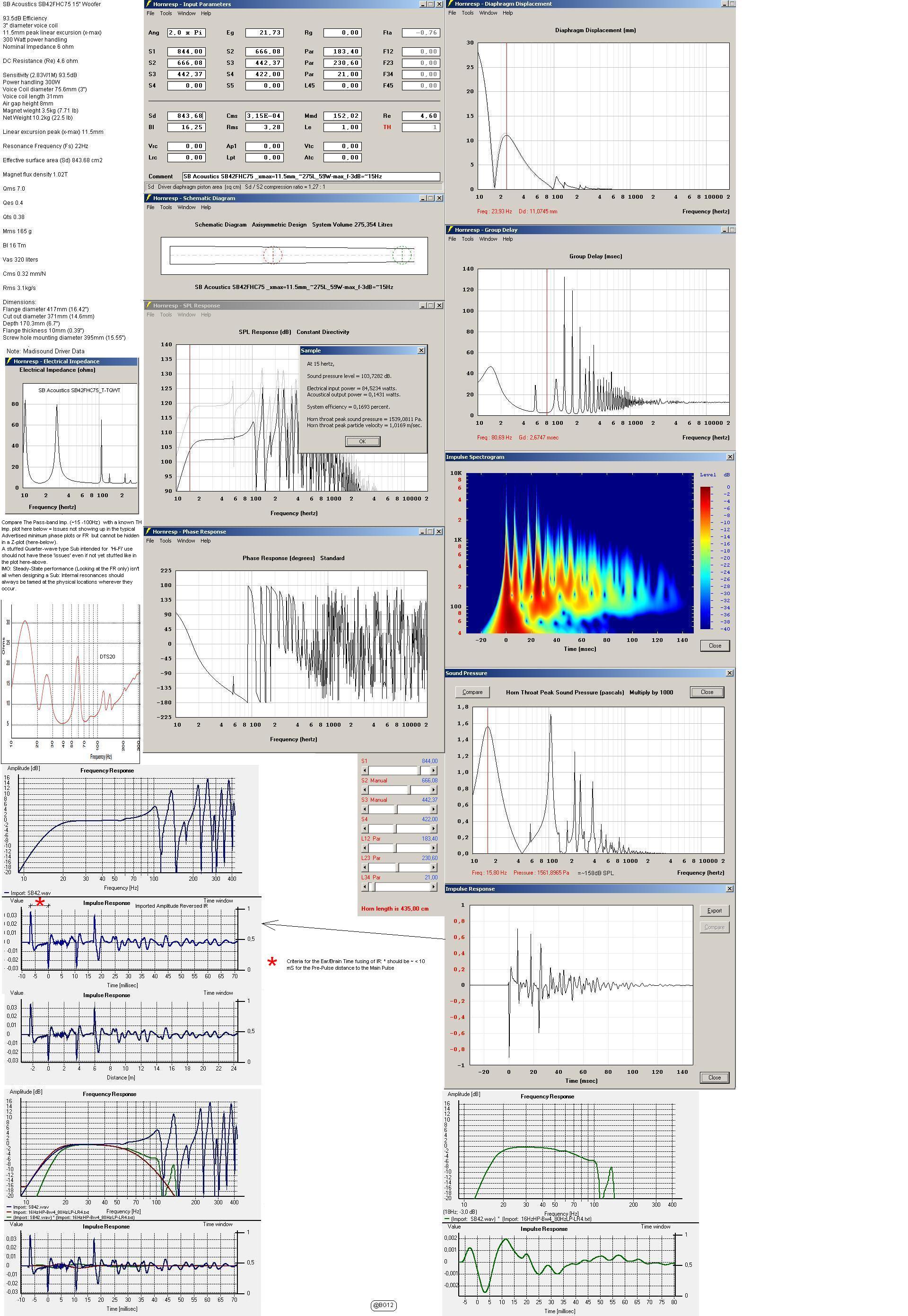

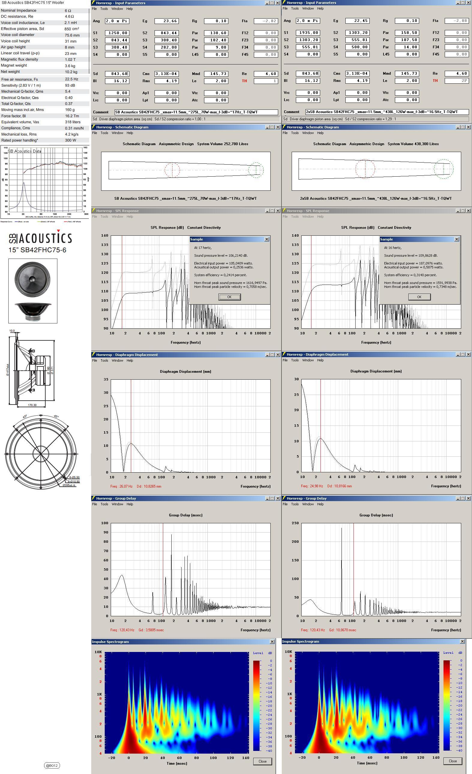

Hi Tordenguden,
:eek: Only looking for a place to land these suggestions:
b:)
PS: They too would add an 'image', like subs that don't exist - like they should.:D
