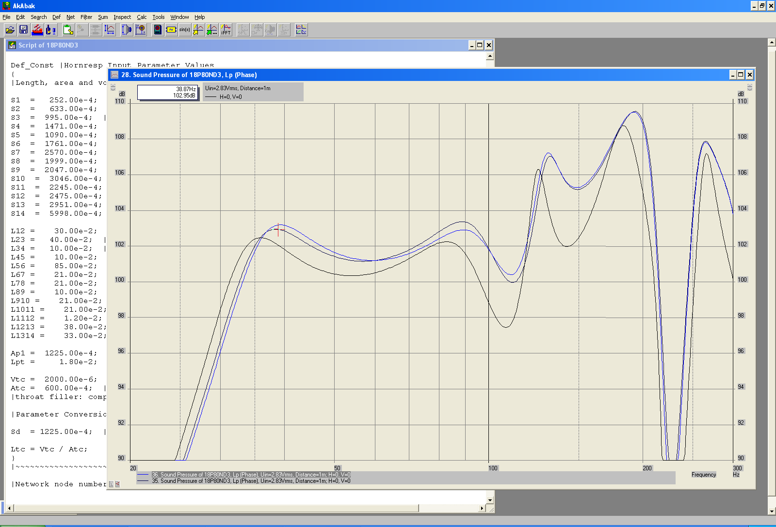

Finally I think I was able to translate this design into akabak. Here's what I've come up with:

I tried to take the corner bends into account, but I'm not sure I did it correctly :smash:.
Here's the graph:
Any suggestions are welcome ;)

hi thijs
i'm not an akabak guru,but is see some flaws.
vtc should be about 6000 and atc 600,from L45 on,all segments are labeled "4"
but somehow the graph seems right.
i think in reality the low knee is giong to be closer to 40hz.
there seems to be a horn spreadsheet floating around on this forum.
but there's always a human brain drawing program interface needed:D
Oops, forgot to correct the labels (you can see which part I copy-pasted :) ).
vtc 6000? Isn't this 18mm (baffle thickness) x Sd?
And atc isn't equal to Sd? So the baffle cutout should be smaller than Sd? I thought both values were supposed to be the same as I put them in hornresp? What am I missing?
I've found that horn spreadsheet and fiddled around with it. This is as far as I've gotten with it (see zip).

hr see's a driver as it were a flat piston,if this was the case your inputs were correct.
Volume Throat Chamber of an 18"(volume of the cone)=aprox 6 ltrs(6000cm<3)
Averidge Throat Chamber is about 600 ,so the lenght Throat Chamber wil be about 10 cm.
vtc/atc=ltc
you use lpt1/ap1 for bafle opening wright,i normaly ad the volume of the bafle to the vtc.
so vtc of 8000 and atc 700 comes closest to realety,without the ap1/lpt1 inputs.
it wont make a difference in the spl graph
vtc/atc=ltc
Ok, thanks. Got it :worship:

I have to admit I don't like it that the sensitivity now is down from about 104dB to just over 100dB per watt :(. And there's a 3dB dip at 108 Hz. The T48's (of which I own two) claim to do the same and even more starting from 50 Hz in a lot less space using a 15"... :Ouch: Back to the drawing board :headbash:.
you got it
Wel hofmans law says pick any 2 of the 3 low,loud and small.
in you sim it extends down to 35 hz,shortening the horn/bigger mouth wil tune the boxer higher ,resulting in a higher efficientie.
changing layout wil not give you more eff.
however whe could try to decrease the dip.
edit/if you would inverse the driver dip gets smaller.eg make s2 ~550 and take away the throat chamber and port
decrease s3 ,s4 and s5 -250
increase the mouth to 6000
Already did that. I also reduced S2-S5 (easy to do by modifying the angle of the baffle). The blue graph represents the latest alterations, the bottom black graph is the starting point.
Still a quick & dirty sim, I haven't recalculated the lenghts of the horn segments...
here is a scetch
simple design.
easy tuneable by cutting off the front bafle (red)eg mouth gets bigger and the hornpath shorter.
