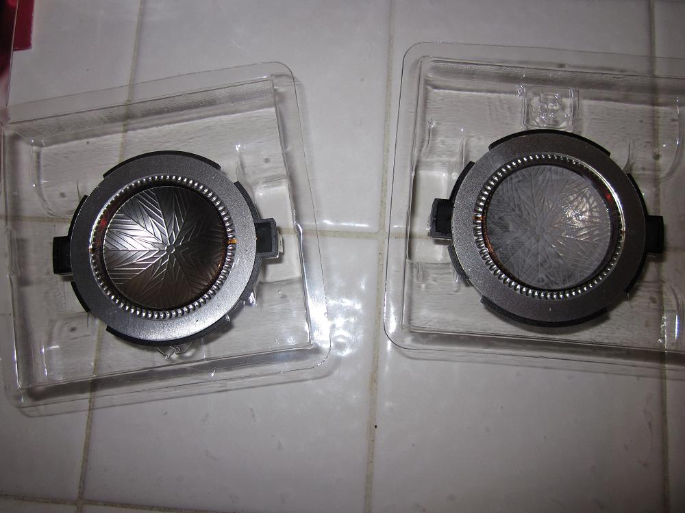

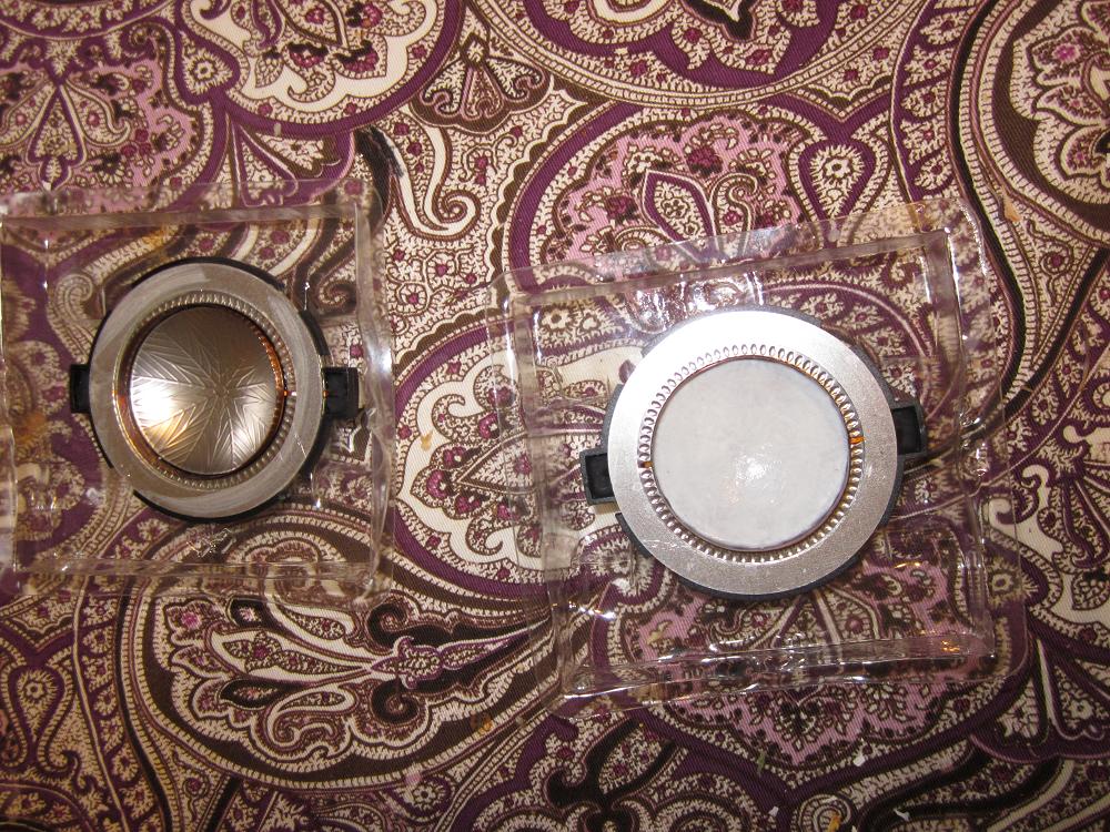

Has anyone removed the screen from the D220Ti's? I am guessing it is there to prevent prodding fingers when mounted to a horn, but behind the dustcap, they should be safe. It is pretty thick wire, so I am concerned with dispersion.
I removed screens from D2500Tis, I assume the 220 is mounted similarly. Removing it will leave a lip which you'll want to smooth out, you can just use any filler you want that'll stick in place. You may wish to get some reticulated foam, sold for aquarium filters, and make a little insert for the throat, as this helps SQ.
I also coated my phragms with a thinned combo of tacky glue (foam glue, but aleene's tacky glue would work here too) and talc. Lots of thin coatings, and this made for a much nicer top end.

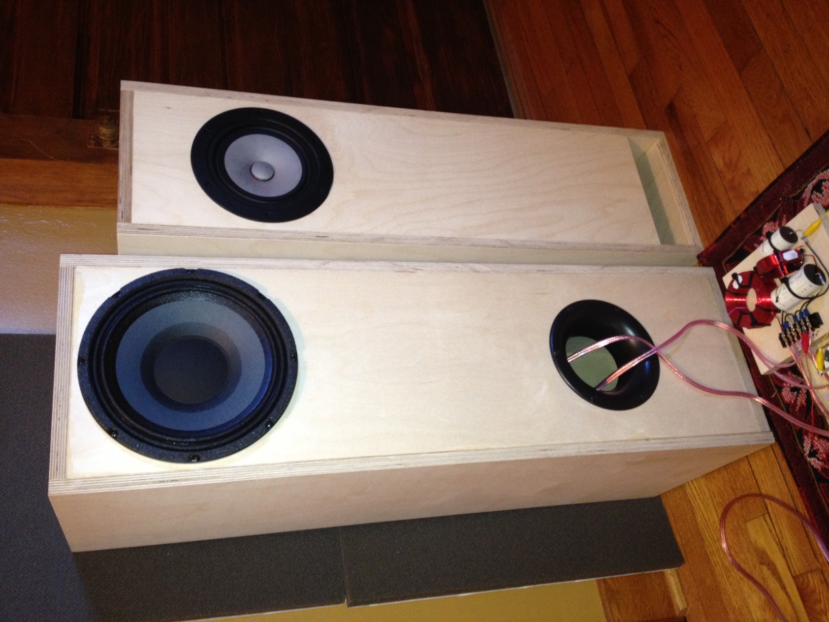

So funny story ... I kluged them together the other day to listen and the bass was unbearable! I was worried I'd have to do extensive mods to the cabinets to keep the resonance down.

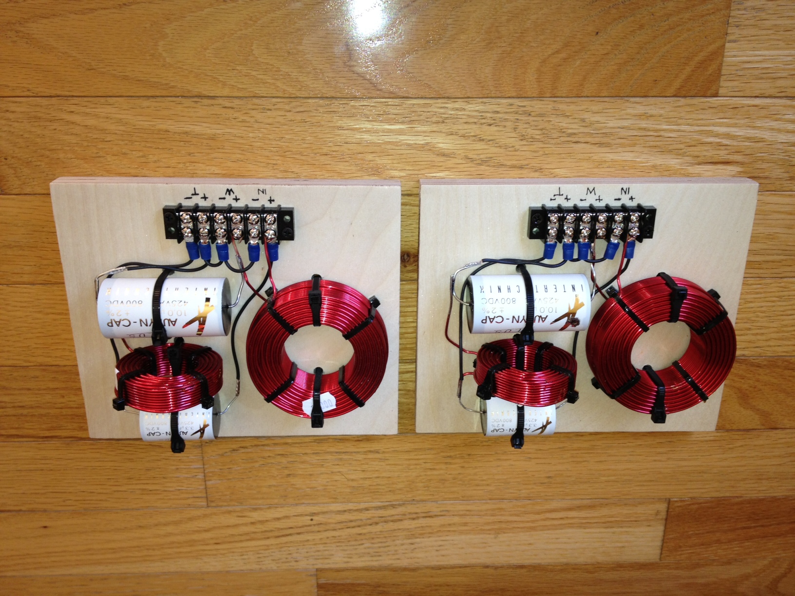

Today I finished the crossovers (pic attached) and wired them back up. They sound GREAT! The bass was not at all overpowering and they were very neutral.
I can only assume that last time I had the woofer polarity reversed?
Anyway, long story short ... they sound GREAT! Next step is damping the cabinets and adding the terminals and L-pad.

Oh yeah, I see it now. Really I was just prodding you to give more details about how you came up with the crossover ;).
Gotcha ... well I had designed one with the Excel spreadsheet and then I contacted Eminence. They forwarded my e-mail to a tech that built a "bookshelf" version of the 10" BETA 10CX with the Eminence ASD-1001. They hand tuned it on a spectrum analyzer for 2 weeks. He sent me the schematic and it is basically what they are selling as PXB2-2K5CX except that I left out the protection bulbs and am using an L-Pad instead of the fixed resistors.
Basically, it is a 2-way, 12dB/octave, 2500Hz crossover. I am not sure which slope they are using as the component values don't match what I get using the Excel sheet for any slope. BUT, when I plug their values in, I get a perfectly flat response!
I then took their values and using only air core, low DCR inductors and quality film caps ... Viola!
I listened for a few hours yesterday and am quite impressed with the sound. They are "loud" but not aggressive. The L-pad can be a bit touchy to get the level dialed in right, but once it is set, the imaging and balance was much better than I expected. I have heard people refer to the Tekton speakers as sounding "close to live" and I have to agree with that statement on the Eminence drivers. My MarkAudio's are the most neutral speaker I have ever heard but vocals are behind the drivers which makes it sound like they are beyond the front wall of my listening room whereas the Eminence put the vocalist right between the 2 drivers in the same room.

craigtone,
I am not sure that using low loss inductors and caps will result in either better sound or lab specs. If Eminence tuned xover for standard quality components and you use, for instance, coils with lower DC resistence, you can easily get worse performance. It actually could spoil response curve (a little).
craigtone,
FWIW, I did plug my DCR numbers into the spreadsheet and all appeared fine.
