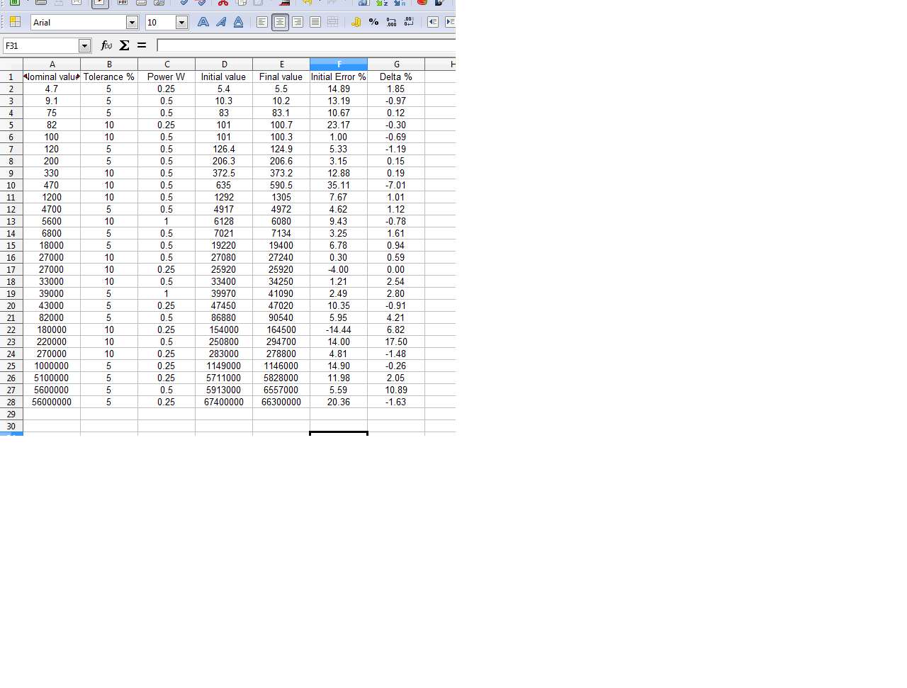

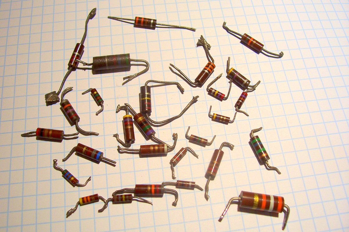

I have measured two dozens carb comp resistors from my scrap box.
They are of all origins, vintages, sizes and values are comprised between 4.7 ohm and 56 megohm.
I have begun to bake them. I will report this evening after some hours @100°C in the oven (accelerated process )

I am just interested in the values.
I have baked them for three hours @100°C + some minutes to allow for warm-up time.
It isn't a lab oven, just a regular kitchen one, so accuracy is certainly not exemplary, but we are looking for trends here, not excellence in metrology.
The results are.... well, mixed: supporters of the method will find some "proofs", but opponents will as well.
Of course, the sample is too small to draw any serious conclusion.
One thing is certain: even a relatively modest thermal event as this one is sufficient to significantly alter the values.
I' ll post a pic of the samples later
I thought the topic was about carb comp resistors?Elvee: You need to clean out your parts bin! These are not even carbon film, but carbon composition resistors. Menace of servic techies everywhere! E

What vintage is the Quad? I cant recall carb comp beeing used after the mid/late 60's (tube time). And I cant believe that Quad would have ever used them
Low value Rs (<100 Ohm), like in your picture, sometimes where wirewound, differnt animal, but you can not tell from the outside
