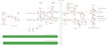

Please look at my project of audio mixer.
It should work as portable audio device, battery powered.
12v through Traco Power TEN-5 1223: +/-15V +/-200mA
First stage is SSM2019 - work as mic preamplifier with 48V phantom...
Next 10k log Pot as volume for channel 1.
There will be the same 3 channels. I didn't draw it.
U1 OPA2604 work as low pass filter at unity-gain.
It separate left & right path SSM2019 from PAN Switch.
3 positions shorts L to GND or R to GND or leave both channels untouch.
So, in this way I made simple panorama switch - only 3 positions: L, R, both...
U2 - OPA2604 next unity-gain. It separate all path channel from mix section.
U3 - OPA2604 with U4&U5 DRV134 it's master section with balanced out.
First! Please analyze my project. What is wrong?
Maybe I made some stupid mistakes. Please tell, repair.
It's my first serious job. I need it to work.
So, I can't pay for SQN or other devices...
Please, look at the resistors, capacitors...
Does that make sense?
THX

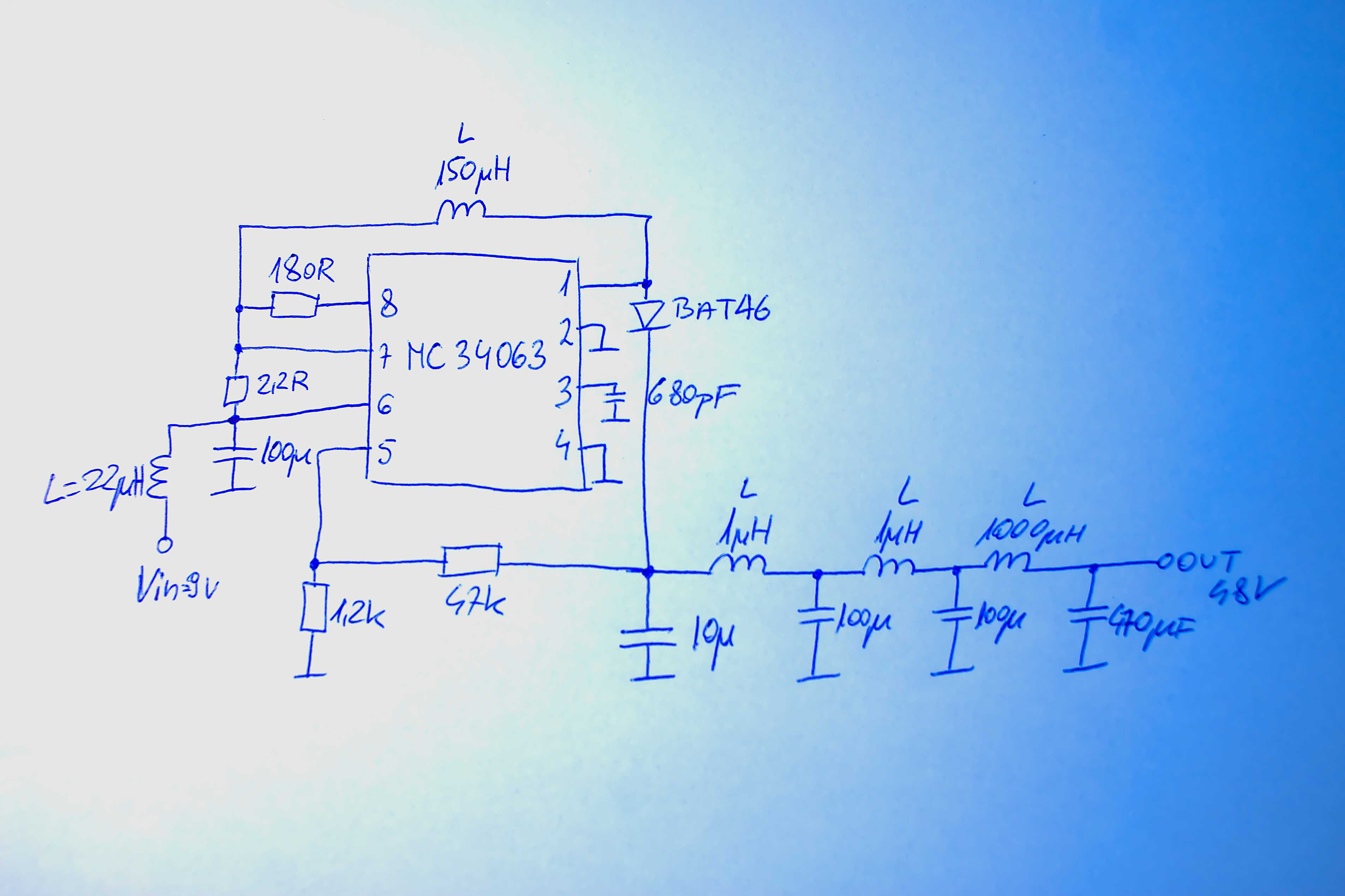

The power supply filtering will be critical to keep switchmode converter noise out of everything, to the point that I would take the 6dB hit and run it single supply off the battery rather then sticking a miniture DC/DC in there (At best a switchmode in there is asking for a lot of design effort at layout time)....
How are you generating the 48V for phantom?
The input impedance to your LPF changes depending on the volume setting, probably not what you want?

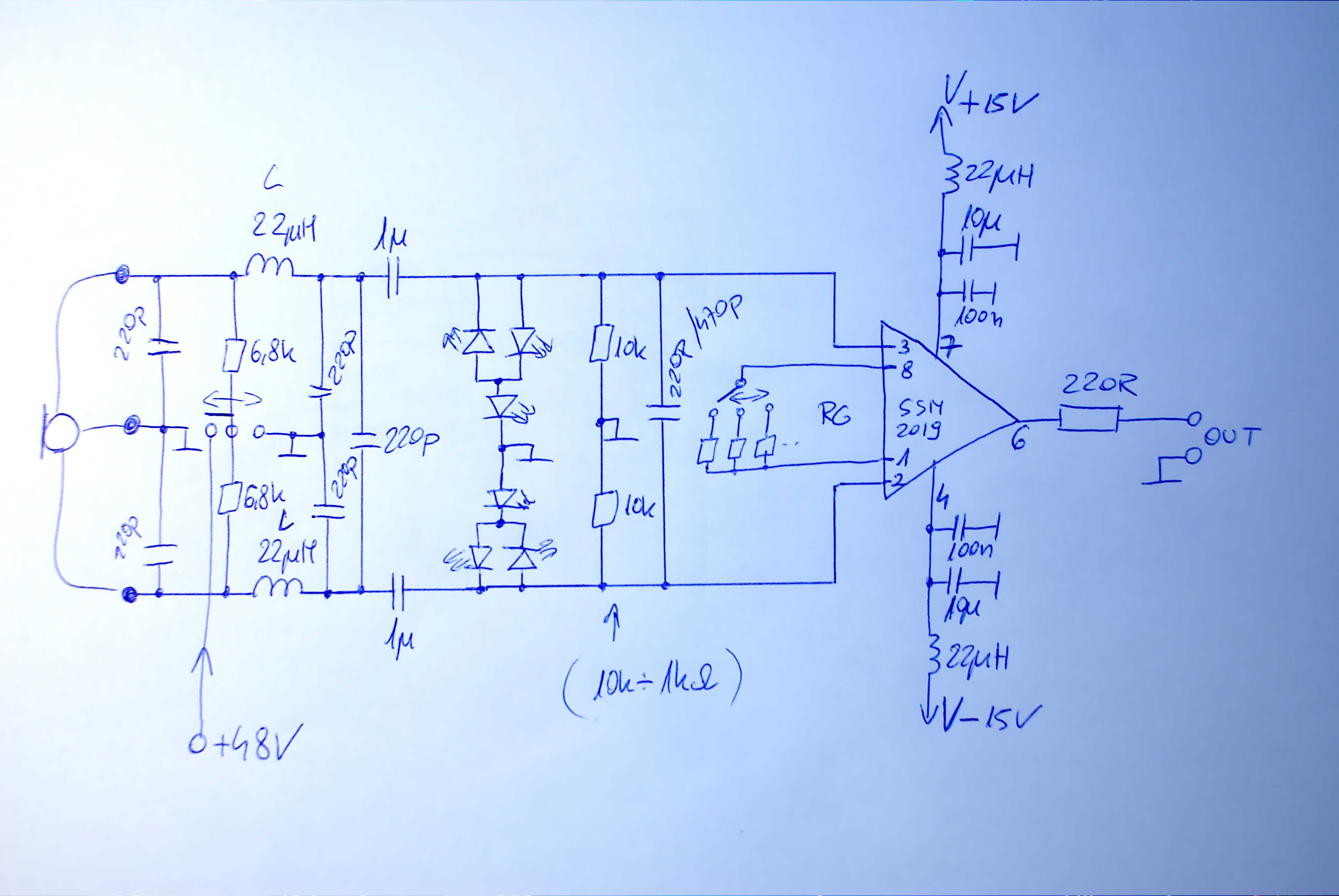

Input circuit? P48? Protection? RFI Filter? Pad? Phase switch? HPF?
A per channel mute switch would be a good thing.
Where does that third order MFB filter go over (Cannot be bothered to sim it)?
10K master pot feeding a 2.7K input Z buffer will have a very odd control law.
2.2uF into 2K7 impedance, feels like phase shift at LF (Cannot be bothered to do the sums).
What is the thinking behind the network at the output of U3? If you are not going for virtual earth or ground compensated summing then U3 looks largely redundant to me?
Output build out resistors? RFI measures? Transient and phantom protection?
Lets see the whole schematic, this is barely more then a block diagram.....
And the elephant in the room, board layout! All those pretty little 'GND' symbols hide IMPORTANT detail.
Get Doug Selfs book on small signal audio design, it contains much that is interesting for mixing desks.
Regards, Dan.

2. The 48V: MC 34063 - attachment

4. "Input circuit? P48? Protection? RFI Filter? Pad? Phase switch? HPF?"
I attached scheme with first step of mixer. LPF, HPF, protection by diodes LED...

12. I use U2 & U3 for separate "mix section" from:
- Pan Switch
- DRV134
If I should achive this in some different way, please help.
Maybe I can get rid of some amps...?

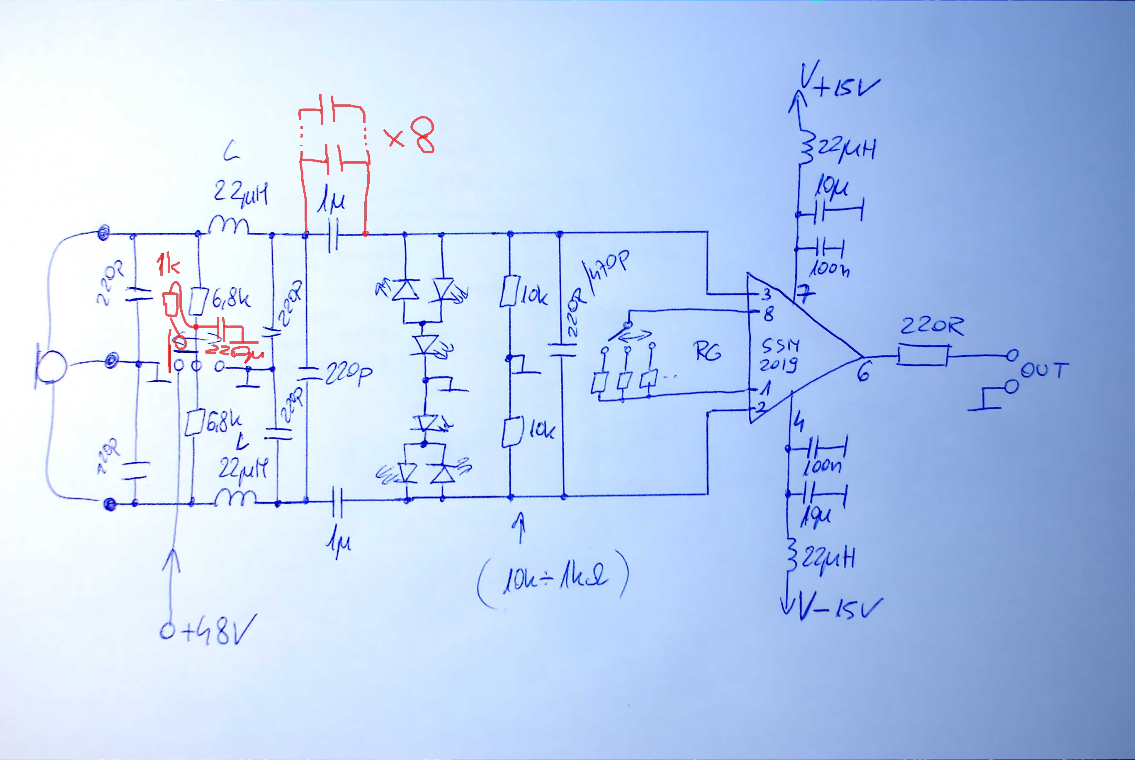

Ok, lets see now....
The input stage, 1uF is way too small, something more like 22 or 47uF would be better here.
I don't like the LED thing, they act as varicaps, low capacitance TVS diodes do better here, and you might like to consider 10 ohm series resistors in each leg after the phantom blocking caps to limit the current it a mic cable shorts with phantom applied (The cap suddenly discharges into the amplifier input transistor if you are not careful).
Connect a 220uF cap from the junction of the 6K8 resistors to ground, and a 1K resistor from the cap to the phantom switch, it will help to reduce the noise from the 48V switcher getting into the inputs (Also it will reduce the thump when phantom is switched live).
Pin 1 on the XLR and the input RFI caps need to go dirrectly to case ground right at the connector, do not connect these to the general 'reference' ground.
Generally, a high pass filter is actually far more useful then lowpass (It helps to cut down rumble and traffic noise), maybe a 50 or 100Hz switchable second order MFB right after the preamp?
Place a double pole changeover switch between the input caps and the preamp inputs to allow pins 2 & 3 on the XLR to be swapped so you can reverse the polarity of the input. Place a 20dB switchable pad before the mic preamp but after the phantom supply so you can attenuate the input to allow line level inputs to be accomodated.
You need to organise PFL in some fashion, maybe a double pole switch with one side switching the audio from before the volume pot to a PFL bus and the other side switching DC to a 'PFL Selected' bus?
Any reason you are using voltage mode summing? Current summing in a virtual earth bus is usually the obvious choice in small mixers like this.
Give me a few days and I will try to sketch out how I would tackle the thing, it is probably easier.
I plan to put parallel more capacitors - 8-10 x 1uF
I don't want to use electrolitic...
If You have better idea, please share...
I can imagine it, but if You will draw something, please remember about it. I didn't see anywhere the solution like this, but it might be work
Why there are always 6,8k for 48V?
Those 1k make any difference?
...so, connect it close to connector on the board?
I think I can't make good project of this... Any help?
Yes, pro devices use this solution frequently.
For what reason make 'reverse polarity function'?
It should be only simple device.
Important thing! I decided to make line/mic attenuate switch by changing Rg value. So, the amplification will be changed, not attenuate.
I don't know that my project is good in this version.
Maybe better way to make some pad for line/mic & then setting Rg of SSM2019...
I don't plan PFL... maybe after I will pass all basic problem...
If You mean pot 10k with U3 - I don't know any other solution to make mix...
