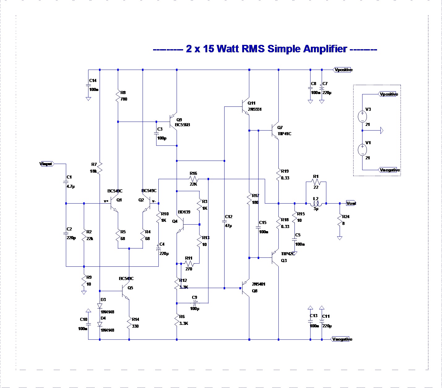

You can do it with a pretty standard Lin/Blameless type topology.. powered from 18V rails or so. Use your TIP41/42 as the output transistors, and 2N5401/2N5551 for everything else.
This is a blameless using those transistors you mention.
The power supply should use a transformer 2x15VAC, which will give like 20-21 VDC rails.
I have tested with SPICE. It should work.

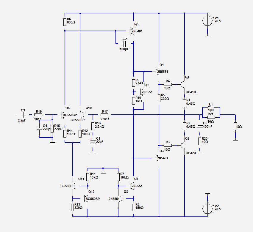

A Class AB 'blameless' is also my vote - like the one I made and linked in my post above. It was designed for low voltage rails. At really low voltage rails things need a bit of care because you start to lose some headroom and the LTP benefits from a current source like Lineup shows rather than the resistor I used.

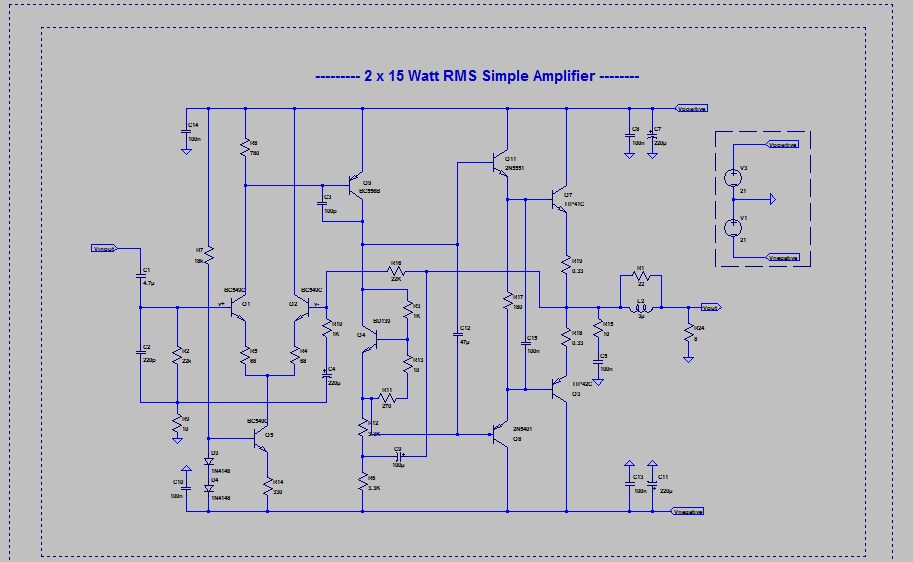

I should aim at something like classic 3 stage topology like Bigun and Lineup mentioned before.This is my design but then comes in mind some more questions like:should i use current mirror in LTP? or a buffer in VAS? or some kind of cascode?or Sziklai output due to lower quiscent current than EF output? or they are to much for such a simple application?
