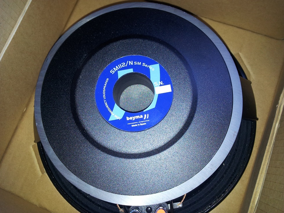

Hi I really hope someone will have time to help.
I have a Beyma SM-112/N Driver and want to use it as a Music subwoofer at home.
I'm not really sure if its a good driver for this use, any advice will be nice.
What I really need is a design or a Sub enclosure for this speaker,
I've tried once in the past to make a box on my own for another speaker and I wasn't happy with the results,
That's why I ask for help for this one.
My main use will be listening to music, all types, from Linkin park to Enigma, to any pop music.
My left and right speakers are BOSTON ACOUSTICS A26 Bookshelf Speakers, on DIY APEX amplifiers.
http://profesional.beyma.com/pdf/SM-112%20NE.pdf

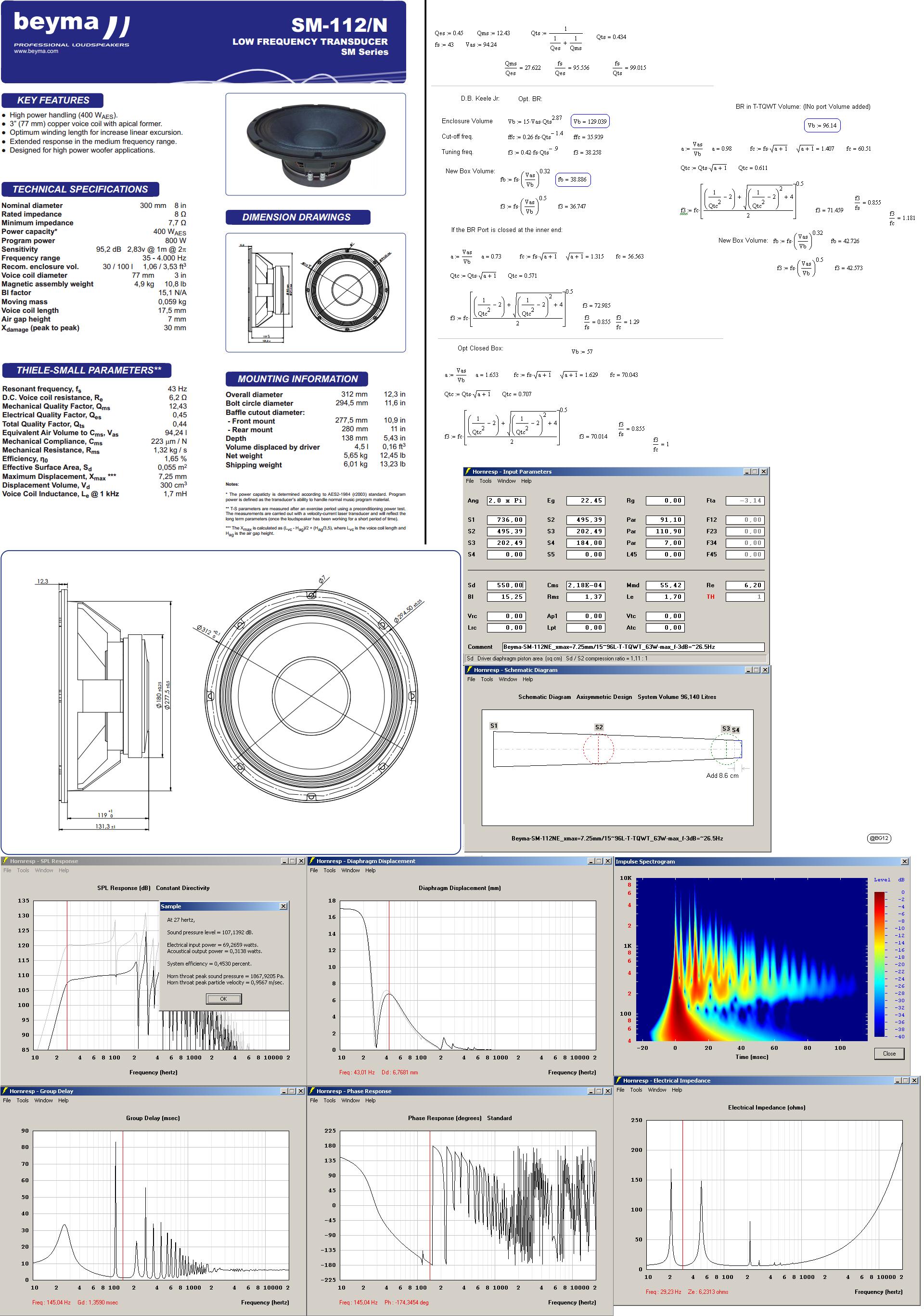

Hi Vostro,
The Beyma driver is IMO very suited for a quality quarter-wave based sub:
Here is an example constituting a folded OD_T-TQWT (Offset Driver_Tapped-
Tapered Quarter-Wave Tube that should be lined with damping material.

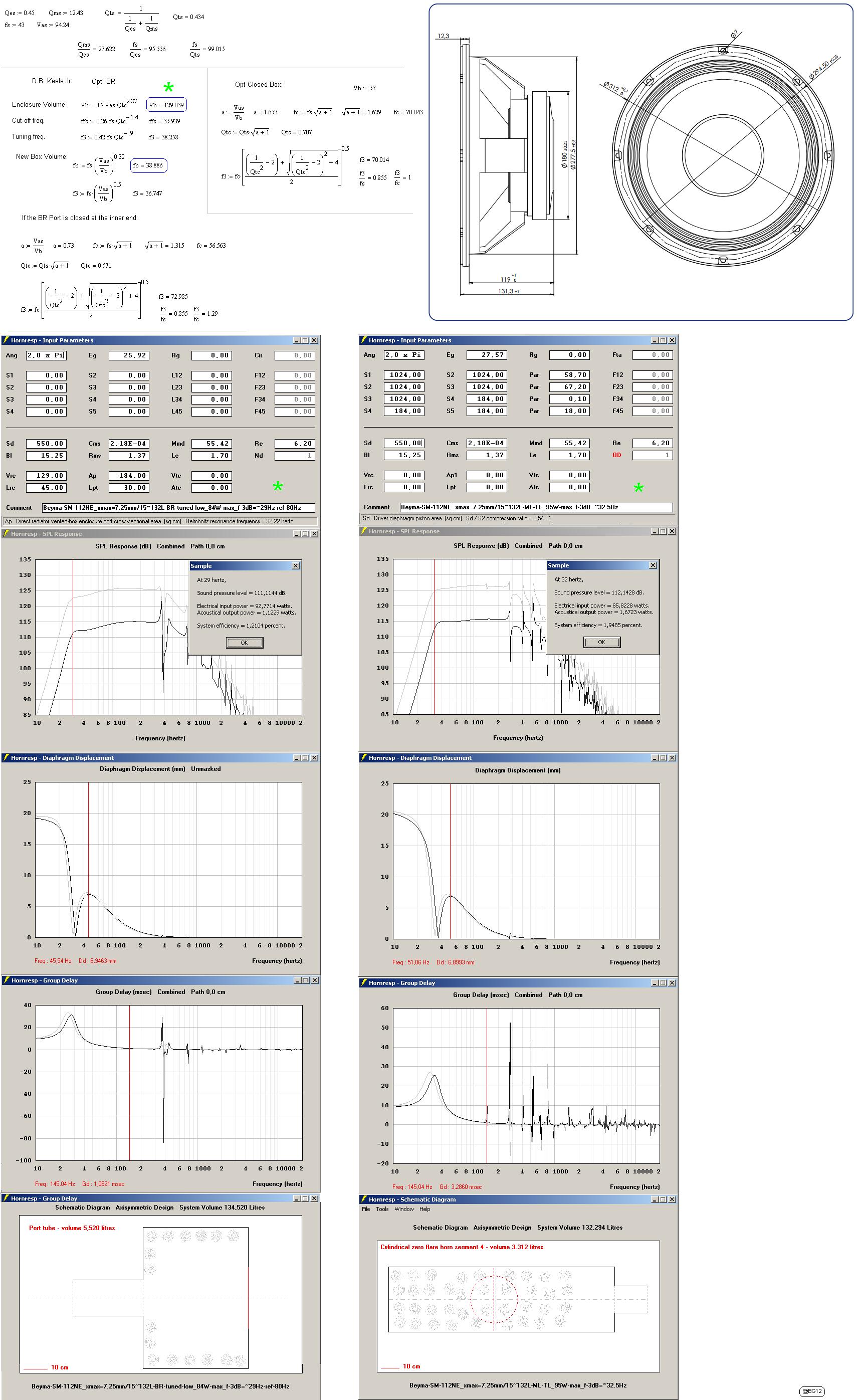

I did try a calculation on vented BR and came out with 130 liter netto, with very low roll off around 30hz
and interestingly it appears to handle big slot ports

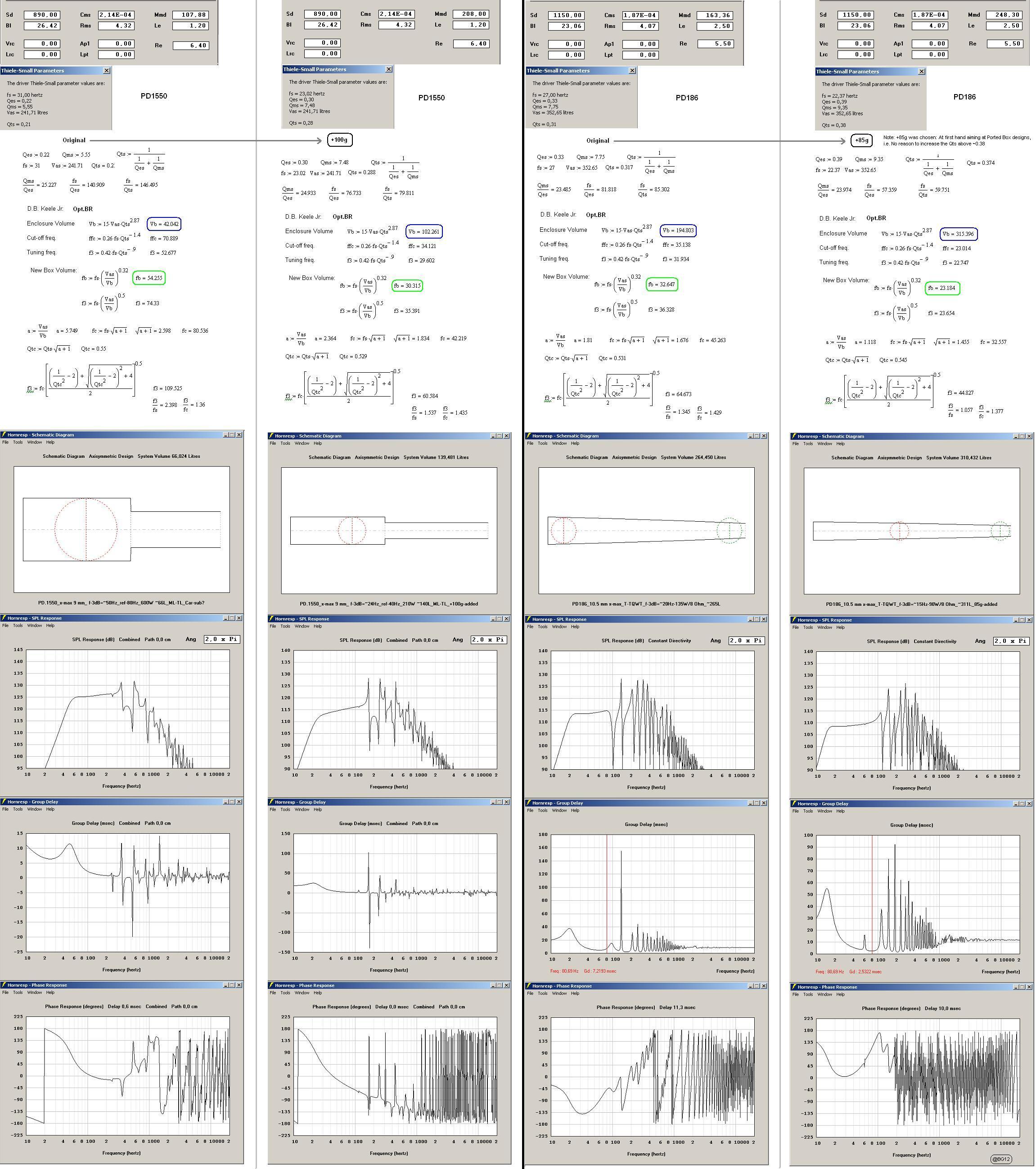

Hi tinitus,
You're absolutely right, 130L is optimal for the driver. From this volume its easy to scale a port system to suite a conventional BR or quarter-wave type.
Note: Use an seeding port area of ~Sd/3 to start with.
Use HR or an another program that take in account the port placement and can handle quarter-wave resonances.
First: Keep the box volume constant(Opt BR) and resize the port length (to fit an enclosure of your choice), then add port area until the BW drops more than you wish.
Here is a simulation that can be used as starting point to expand the port sizes. Picture#1:
b

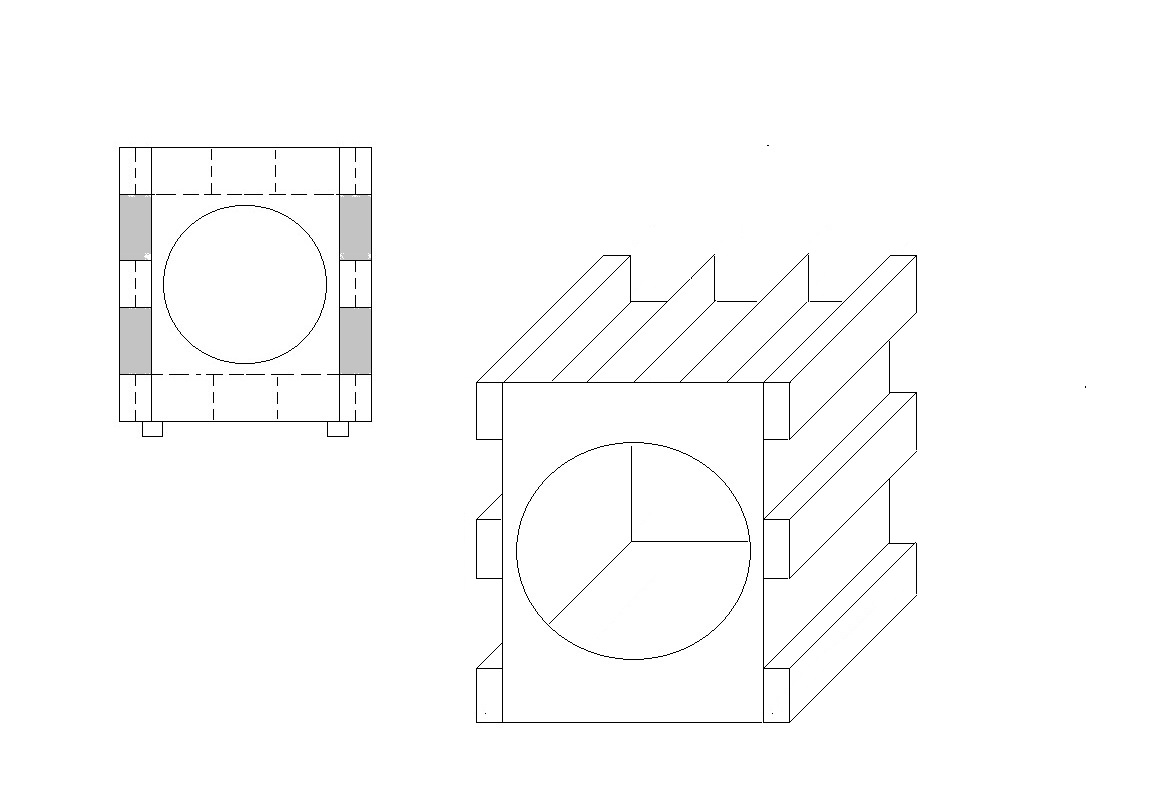

Ps:
In another thread we talked about adding cone weight to a PD.1550 and
Ive lost track of the original thread but posting my suggestions here instead. Picture#2:

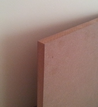

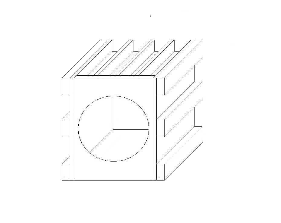

16mm MDF like picture,
Sadly I live in an appartment and dont have the greatest of tool selections,
I have Hand tools, like drill and jigsaw,
My wood supplier cuts wood, so I usually get most of the cuts done, then alter at home as needed,
If I need more help I can always contact a friend.

well to be honest, Im not sure, i would guess piloting holes and using wood screws with woodglue,
But advice is needed,
No there curts are sometimes not square enough, but I'll chat to them and ask them nicely to be exact. they use big table like saws and are as smooth as in the pic above, but thats just a offcut from previous project.
