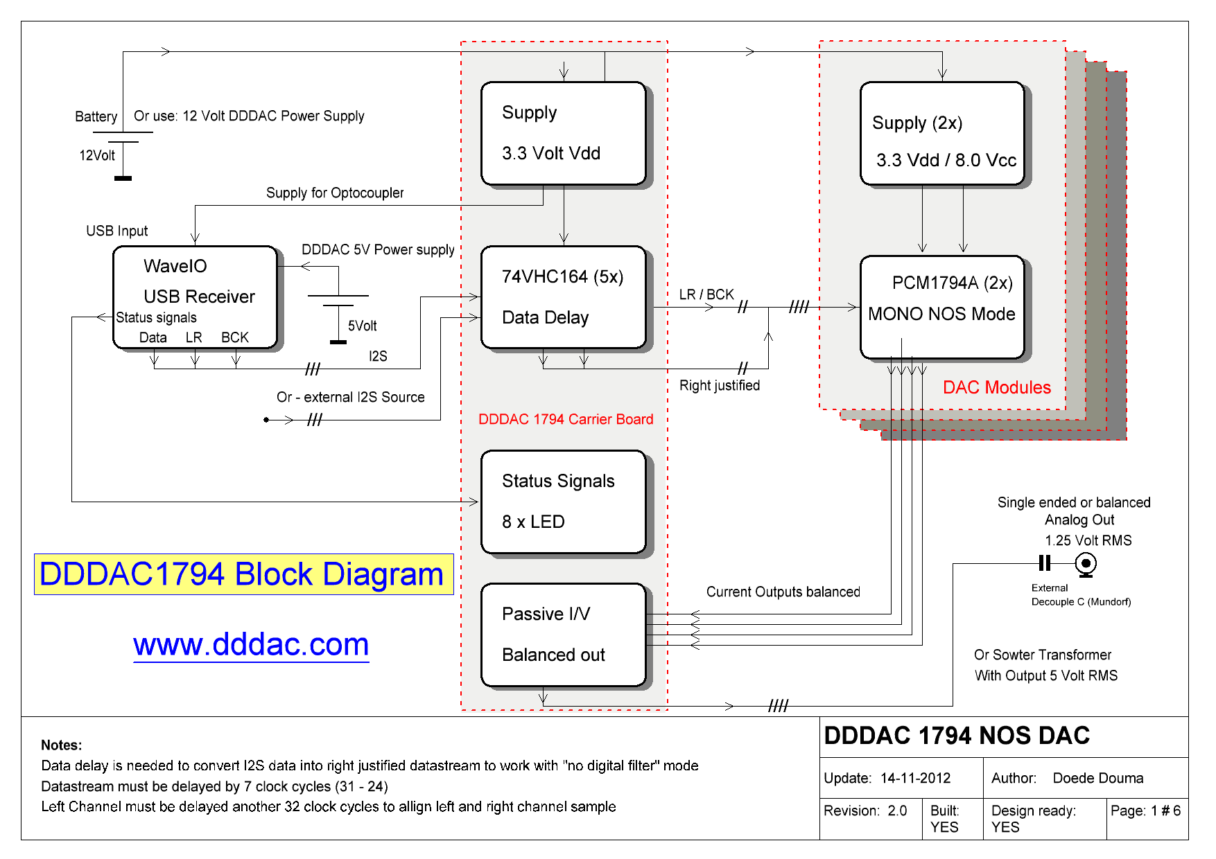

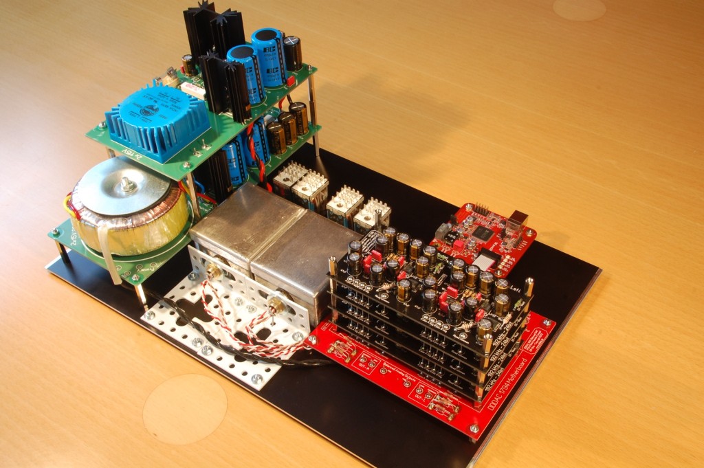

In the past year I have been working on my new project: designing a DAC which will play up to 192kHz / 24bit material from a PC (or Mac...) There are many DACs who can do this, but I wanted to design a NOS version, as so far, every listening test I did, this led to a more open, natural and detailed sound.
I found this to be possible by using the well-known PCM1794 and avoiding the digital filtering built into the chip. This proved to be quite tricky, but I managed to find the key to do it. It has been a great adventure with much to learn and a fantastic result at the end....
To feed the DAC, I kind of integrated the WaveIO USB Receiver from Lucian. Great design and better sounding than all others I tried (see my website for this as well); I give a very detailed report on www.dddac.com
You can download the circuits here: dddac1794_nos_ver30.pdf
The Images below show:

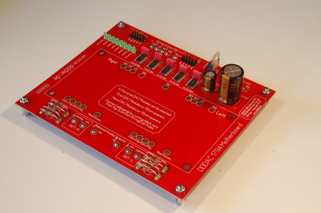

The Mainboard with I/O and I2S to right justified conversion

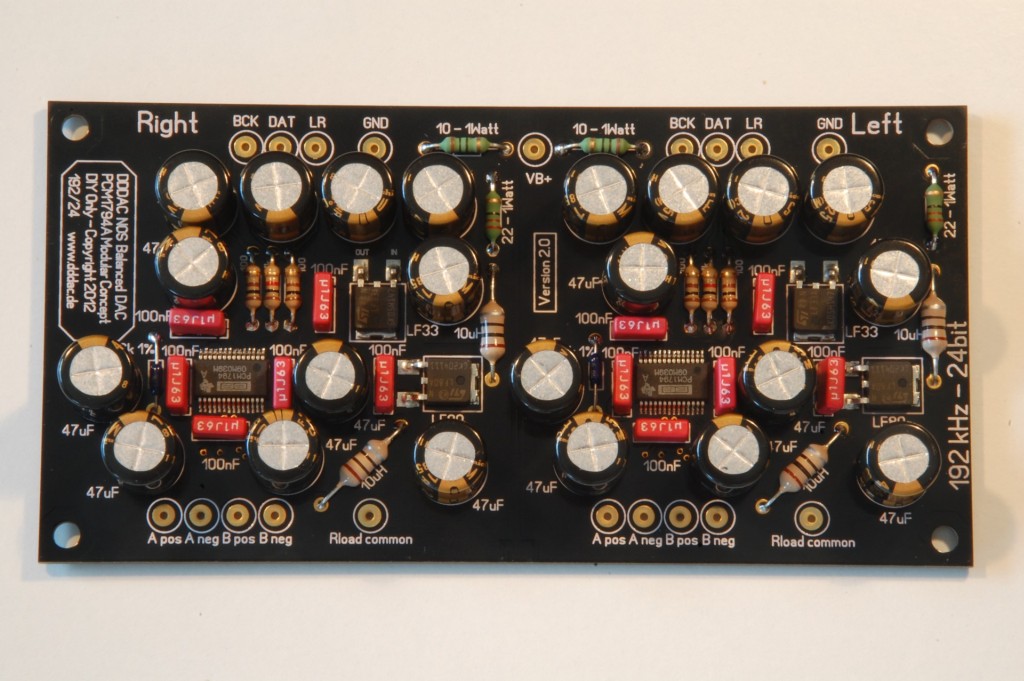

The actual dual mono DAC Module (can be stacked parallel)

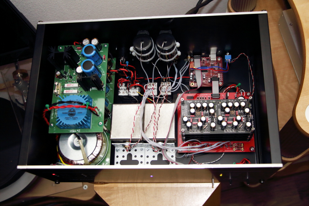

Built up with 4 modules and two power supplies (5 and 12 Volt)

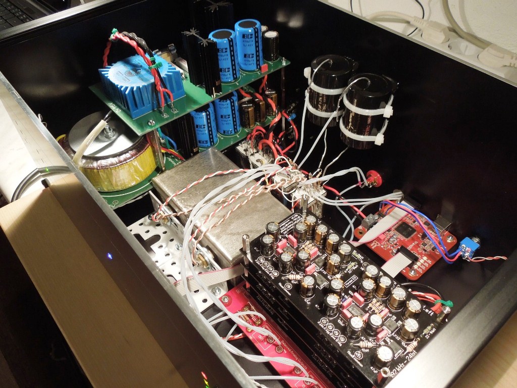

Wired up in Chassis (Mundorf Gold silver oil output and optional Sowter 1:2

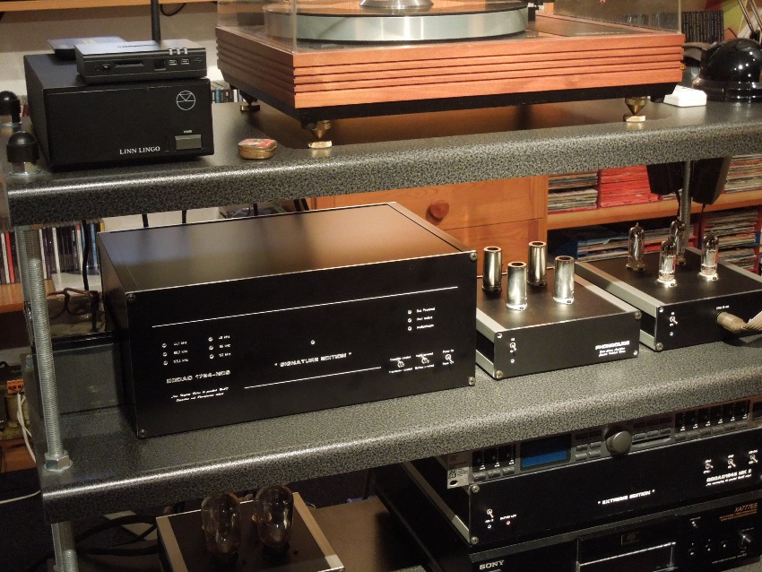

The DAC in my Audio rack
Another view inside
Block diagram
I opened this thread to share my design and experience and give a platform for questions, feedback, remarks and/or discussion...

Doede, what made you choose this chip over- say pcm1704 ?
I also wondered why someone with a track record on R2R DAC designs would choose a delta sigma chip. The PCM1704 seems like an obvious choice for a NOS 192k/24 bit design, especially when you consider that the 1794 requires manipulation of I2S input to run NOS mode anyway, which would kind of negate any argument about a 1704 design requiring additional supporting circuitry.
If you factor in the design requirement for passive I/V, the 1794 has the current swing to do that, the 1704 doesn't. Maybe that's the reason. Will be interesting to hear what Deode has to say.
Few things:
general performance as DAC (which I considered as excelent)
192kHz possible
(high) current outputs (so I could parallel and do passive I/V)
the Option to avoid the digital filter

Hi Peter,
Indeed, the good old DDDAC1543 still plays at top of the range.
The new DAC does show improvement on 44.1/16, but the real gain of course is with HD material (read the sound check 1 on my Website...)
yes, no problem. The WaveIO is a general board with I2S Output and it works perfect with the DDDAC1543...

the current swing is one... and I did consider the PCM1704, but it only does 96kHz.... that's why i dropped it at the end
Yes, but that's 96k at 8x OS. ie. 768kHz.
Correct, it should do 192 in nos mode. I am contemplating on designing a pcm1704 dac, but i am not sure if it's worth it. I generally find there is limited hi-def material around...
There are several 192k/24 bit NOS designs built around the PCM1704 out there. Although the data-sheet states a max of 96k @ 8x OS, I believe Kingwa (Audio-GD) is running 192k @ 8x OS from his DSP to the 1704, which would imply that the chip is actually capable of a 1.536MHz word clock.

Very valid Point. I simply overlooked that in the early days. High price and output arguments played a role as well of course, as well minus power supply. After that I hold on to the PCM1794. Might have had still oversampling specs in mind then. Anyway, 96kHz was not the only showstopper. Does not change a thing on the fact the PCM1794 in NOS is performing great
Nevertheless it is tempting to try a pair of 1704 though
Wouldn't it even do DXD in NOS mode?
DXD must be supported by the USB Receiver. The WaveIO does not Support that according to specs (max 192kHz)
You would expect that the DAC as such would support this, as the 8x oversampling is omitted, but I have not been able to test this...
