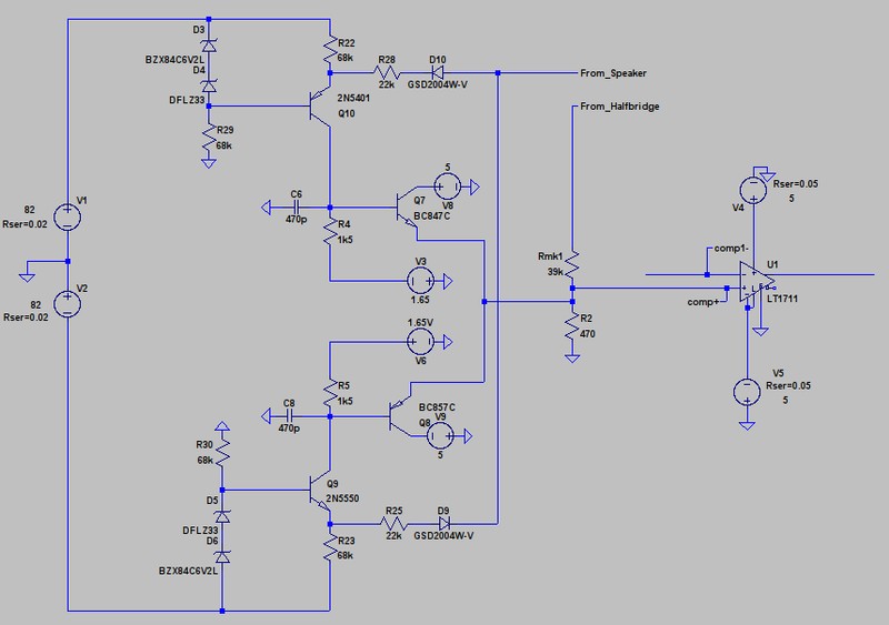

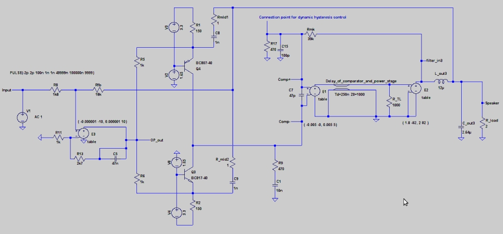

Attached my dynamic hysteresis control.
Please don't be shocked by the LT1711, it is just an avaiable comparator in LT Spice. For the real design I am intending LM160/LM360.
Also please do not wonder about the series connection of a 33V zener and 6.2V zener. LTSpice simply did not offer a 39V zener....
Functionality of the circuit:
At low output voltage Q7 and Q8 are completely OFF, polarity of Ube is reversely biased. No influence on the hysteresis rectangle formed by Rmk1 and R2.
Q9 and Q10 are running at low biasing (theoretically for fundamental circuit no bias needed). When the difference between output voltage and rails becomes smaller than the zener value of 33V+6.2V zeners, then Q10 or Q9 will be driven with increasing currents and pull up or down Q7 or Q8, which in consequence will more and more clamp the hysteresis rectangle. The smaller the magnitude of the rectangle, the higher the operating frequency. It is easy to control the frequency shift this way.
Still a good portion of frequency reduction at high levels is desired, because this is reducing the switching stress of the MosFets. The control circuit shall just avoid really heavy voltage ripple on the speaker signal as it usually happens in ultra simple selfoscillating amps.
In fact this principle is suffering from the parasitic phase shift oscillator mechanism, which will not allow unlimited high frequencies. Transfer function and propagation delay will limit the max. possible switching frequency, even if the hysteresis would be set to zero.

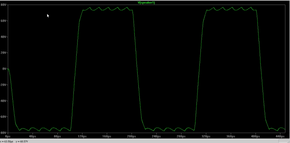

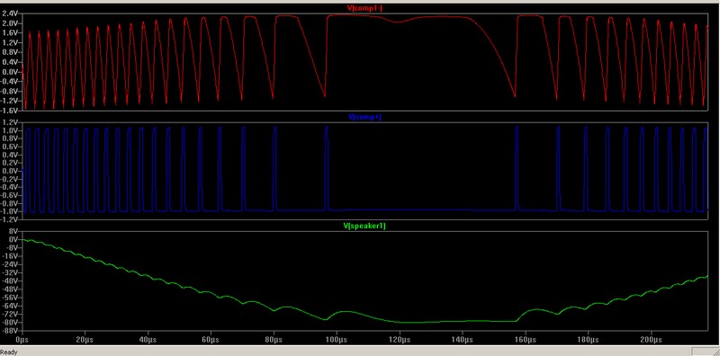

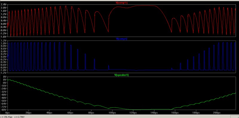

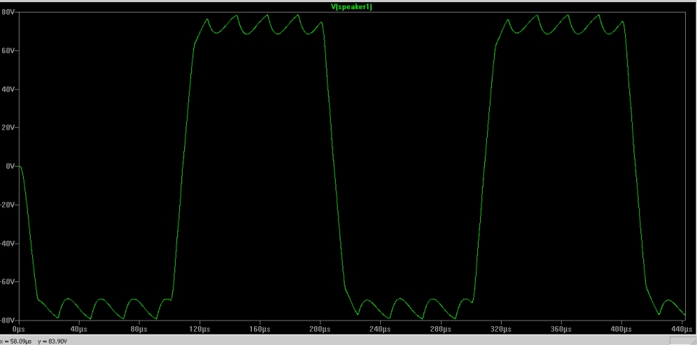

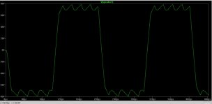

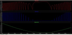

Attached you can see the influence on the intended amp, when running to the clipping limit with a 2kHz sine wave.
Basically also without dynamic control the amp is behaving in an acceptable way, but with dynamic control the ripple remains really nice even during last switching events.
First picture without dynamic control.
Second picture with dynamic control.
Edit: The blue trace is showing the hysteresis rectangle, which has a constant magnitude without dynamic control, but with control its magnitude decreases at high output levels.

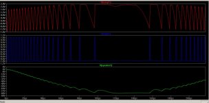

The difference is more obvious, when watching signals which run close to the rail - like large rectangles.
At 150Vpp output voltage the version without dynamic control shows approx 10Vpp switching ripple, while the version with dynamic control is showing approx 4Vpp.

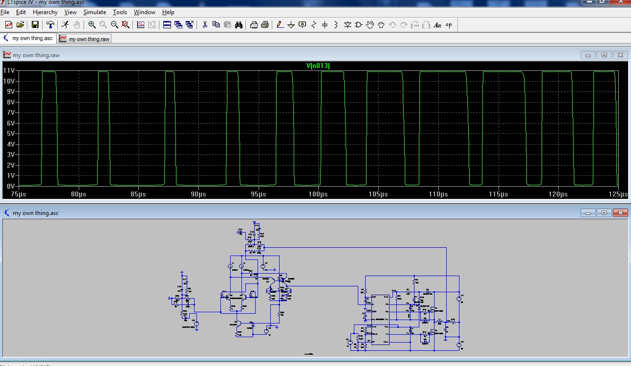

Hi Kanvar,
I am loving your rookie attempt!
The second one is looking great and might outperform your earlier work,
but it does not have this special DIY feeling like your first. :cool:

Attached a simplified schematic of the amp from which the earlier simulations were derived.
I already have a sim with more detailed power stage including IRFP4668, but so far I have no reasonable option to post larger schematics in a readable way...
The overall structure is very similar to System_MD.
- table E3 can be any reasonably fast OP amp, which is stable at gains >3.
Design goal: Allow to use 1/2 NE5532.
- Q3, Q4 provide the virtual GND for the D portion of the feedback
- table E1 should be the LM360
- table E2 is the level shifter (IRS20957) and BJT gate buffer and IRFP4668
- In front of the shown amp the second half of the NE5532 will be put as an differential input amp to enable symmetric inputs and easy amp bridging.
- Upgrading the circuit with better OPamps possible.
The connection point for the hyteresis control circuit links to the previously shown circuit.
With these values the amp has an idle frequency of 315kHz in simulation.
I am also considering higher frequencies, but from theory the switching losses in case of a short circuit with small input signals, which can run the amp with unreduced frequency close to the overcurrent shut down, but just not triggering it - are already at the limits of the SOA of the IRFP4668.
2kW, 80V rails and an overcurrent protection around 60A demand their tribute...

Choco,
I did a lame attempt on discrete comparator...
Not a lame attempt at all. I did not see this posting earlier, because I was writing my posting at the same time.
I cannot see all details of the circuit, but it looks like a typical straight forward design which allows reasonably results.
From my findings symmetric delays and rise times can be achieved best by an a fully symmetric approach... again more components.
Most simple a fully symmetric input stage of such an comparator can be achieved by using JFets instead of BJTs, because their control characteristic allow simple self biasing.

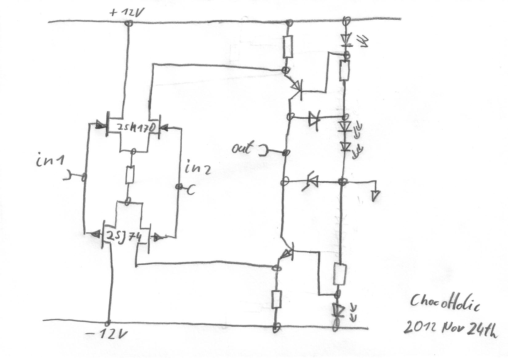

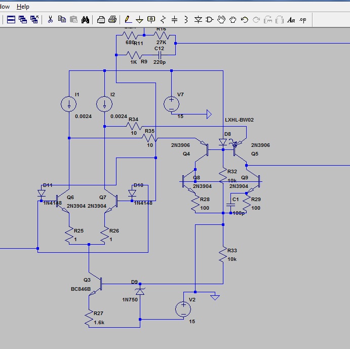

...back to the discrete Comparator:
Attached a sketch of a simple discrete approach, which should just satisfy the needs and still would be possible with reasonable component count.
It has similarities to the design in MD, but in MD I used a MosFet input which does not allow for easy self biasing....
So the attached version should be more DIYable (except obsolete components).

Great going Choco
I think a Hysteresis modulator with a CCS control [i have seen this approach somewhere] is best option in order to mitigate any effects of voltage fluctuations. This will give more precision and control over how it actually performs.
Nevertheless the idea to think about options to enable both is good.
In case the LM360 would become annoying, it should be possible to design a discrete comparator that fits to the DIL8 socket of the LM360 plus two wires for +/-12V.
Supply voltage limit for LM360 is recommended at +/-6V max not +/-12V, for that you need LM361. Also the IRFP4668 in bridge format is capable of more than 4KW in 2 ohms music[been there done that] :D
I agree with you that a symmetric section is always needed for symmetric slewrate. Will be doing some more sims in short while.
Don't you think matching of JFETs is little critical, or one can get away with that in case of comparators.?

JFET-matching:
You are right, massively unmatched devices might cause issues.
But I think it should be easy fit them in a sufficient way.
