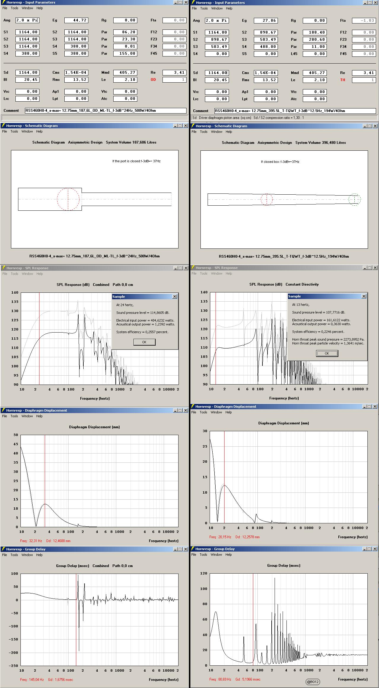

Ive dealt with the 10"s and 12"s (10" HF in my old car, used all others in various installs for home use). Those subs are solid and very hard to beat for the money. Always kept me satisfied... curious how the 18" turns out. Hope you pick one up and share the experience! ;)
:2c: Make a closed box.. If the enclosure must be Ported:This driver requires a refrigerator size of volume in order to keep Port issues at a benign level.

Looks like the minimum size box (sealed and QTC=0.8) is about 6 cubic feet with an f3 of 29hz. However, a Titanic 15 in the same size box with SBB4 vent tuning is fairly flat in the passband with an f3 of 23hz. I think the Titanic is still the best buy out there. That said, I must confess that I built a pair of 18" three way prosound speakers that I occasionally crank up and enjoy the hell out of.
