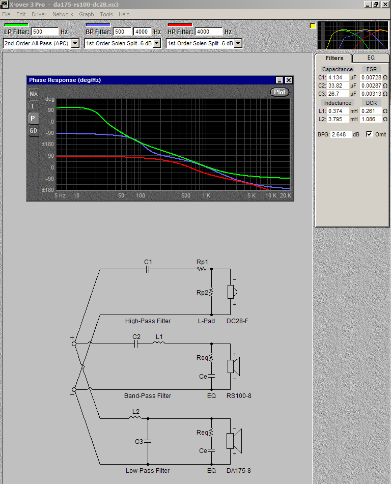

No, those diagram show the phases generated by the crossover, or more accurately, the difference between the phase of the input voltage (of the crossover) and the phases of the output voltages at the driver terminals. These determine whether each driver should be connected with "+" polarity or "-" polarity to get the proper acoustic phase from the speaker. These have little to do with the phase between the input's voltage and current. That phase also varies with frequency, whether it's a single full-range driver or a multi-way system with a crossover. One design isn't necessarily harder than another for an amplifier to drive, but specific models of speakers are harder than others.
The whole thing is basically AC circuits analysis (one of the fundamental courses in Electrical Engineering), which needs (the mathematical concept of) complex numbers as a prerequisite.
OK, that being said, how can you predict the Impedance and Acoustic "Phase" of a given loudspeaker in simulation?
I take it Crossover Pro 3 cannot show these aspects of design?
You answered your own question there...
Basically, the phase plot is the derivative (calculus) of the FR plot. You can extract phase with a Hibert-Bode transform applet, but that doesn't mean you can use it in a certain program to your advantage. Some simple calculators or simulators assume perfect resistive loads and flat-FR drivers; and offsets, phase, and such are not factored into the box of tools to produce good results.
