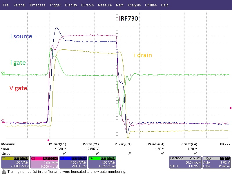

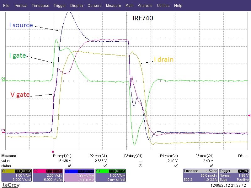

I've done some tests with IRF740 and 730 to measure on-off times, and the 740 need about 80ns to turn completely on and about the same (slightly longer) to turn off. I think the IRF640 is about the same. Yet it seems to me deadtimes of about 40ns is common with the 640.

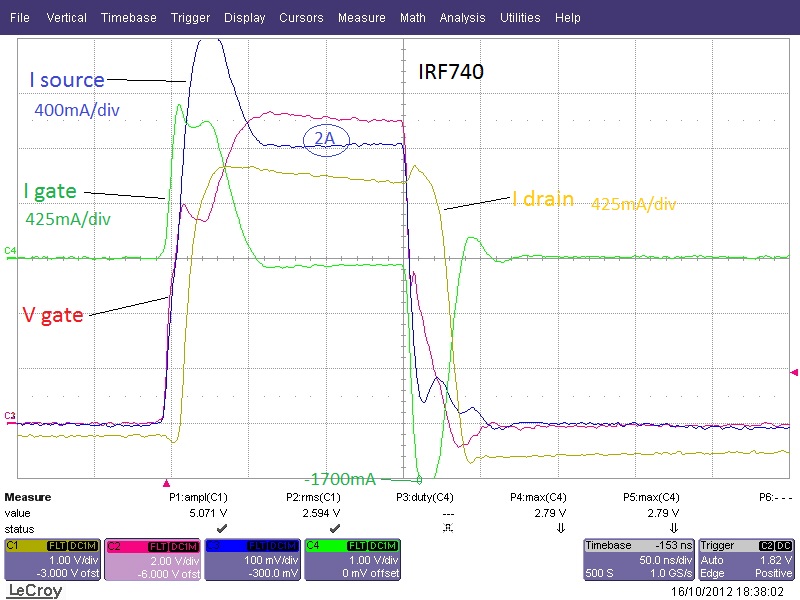

Just to clearify...I know even with a +-9A driver, I cannot get that out with a 5ohm resistor in there. (Besides...do we really believe this tiny package (driver) can actually source and sink 9A?) But I checked the gate current with a current transformer and the current was less than the potential 2A the driver could have given (10V drive).
Also when I say impedance between driver and gate, even directly coupling driver pin to pin, will still give an impedance that gives the delays.
Edit 2: the drain current and source currents are not same scale due to drain current measured with current transformer while source current using a 0.25ohm resistor.

If your gate driver is pulling to 10.5V, gate threshold is about 6.5V, so the difference is 4 V across the 5Ohm resistor -> 0.8A peak. BTW: The driver CAN deliver 9Amps peak.
Good point, will try less resistance.

Hard-switch-off goes the other way round. Now your dead time should only cover phases 2 and 3, in your scope shot they look like 30ns in total.
When the load is inductive, the inductor current may help to shorten phase 3 in some cases.

The package doesnt have to continuously supply 9 amps, its only for the first 100ns then there is no current flow.
Thnx for reply.The package doesnt have to continuously supply 9 amps, its only for the first 100ns then there is no current flow.
Yes indeed. If you look at the IRF740 it is sourcing for about 50ns and sinking for about 40ns. Being a TI device I had no reason to dis the driver, I duely appologize.
