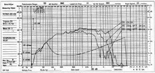

The frequency response of the Vifa P17WJ (below) is very nice, if a little bass light, but no bad thing in a small room IMO.
I liked Marshall Leach's design, being quite KEF Coda IIRC. Easily tuned. :cool:
