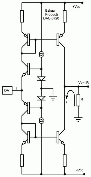

What I am wondering is whether any of the DIYAudio.com audio gurus have studied or understand the Bakoon Satri circuit? What makes it so SPECIAL?

There could be a reason why a factory-built amplifier has not been mentioned on DIYaudio. Is a circuit diagram and meaningful description available? 6moons is not highly regarded on here. It could be that the 'Satri' circuit is another manifestation of the Gilbert precision BJT method, but audio reviewers rarely give enough technical details - either they don't have them or they don't understand them.

I fail to see how the topology is either special or proprierty, it resembles or rather lets say it copies the topolgies from the early 1980s current feedback opamps. In this case no feedback is used. Current feedback amps can and do sound very good because of their speed and wide bandwith. Have a look at the SSA thread, youll find similar circuit is used in the beginning stages but there no use of current mirrors is made although this helps linearity as there is absence of feedback. This circuit also makes use of a much better outputstage so I would think the circuit could indeed sound good.
We may be "autistic savant guys" (not sure if that was meant as an insult or compliment) but we cannot comment on a circuit we have not seen. Photographs tell us very little.

More shots of the innards of the Bakoon amp. So what's going with the circuit, boys? Any clues as to why it sounds so 'special' ? Apparently the input circuit is very different.
I'm waiting for comment from some of you autistic savant guys to see a unique pattern within these pics ...
One obvious thing: a lot of thought has gone into the power supplies, the smoothing caps are small radials, a large number in parallel. The voltage rails would be very low impedance, and the supply to the circuits superbly stable: this can be a large part of the battle ...

Just from looking at the pictures I see some strange things, BNC connectors used as LS connectors? weird..
The power supply looks like a traditional design, a diode bridge with a bank of capacitors (Panasonic FC from the looks of it). I also spot a ALPS pot and a really nice (aluminium?) case.
Nothing really special so far, good quality components probably (as it should be if the price tag is $4K).
If you can post some schematics, then we can have a real look at what's going on with this amp.
