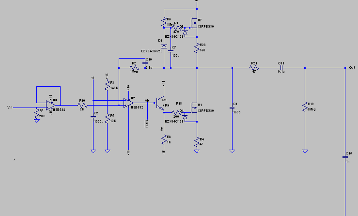

I have used IRFBG30/IRFBG20 in the past. The amp was class A bridged; max. output voltage about 600V rms. Suitable for panels having high efficiency only or headphones.
There are many BJT transistors with higher voltage rating but their SOA is usually worse at the same supply voltage. What topology amp you are planning to build?

Looks like i have lost the complete schematic. Here is the screenshot of one half of the bridge. 600Vrms is already for a bridged amp. It has some severe shortcomings however:
1) low output voltage for most ESLs(except headphones & very sensitive units)
2) high power dissipation(constantly 40w for one bridged module) - active cooling needed
3) possibly lower safety because output voltage is not isolated from the ground.
So I have abandoned the idea some time after.

ESL loudspeakers can require middling kV
IXYS offers MOSFET up to 4 kV - still would need to cascade for some ESL
Class A is hugely power wasting for driving pure C load to 20 kHz when most music has <5 kHz power bandwidth
and even for ES headphones several of the "audiophile" direct drive amps do draw over 50 W continuous power

been there, done that... All the way up to that 16 mosfet cascaded output stage running from a 4000V power supply, putting out more that 7.5 kV.
The irfbg20 and BFC40 were the best options available at the time I worked on this (couple of years ago). Could be there are better alternatives available now. You need high voltage and low gate capacity, approx 2A is ideal.
Take into account that for fullrange you need approx. 25 mA per kV, for a decent output you need at least 8kV voltage swing (4 kV power supply and bridging). That requires a current capacity of 200mA ruling out class A (2*.2*4000 = 1600W dissipation at least, per channel!). You have only N-channel fets available so class B is almost impossible to construct in such a way that it is reliable and low-distortion.
In short: Don't do it. IMHO best option is an impedance compensated transformer in a feedback loop.

Forget spice for high voltage mosfet applications. Reliability is zero. The internal capacities of MOSFETs are voltage (and even current) dependent. At these high voltages this effect is very pronounced. The models used for MOSFETS in spice do not account for that. My experience is that the real world and spice are truly two very different things ;)
The problem is that you have to drive a capacitor. At low frequencies you need many kV's swing to get decent output. At high and midrange frequencies you need hundreds of mA current. Combining the whole spectrum in one amplifier means it has to provide both, making it impossible to use any class A (or single ended) design.
So the challenge of building a good direct drive amplifier really comes down to how to build a push pull output stage using only one polarity of devices that see the full voltage. So far I have not found a satisfactory solution for this without using a transformer. Very interested in how you get along... So good luck and keep us posted!
