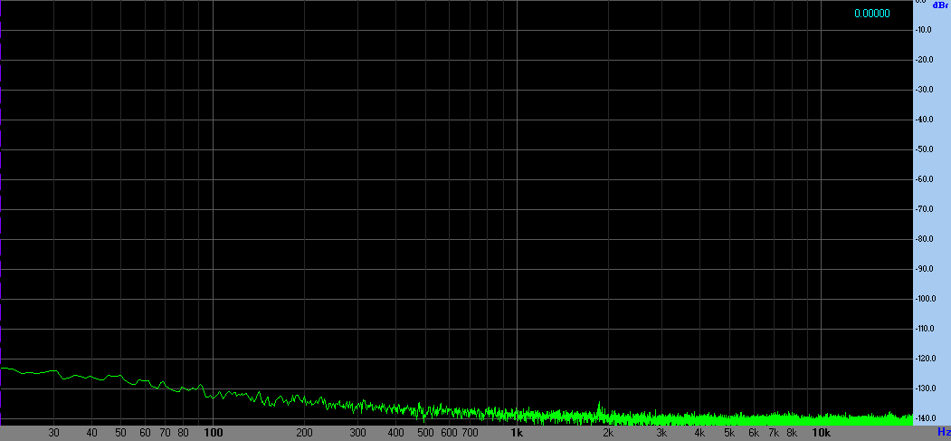

M-audio Transit.

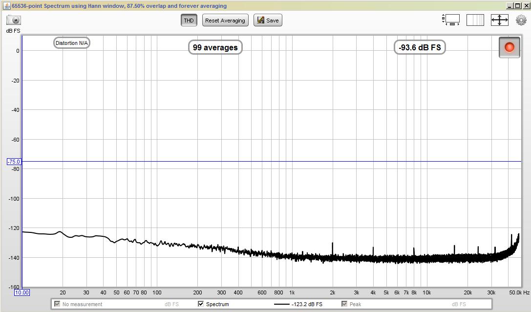

I am currently using an M-Audio Firewire 410. It's an external box with Firewire connection to the computer and its own wall wart PS. Noise floor falls from -120 dBFS at the lowest frequencies to -140dB FS at the highest frequencies. Max sampling rate is 96k Hz. It also has a built in mic preamp with defeatable phantom power. They are discontinued, but you can pick them up on Ebay for easily under $100.
The newer option is the ProFire 610. Mostly the same, but sampling rate up to 192k Hz. This goes for about $250 I think.
See attached pic of noise floor. This is done using REW:
REW - Room EQ Wizard Home Page
-Charlie
