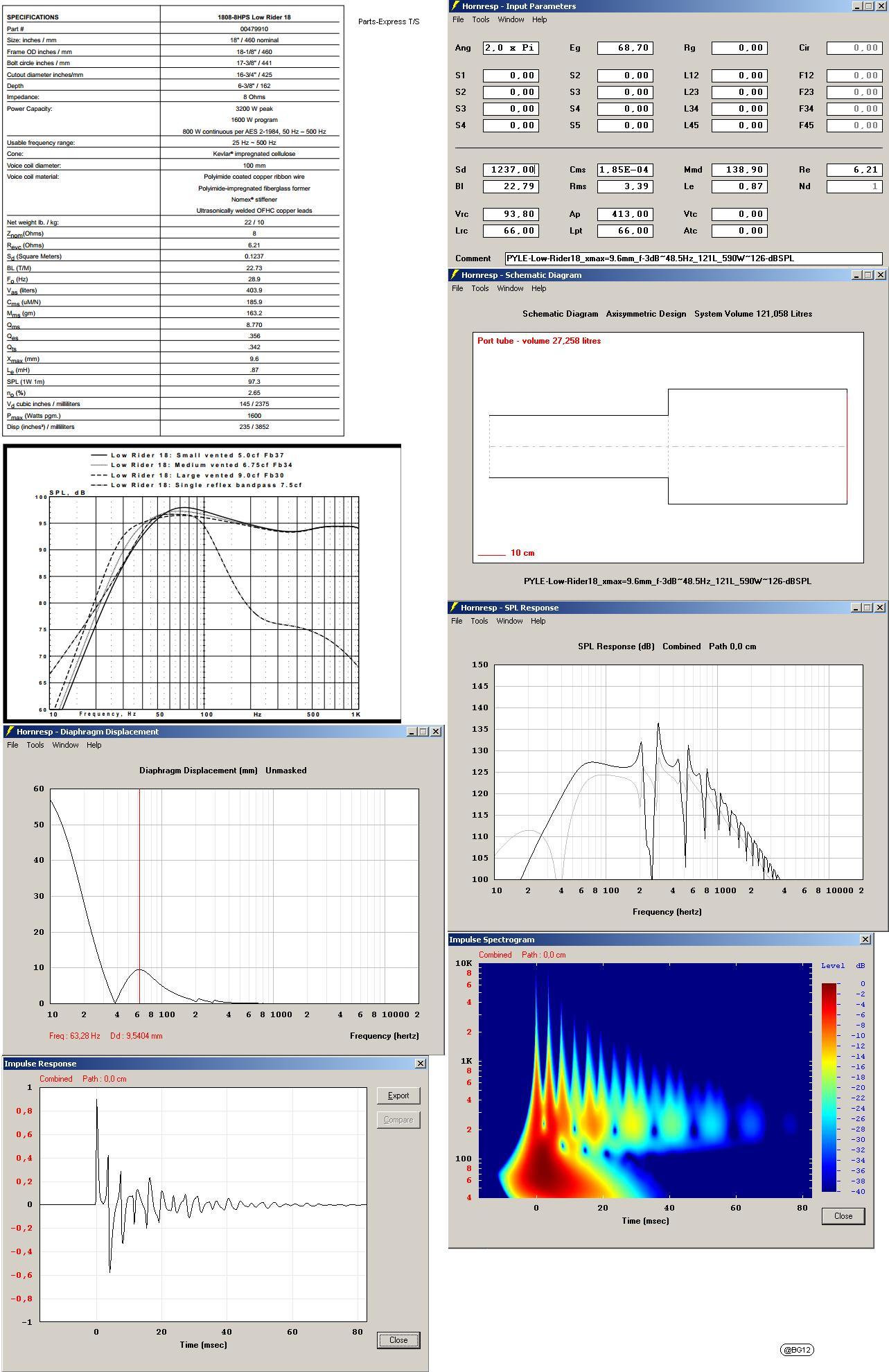

OK, if I pretend in WinISD that my 6 drivers are in one box tuned to 38hz this is what the max SPL profile looks like. note. WinISD max SPL doesn't include the high pass filter that I have set LR24db at 35hz:
main.php
So looking at that profile I need to reduce everything from 35hz by 10db?
main.php
I'm using 2 banks of 3 speakers each with a separate miniDSP channel so Iv'e implemented a -5db 35hz high-shelf with a 1.3Q

Well, I mentioned 10 dB down with power compression requires the difference between 100 and 2000 watts, your plot looks about that bad.
Even if you do one (huge) cabinet for 3 speakers, I'd suggest separate chambers.
Look at the Peavey Cabinets in Bjorno's post above, if you want LF response, somewhere between 9 cubic foot with an Fb of 30 and 6.75 C.F. at 34 Hz looks good.

I guess what I am getting at is can I shave off the top part of the MAX SPL and get an overall lower SPL (132db) but with a wider, lower frequency band (35-100hz)? I'm not trying to boost the LF up to where the boxes are most efficient. I thought that was clear in the initial post.
Edit: going back and reading the first post, actually it wasn't that clear. Overall I think I have a better understanding of what I need to do. Mainly just keep an eye on xmax when i set the limiter.
