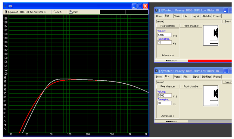

32 Hz Fb is pretty low for a Peavey Low Rider in that small of a box (it will have a very rolled off LF response), to get some kick out of it you should raise the tuning to around 38 Hz, if your box actually comes in at 32 Hz Fb, saw off a bit of the port shelf and test.

"Chest pounding bass" is generally 60-120 Hz, 32 Hz is more "pants leg flapping", a 38 Hz tuning in your box should give you a bit of both, but the low tuning you (may) have sacrifices both.

Polyfill definitely will reduce output in the sub range (30-120 Hz), and LTD02 is correct, in your undersized box, the difference between your actual tuning of 33.5 and 38 does not amount to much.

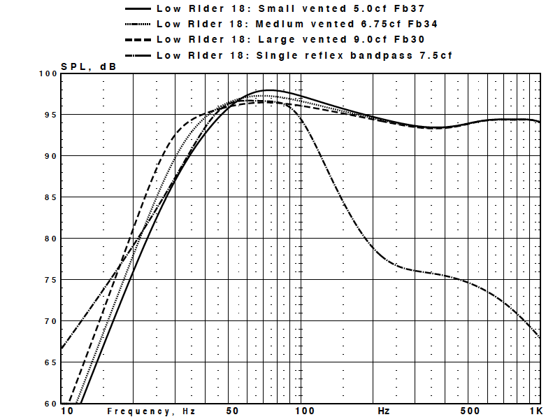

Attached LTD02's sims and Peavey's actual cabinet response curves for comparison.
If you want to get low bass in a 5 cube cab, a pair of speakers like the Lab 12 or TC Epic 12 will kill the Low rider. But you already have built a too small cabinet for your 18", so solly.
Turbodawg's bracing suggestions are valid, surprisingly bracing affects the upper "kick" sub range (around 80-160 Hz) more than the bottom octaves.
If you jam a divider (or two) in the port (use some paintable black caulk for sealant) it will help bracing and also make the port a bit more effective.
As somebody else mentioned, multiple ports also allow for "step down" (Electro-Voice term) operation by plugging a port the tuning goes down.
