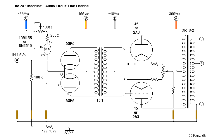

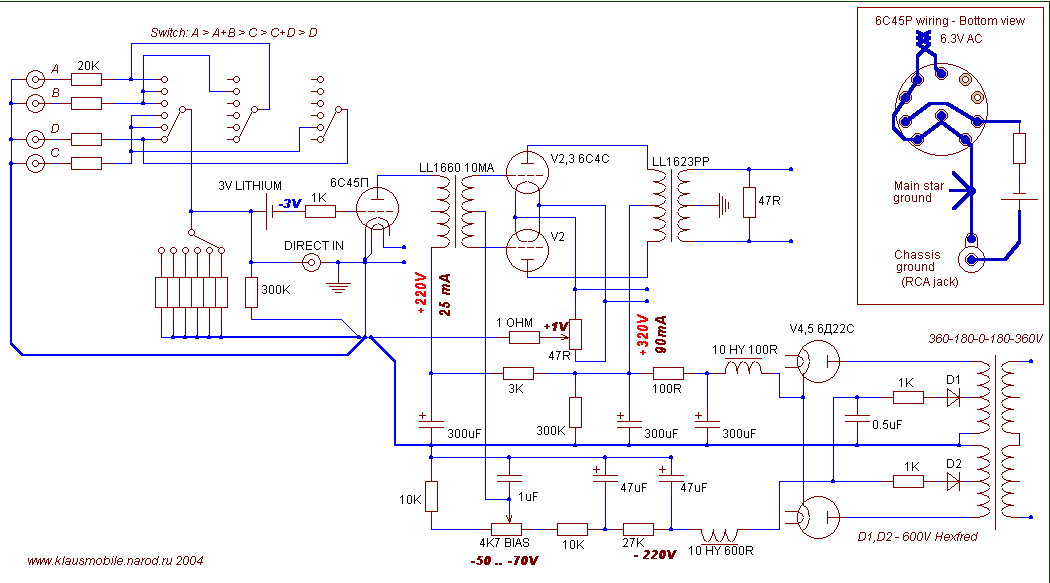

I can tell you about Danbury. I've used several of their DM53 PP OPTs, the ones sold extensively by Maplin. They sound very good. A fraction light in the bass, but excellent in the mid and treble. I enclose frequency response tests, and as you can see they are better than some vintage ones. I wouldn't hesitate to use them, and I've built some great soundiing amps with them. They're a real bargain.
But in a larger context, if your intention is to rebuild vintage amps to their original specifications - and that's fine in itself in a historical context - then you're taking a big dip in the quality of amp you could achieve with later and better sounding circuits. So the OPT may be one of the lesser factors in the overall sound. You'd get better results in sheer quality of listening with a Danbury transformer and a better amp - like a 2a3 PP type amp, for which you could use the excellent Russian 6C4C tubes. Put the money into a good interstage transformer instead and use a diff pair with something like a single high-mu input tube with the usual suspects - D3A, 6GK5, 6C45 etc

Those graphs are really interesting. Thank you very much. How much feedback was applied when those results were plotted ? I am now happy to use Danbury output transformers. I take your point about limitations to do with dated circuit topology. I need about about 25W per channel with my current insensitive speakers so was thinking of building a pair of amplifiers based on the Lowther LL26 circuit. I don't want to build vintage amps per se it's just that the ones I've had I have liked so they are my yardstick. I know relatively little about modern valve circuits so wouldn't know where to start.
Jolly
