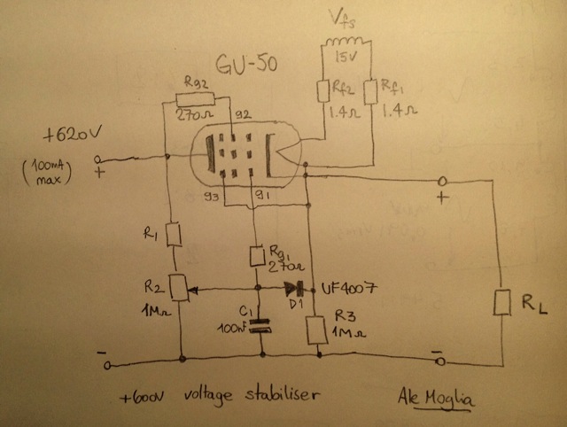

600V bench variable supply to test transmitting valves
Tired of my HT (+600V) variable bench power supply to suffer collateral damage when accidentally shorted whilst testing transmitting valves for output stage (i.e. FQP3n80c MOSFET passive regulator blowing out), I decided to make a simple but effective valve stabiliser. As nothing comes for free, here are my design constrain factors:
1. Input raw supply is +620V @ 100mA
2. Filament secondary winding is 15V @1.5A
3. No additional secondary winding is available for a floating screen supply (e.g. pass valve is pentode)
4. Output voltage ideally should be 0-600V
So with the restriction of not using a pentode as pass valve, I looked out for candidates to match my requirements and instantly thought about GU-50 in triode-strapped mode. Yes, I know that UG2 limit is 250V, not 1,000V as anode max voltage. But, in triode strapped specs are not shown.
I recently checked this with the 814 triode strapped, and seems to be ok UG2=Ua in triode mode. 7N7 also said this was ok and Morgan Jones previously tested this as well with similar valves.
So, question here is: can the GU-50 withstand 600V in triode mode or do I need to look out for options?
What about adding a zener string across G2 and cathode with a resistor between G2 and anode? Not ideal, but perhaps I can get a compromise solution that will allow me to get 0-600V swing here.
Thoughts?

I would recommend using an actual error amplifier rather than just a cathode follower for the supply. Unless the 620 V is regulated, you won't have much ripple rejection and the output voltage of your circuit will vary depending on the incoming line voltage.
Obviously, this doesn't answer your question, but I thought I'd point it out.
~Tom
Hey Tom,
Thanks, yes I know the rejection of this stage is worse than a simple RC stage as Merlin Blencowe clearly pointed out in his book.
Raw supply is well regulated. I'm trying to reuse what I have here, otherwise I should be looking for a bigger chassis and a different power transformer. I know that the floating screen supply is the best choice in this topology, but that will require an additional transformer and I don;t have the space to fit it in here...
What about an LND150 cascoded CCS feeding a zener string to ensure G2 stays below 250V? This should only kick in when output voltage is below 350V..
I may need to build this and try out whether the sturdy GU-50 have the stones to survive the 600V in triode mode!

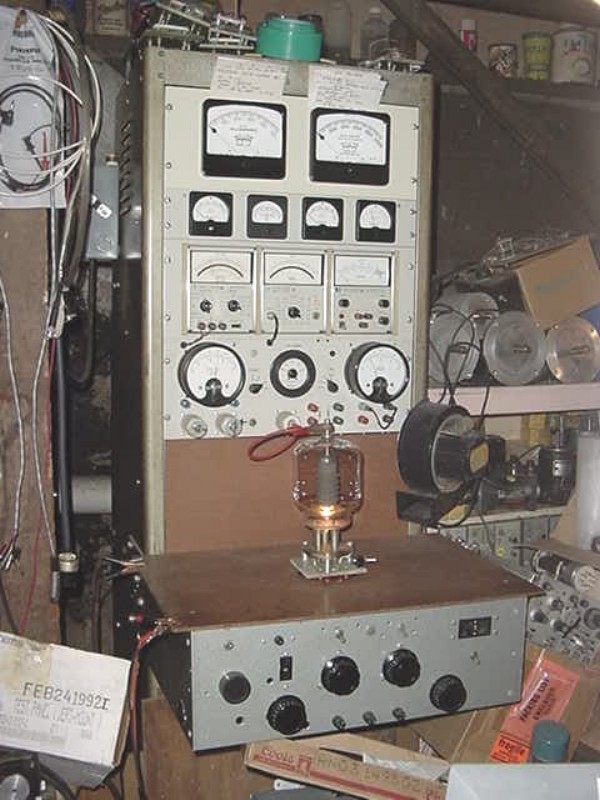

Why go through the frustration of using a regulated HV supply only to have it damaged by a gassy, arcing or shorted tube? I have been testing high power tubes for many years and learned that regulation just isn't needed. The plate supply in the rig pictured below is a very simple LC combination plus a bleeder. Nothing is regulated, but everything is metered. This setup is good for 1500 watts input class A, the limit of my mains. A 1KHz 1v sine wave is amplified for Gm measurment.
In order to have a tube regulated supply supply adjustable between 0 to 600 volts, you will need a variac in the primary of the plate transformer to limit voltage drop and dissapation across the pass tube(s). Usually this is about 150 to 200 volts. The small voltage adjust pot can be mechanically coupled to the variac to rotate with it. This is the way Kepco, Lambda, HP and others did it.

Very interesting and wasn't aware of this!
Not sure if I understood your suggestion. From what I read, you are suggesting a variac in the primary, classic LC filtering stage in secondary and the voltage setting pot mechanically coupled with the variac?
Ale
Thats how I do it. Have a 1250V PSU connected to a high power variac, so I get from 0 to 1250V 500mA, easy and rugged.

Thanks all for suggestions. As Victor pointed out, I've tried sand there and without a more elaborated circuit, there is no chance it will survive. Also, don't have the time (and patience) now to build many versions of Mosfets regulators and refine the circuit until it can survive a short at these voltage levels.
@Anatoliy: I tested 814 in this mode and survived operating in triode mode above max g2 voltage stated for tetrode mode. I was suspecting that the sturdy GU-50 should be able to cope with this, so great news!
A Variac will probably be the best option here. In the meantime, without adding any additional transformers I can get away with it with the GU-50 in triode mode. I may get an output swing between 85V and 510V @75mA to stay within the GU-50 Pd limits (i.e. 40W in continuous operation). I have everything to fit the valve here in and with a bunch of additional passive components I have this bench supply up and running. Yes, it won't go down 85V, but generally most of the tests I do in the bench are above 100V. It won't allow me to bring any circuit slowly from 0V, I know.
I will need to fit an additional transformer and rectifier to provide a negative 100V. In this case I will be able to provide 0 to 530V easily. I don't think I can use the filament winding for this supply as it has to be referenced to cathode.
