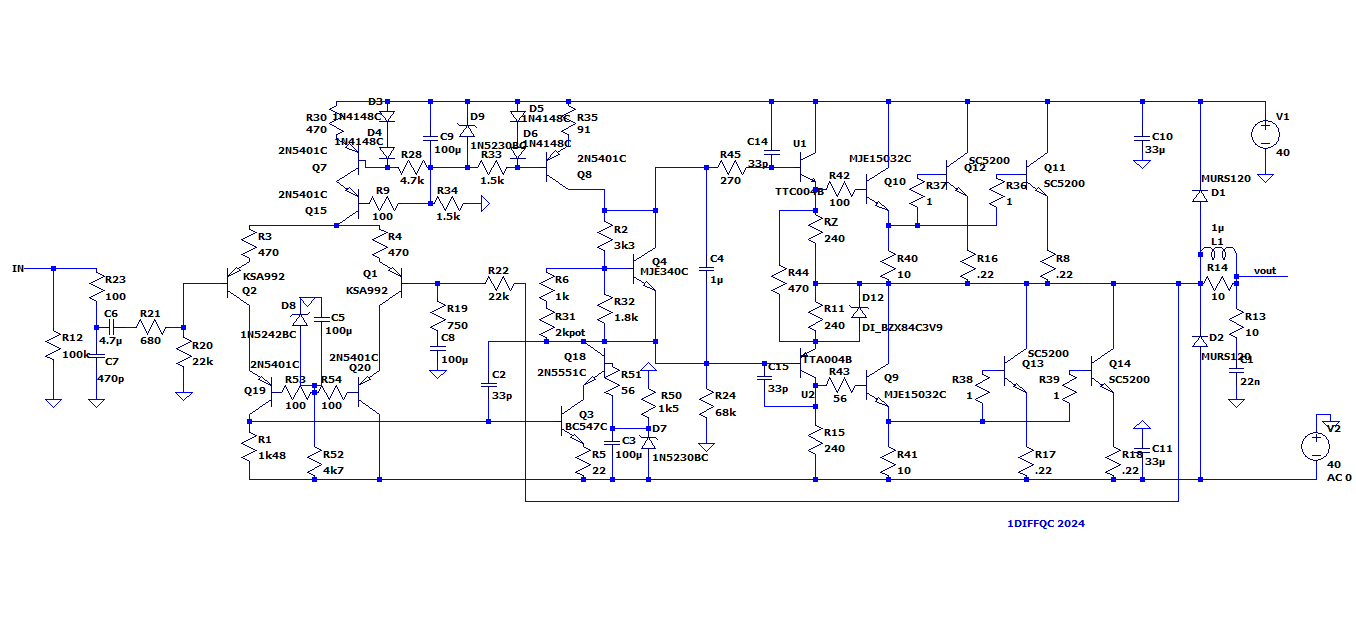

Integrated Darlington packages are only ever used when cost overrides performance and reliability - so only for budget amps like guitar amps and cheapo stereos.
Use a discrete Darlington circuit and cross-connect the bases of the output BJTs with a single R for faster response. Yes, it is five parts instead of two but it is more reliable and performs better. The bias reg should be affixed to the drivers on their own little heatsink. Only the outputs should be on the main heat sink, otherwise you run into problems similar to having the integrated Darlingtons.
For outputs use TO-3P or TO-247 devices. For drivers use TO-220 types.

Thank you for the input Struth. This research amplifier will most likely allow us to explore more about our perceptions about darlingtons, PSRR, quasi complementary, T.H.D. and a few other parameters.

The Bom has been updated to reflect the alternative output transistors

Okay Harrison,
Is the reason that these people want to use a different device because of noise differences or is there just some preferences for one output device over another? I haven't compared the BOM to the original yet to see what changes you have posted. Is it only the output devices or are there also other changes to optimize these output transistors? I am building the amplifier with standoffs so I could potentially change the output devices without have to De-solder the devices. I will watch and see what is going on closely.

Hello Everybody,, A quick update 1-on the first channel that I builded I used TIP142 transistors I enjoyed the sound very much my supply was at 37-+ volts. Then I try Changing my outputs and I used another suppy 45-+ The outputs are now MJH6284
Now this amp has come alive The bass takes you to the center of the earth and the highs put you on cloud 9. You,ll end up listening to your whole collection of music again.
