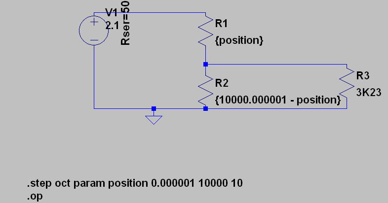

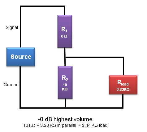

Figure01 shows how a potentionmeter is wired to make a passive preamplifier. The ground is the outside of the RCA interconnect cable and is usually connected to one of the outside pins on the potentiometer. The inside conductor in the RCA interconnect cable is the signal and is usaully connected to the other outside pin of the potentiometer. The signal for the amplfier is usually taken from the middle pin of the potentiometer. This is the wiper part of the potentiometer and its position determines the values of R1 and R2 in Figure01. The formula on Figure01 is used to calculate the output voltage from the potentiometer. This formula is used to calculate the volume curves seen in the figures of graphs seen later. Figure08 is a LTSpice file showing the simulated circuit. R1 and R2 are represented here as variables with a step to simulate the rotation of the potentiometer. Simulate the circuit using a 300K RLoad and you see that the VOut becomes very linear.

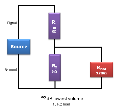

Figure03 shows that the maximum impedance seen by the source (the load imposed by the potentiometer and amplifier) is the impedance of the 10000 Ohm potentiometer. This occurs at the lowest volume setting -infinite dB.
Figure02 shows that the minimum impedance seen the by source is the impedance of the potentiometer and the amplifier in parallel which is calculated 1 / (1/Resistance of potentiometer+ 1/Impedance of amp) = 3230 Ohms. This occurs at the highest volume setting -0 dB. This is a rather heavy load for your source to deal with.

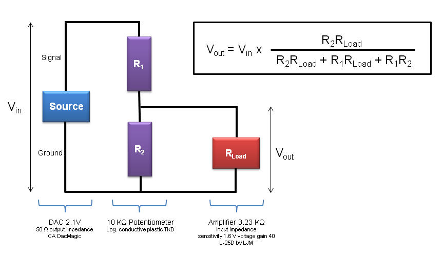

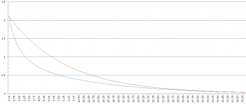

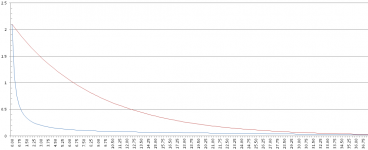

Figure04 shows my system, details of which can be gleaned from this text or seen in Figure01. The output Voltage of the potentiometer is on the left and the -decibels(attenuation) on the bottom. The red line represents the ideal curve and the blue line is the actual curve.

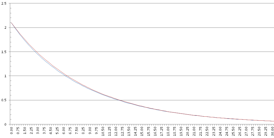

Let's try a 100 KOhm potentiometer instead in Figure05. That is just terrible, all the power is in the last hour as I mentioned above.

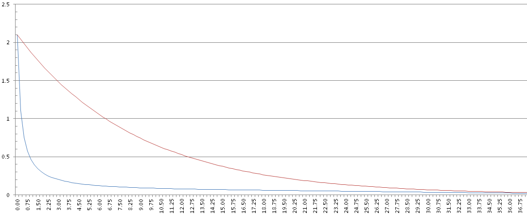

Let's leave my potentiometer as it is and increase the input impedance of my amplifier from 3.23 KOhms to 100 KOhms in Figure06. Much better, but I don't feel like buying another amplifier with higher input impedance and I cannot modify my amplfier to have a higher input impedance.
Let's leave the amplifier as it is and change the potentiometer to 1 KOhm in Figure07. That looks much better than my 10 KOhm potentiometer, but now I am possibly stressing my source with 764 Ohm load at maximum volume(formula is above) Most sources will have given up at this stage and be on their knees begging for mercy.
For my system a 5 KOhm potentiometer would have been better, but the 10 KOhm is quite acceptable. A 50K potentiometer or heaven forbid a 100 KOhm potentiometer would be no fun at all with the capacitance problem and the last hour of power problem explained above. With a input sensitivity of 1.6 V and a maximum power of 350 watts @40hms, a source with 2.1 V and 200 Watt 4 Ohm speakers - my maximum power is achieved @ 0.7 Volts which is at the -4.5db mark. The perfect result here would have been -9dB.

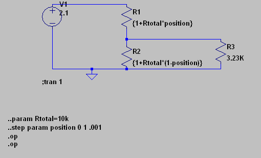

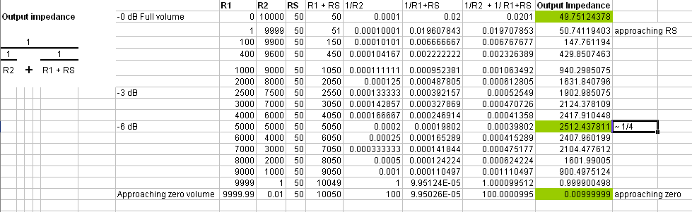

Ok guys, thanks for your efforts. Been doing some reading: Impedance bridging - Wikipedia, the free encyclopedia and Playing in excel and with simulations in LTSpice. Hey I can hear a a penny dropping slowly.
I will fix up the rest of the text tomorrow. @Davey you are right, it did get a bit long - someone said once if you want to truly understand something, then write a book about it.

You need to alter your excel model if you want it to more closely predict what really happens.
eg. add in the effect of the load impedance.
say your load impedance is 1M0 // 47k, then at the -6dB position shown in the model, the actual lower leg resistance is 1M0//47k//5k = 4k499
The attenuation becomes
20*[log{4499/(4499+5000+50}] ~-6.54dB
As you move the pot around the rotation the load has a greater or lesser effect.
As you change the load it has a greater or lesser effect.
The effect is quite small as long as the load impedance >> source impedance.
In this example we are looking at Rs (of the pot) <=2k5125 and Rload = 44k89 The Rload:Rsource ratio is >17.87:1
Getting very close to the 20:1 that you will see I recommend fairly regularly.
BTW.
change the lower leg resistance from 5000r to 5025r leaving the upper leg @ 10000-5025 and you will find that the maximum Rs does come out at the predicted (back of a fag packet) result of [Rs+Rpot]/4 = 2k5125
That would be the true half voltage output rotation of the pot, when the load effect is ignored.
Another lesson from the model.
note how small the pot lower leg resistance needs to be to approach zero voltage at the output. Most pots cannot get this low. Quite often the minimum volume is of the order of -70dB to -90dB. Few pots can better -100dB, very few. And even with audio taper, just the tiniest rotation gives a big jump of the order of 10dB to 20dB increase in output.
